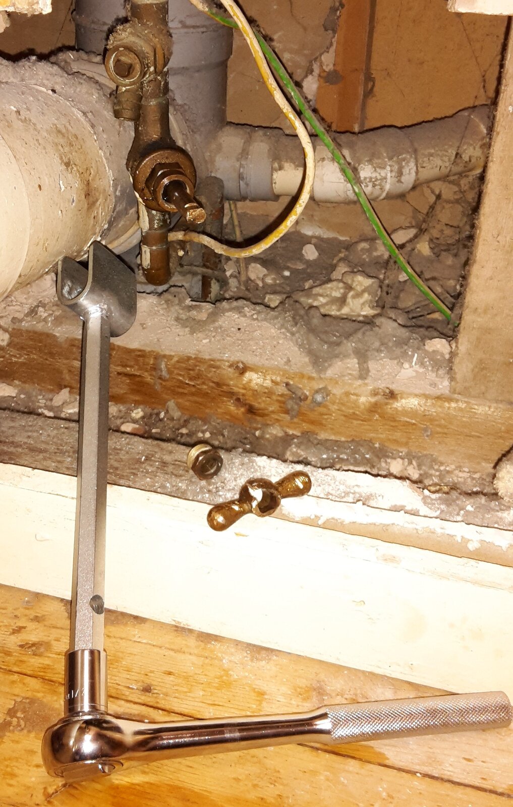

Not urgent in any way but cannot unseize this stop tap.
I loosened the packing box and sprayed WD 40. Heated it up with a heat gun and sprayed some more. Repeated a number of times but can't get it to turn at all.
Any tips please?

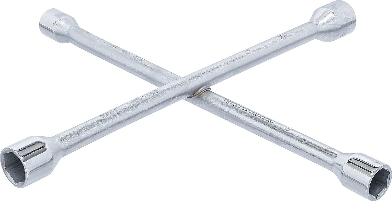

Was thinking of buying a cheap car wheel wrench, cutting a slot in the end to get a purchase on the tap and trying to turn it through that good, balanced leverage.
Good call.
Off to Toolstation first thing in the morning it is then.
Torque is what can shear a seized bolt where an impact driver would free it. I would rather hit one end of that good, balanced leverage, with a two pound hammer. :D

...I'll do a bit more heating, spraying and cooling throughout today attempting to turn it with this which I'm off to get in a minute - Mini crutch key
along with a can of Plus Gas from Eurocarparts (Only £5.99)
So, after multiple heating, spraying with PlusGas and cooling cycles I've so far only managed to break off the handle.
I suppose I'll keep going with the heat, spray, cooling cycle and try to turn with stilsons...or give up and get a pro in.
If the tap itself is seized and wont budge then you may need to crack the headgear off it and see if you can free up the internals, on the bench ...
provided you can isolate the supply upstream, that's what I'd do
your existing valve does not look very old, if you unscrew the innards you can probably buy a new tap and swap the working parts into the new shell. Taking the new one apart will teach you how it works and comes apart.
