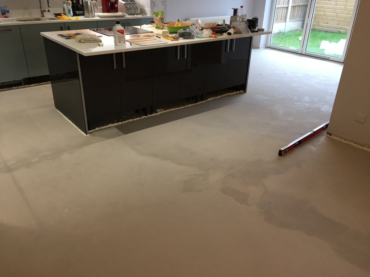

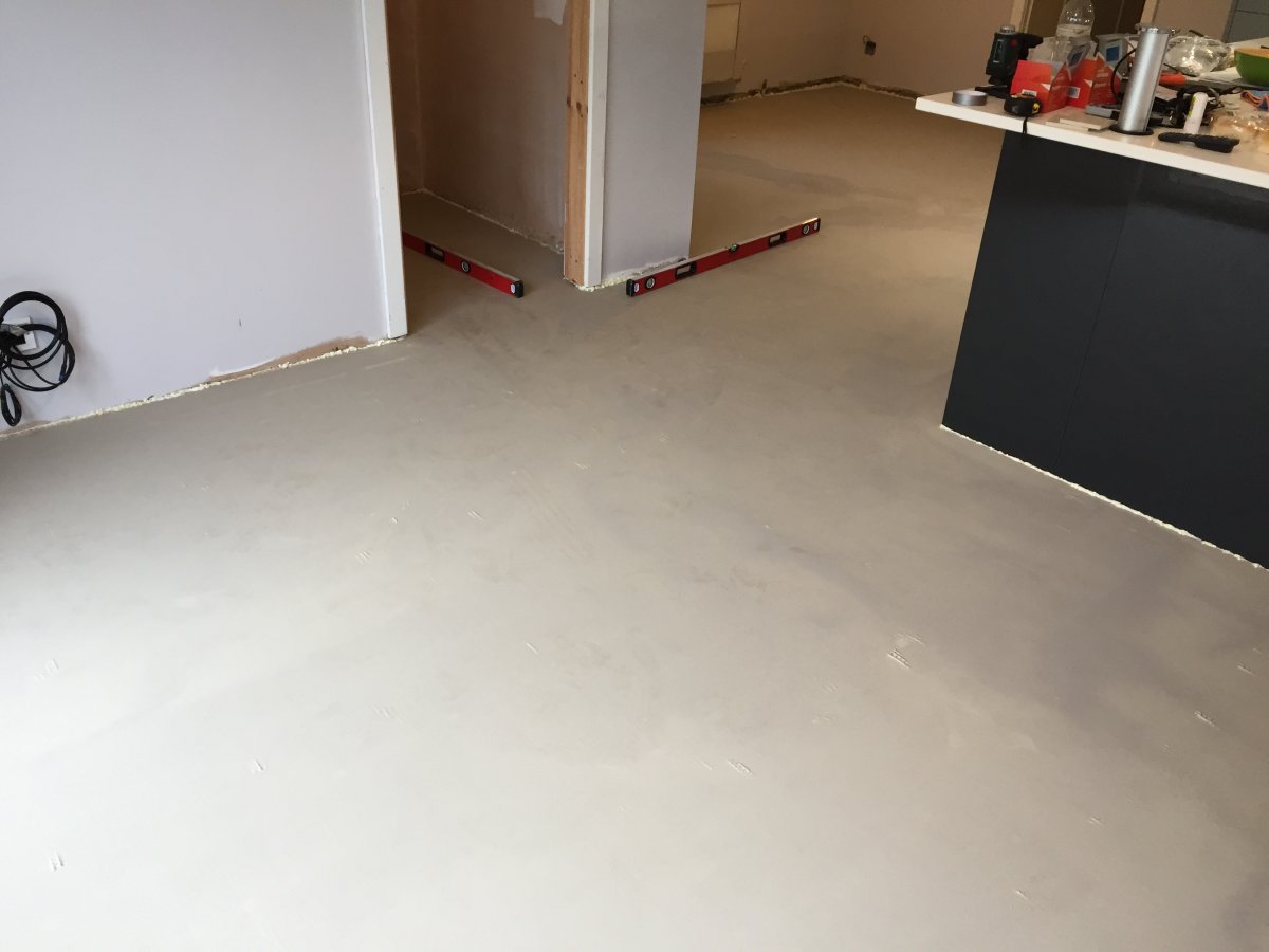

Finally got round to doing the SLC this morning.
20 bags of Level it 2 mixed n laid covering 36m2.
Definitely 4 person job! 2 mixing, 1 pouring n levelling, 1 cleaning buckets.
Worked a treat though.

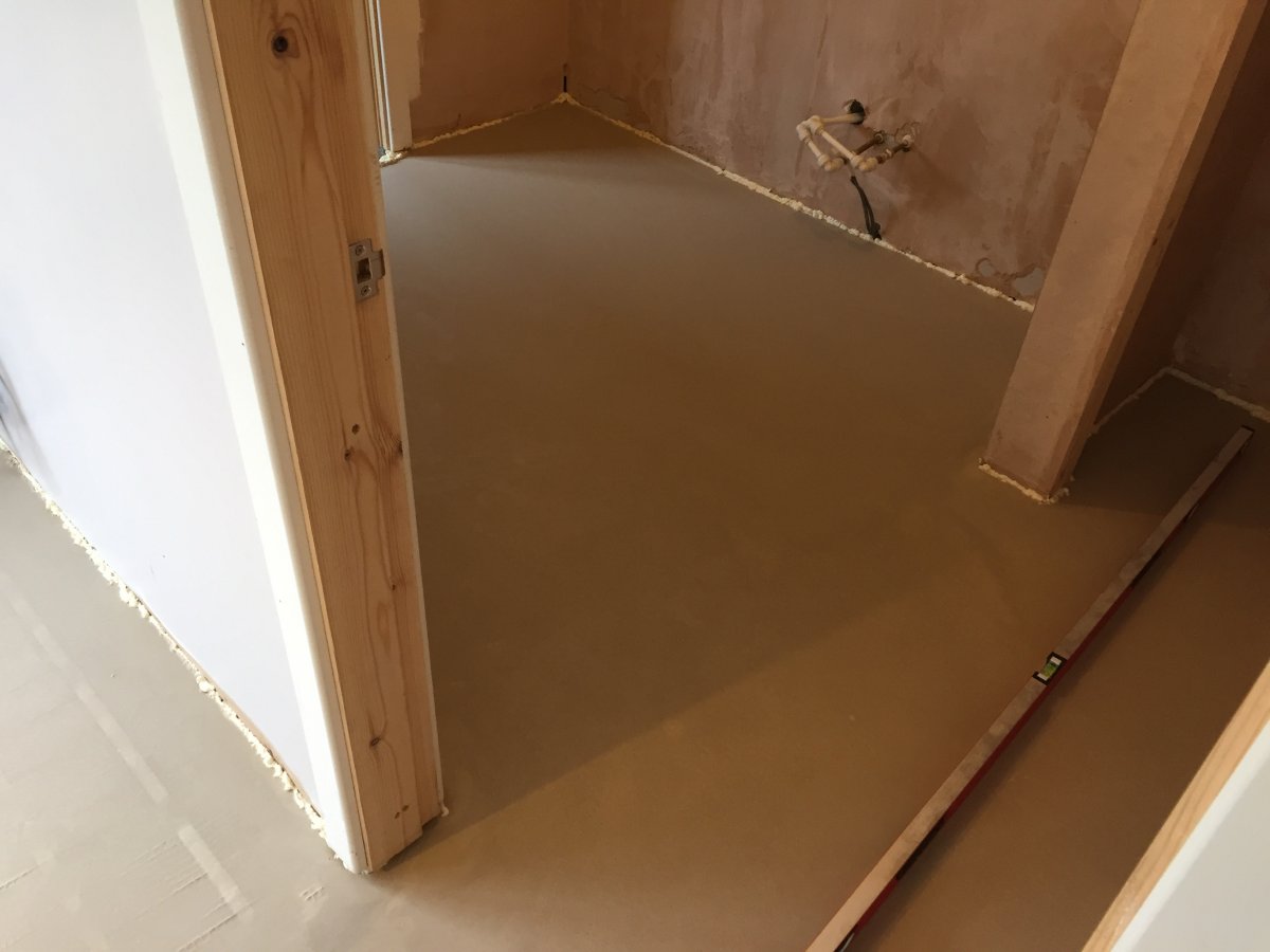

A few areas where the matting is showing through but that will be fine for tiling.
Certainly glad I did it. Just wish I'd have used some to level the subfloor to start with coz it would've made putting the boards down so much easier!
Thanks again for all your advice guys!
