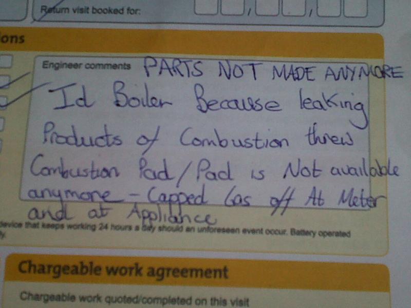

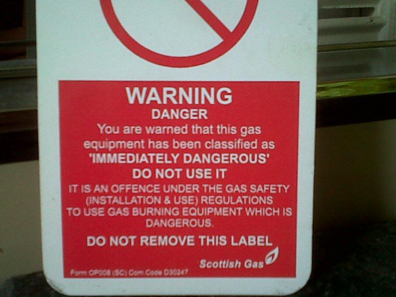

I just bought a flat a few weeks ago. As advised I got a plumber in to check the central heating. In the list of things I got back he found:
1. Cold Water Storage Tank is corroded and needs to be replaced.
2. A Gas leak was found at the Cooker - The Appliance had to be disconnected.
3. The Central Heating System works, but there is a Gasket missing on the Flue Connection between the Fire and Back Boiler. The Boiler is in excess of 30 years of age and no Spares are available.
So I emailed the solicitor under advice from the plumber that the seller is liable for making the system safe and in working order.
WHEN were those labels issued?

If the inspecting engineer had been asked to try to repair the boiler then he would have checked the part was unavailable from the makers.
Then he would have made an assessment of the viability of using generic seals. That creates a problem. There is a general understanding that with a safety critical component only the manufacturer's original part should be used.
Some will use a generic part but doing that creates a responsibility should their judgement be wrong and its very understandable that many dont want to take the risk.
Then there is the age of the boiler to be taken into account. Its a very good argument that there comes a time with very old appliances when its not a sensible option to keep them running by using a non approved part.
Tony
