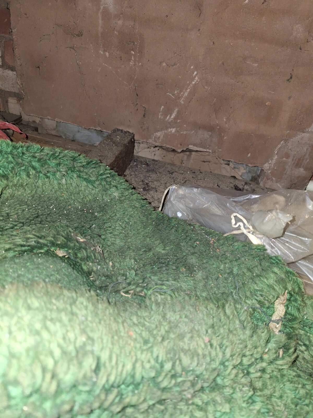

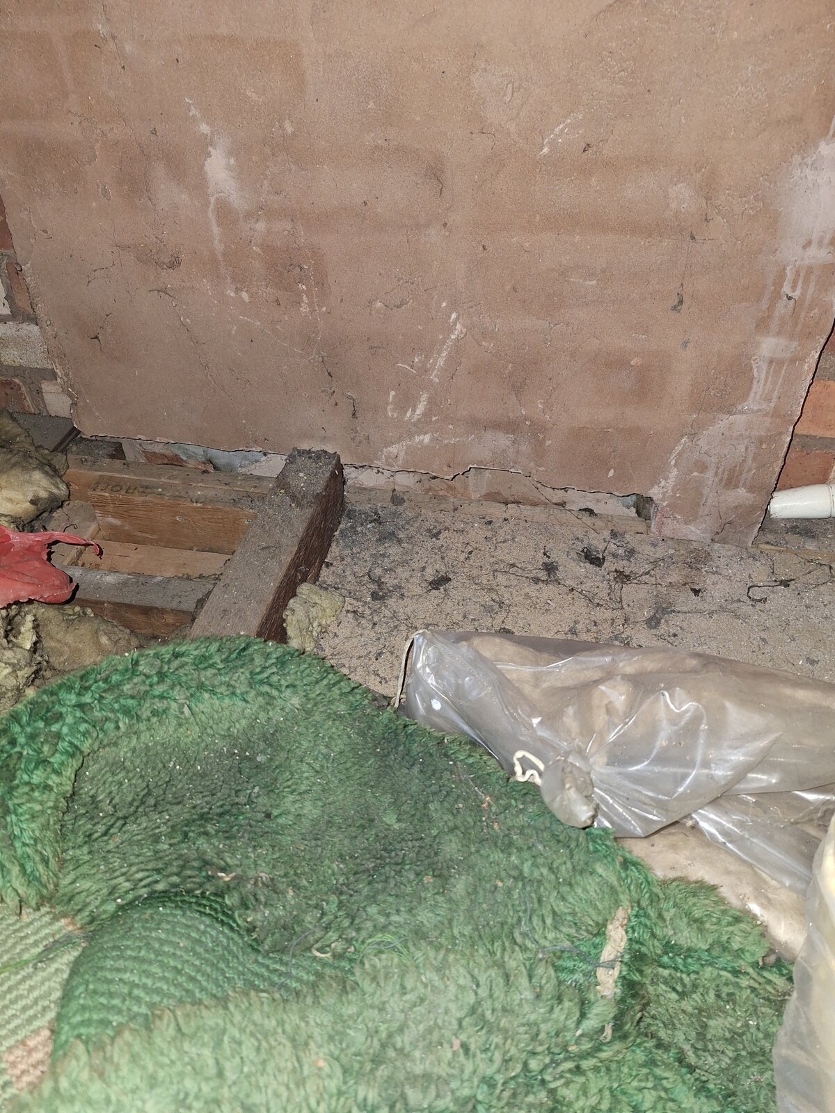

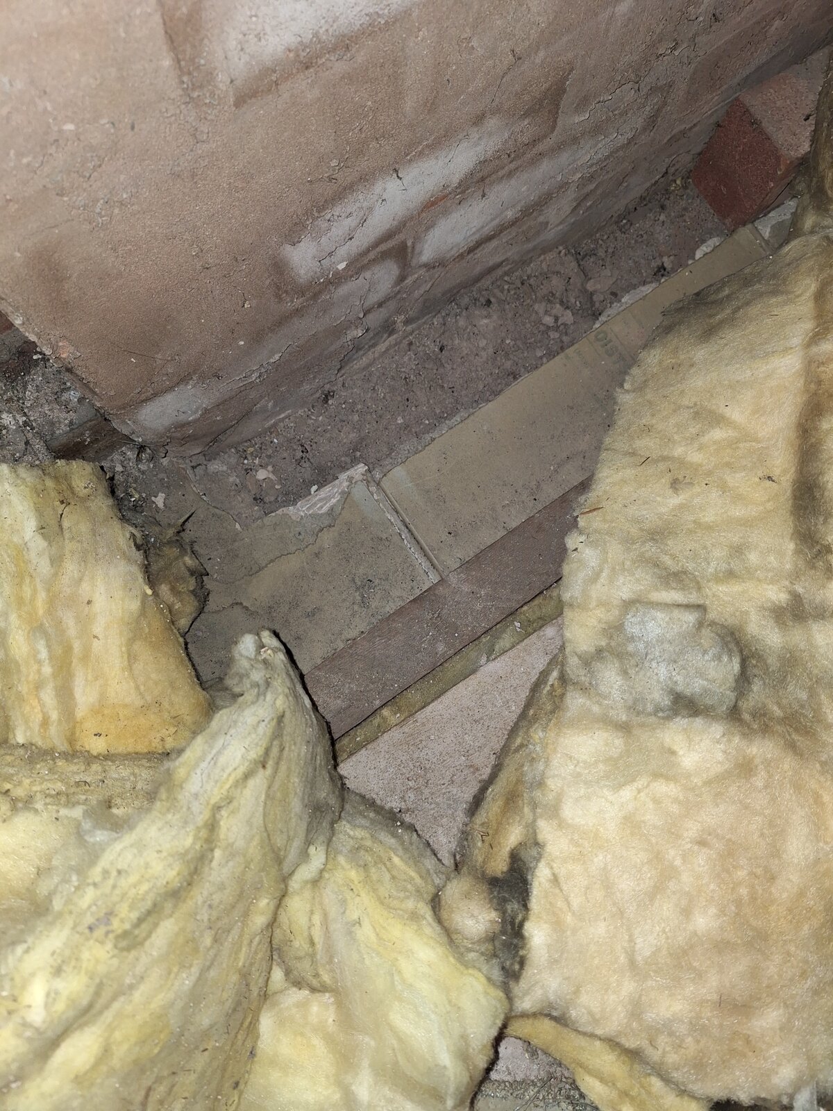

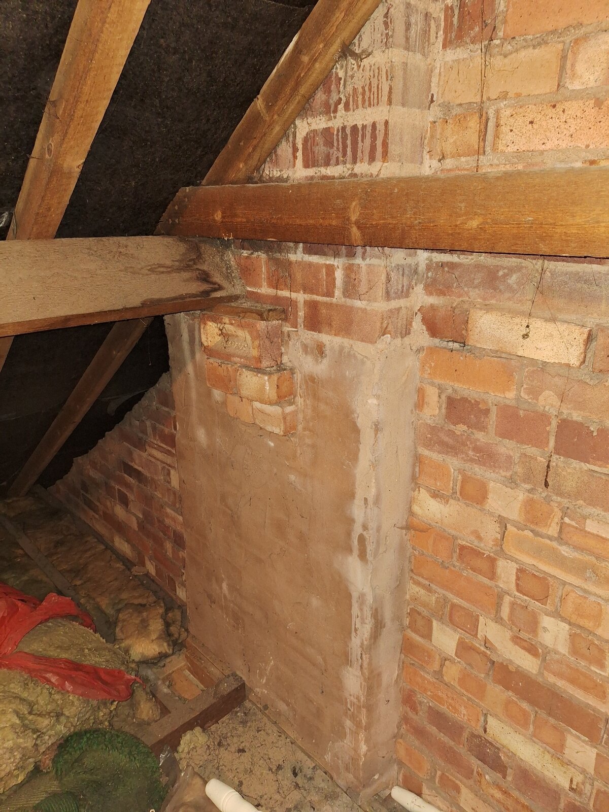

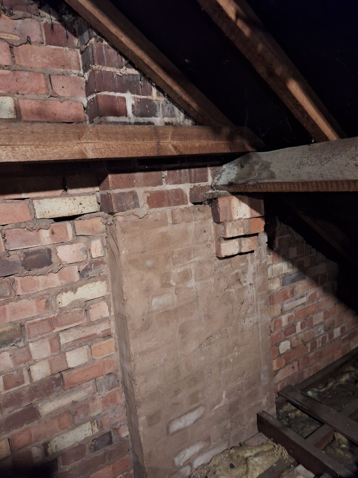

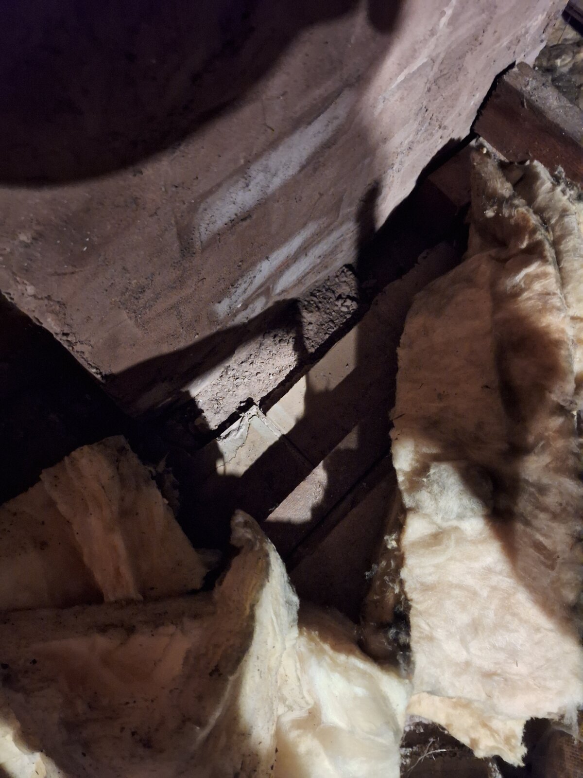

Hi I'm new and found you searching the web for my problem.
I'm in process of selling my house and near completion, the buyers have had a survey completed, it has thrown up an issue with my chimney breast.
When I moved into the property 20 years ago the chimney breasts had already been removed from both reception rooms and 1 bedroom. 1 bedroom still has the wall sticking out with breast behind. Downstairs rooms are flat walls end to end.
They are now asking for building regs but I did not have them and probably the seller then didn't need them back then.
Is there anything wrong with these photos of both breasts as i worried they might pull out of the sale.

Regularisation is possible but likely disturbing and certainly an expense, even if just to get Building Control out to inspect, perhaps more if the work does not meet approval (unless the works were done before 1985 in which case they cannot be regularised?). From what you've posted it's not overly clear exactly what's been done and where so difficult to answer from a building point of view.

Ask for a copy of the relevant part of the survey report, that may clarify the precise issue. Don't go the BC, because the buyers won't get indemnity insurance if BC are aware. Bear in mind the solicitors are almost certainly acting for the lenders so they have two parties to look after (as well as themselves). Play it on the basis its not been a problem since you moved in, and you didn't take the chimneys out
Blup
It's not a regulation issue, but one of risk.
The breast is not correct as its unsupported. Whether it was OK all this time is irrelevant, and if it will be OK in the future is unknown, and you'll be hard pressed to get any professional to state that it will.
The buyers surveyor is obligated to point this out to his client.
If you involve building control, they will want it supported.
If you are met with stubborn buyers, who won't accept indemnity, then your options are to either rectify the work - with building control or without if they will accept, or negotiate a price reduction to reflect the risk or the cost of the work. Or tell them to take it or leave it.
