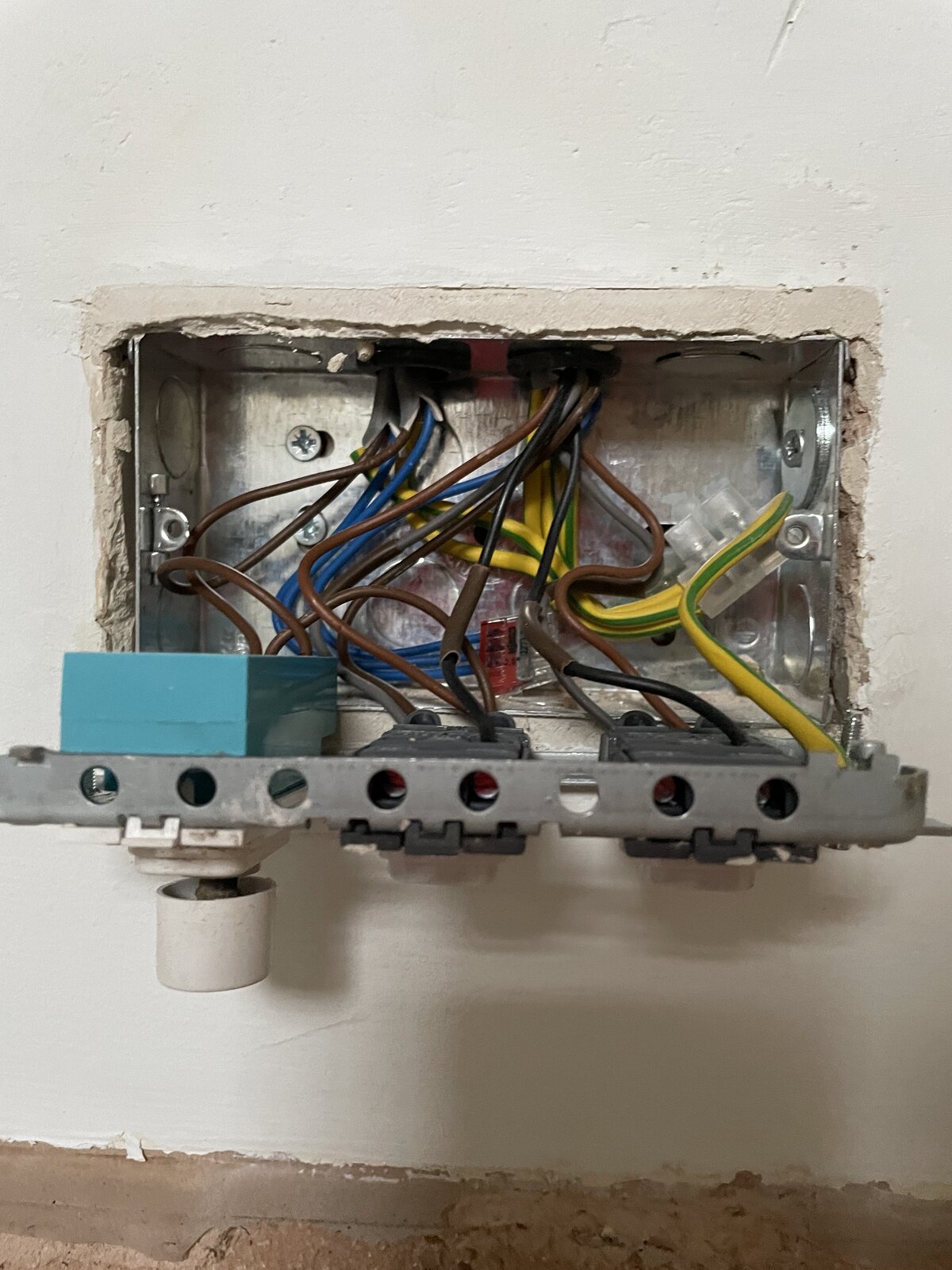

Hi all,
We had a rewire a year ago (long term renovation project) and now want to address a three gang light switch in our hallway which controls landing lights, porch lights and lounge lights. I can now relocate the lounge switch inside of the lounge, which would leave a two gang in the hall.
There are three cables going into the switch, but sure it’s not as easy as whipping one out and putting into a new switch, as all downstairs lighting is on one circuit and named as such on the circuit board. Our ceilings are currently down so have easy access to cables. What would I look for to figure out how our lights have been hooked up so I can hatch a plan?
Comfortable moving things around safely but want to ensure I don’t stop the kitchen and porch lights from switching on and have to put everything back
Thanks in advance - can share photos if you let me know what you need to see.
L
The fact you say it is all on one circuit is encouraging, so could be very easy.
Photos please.

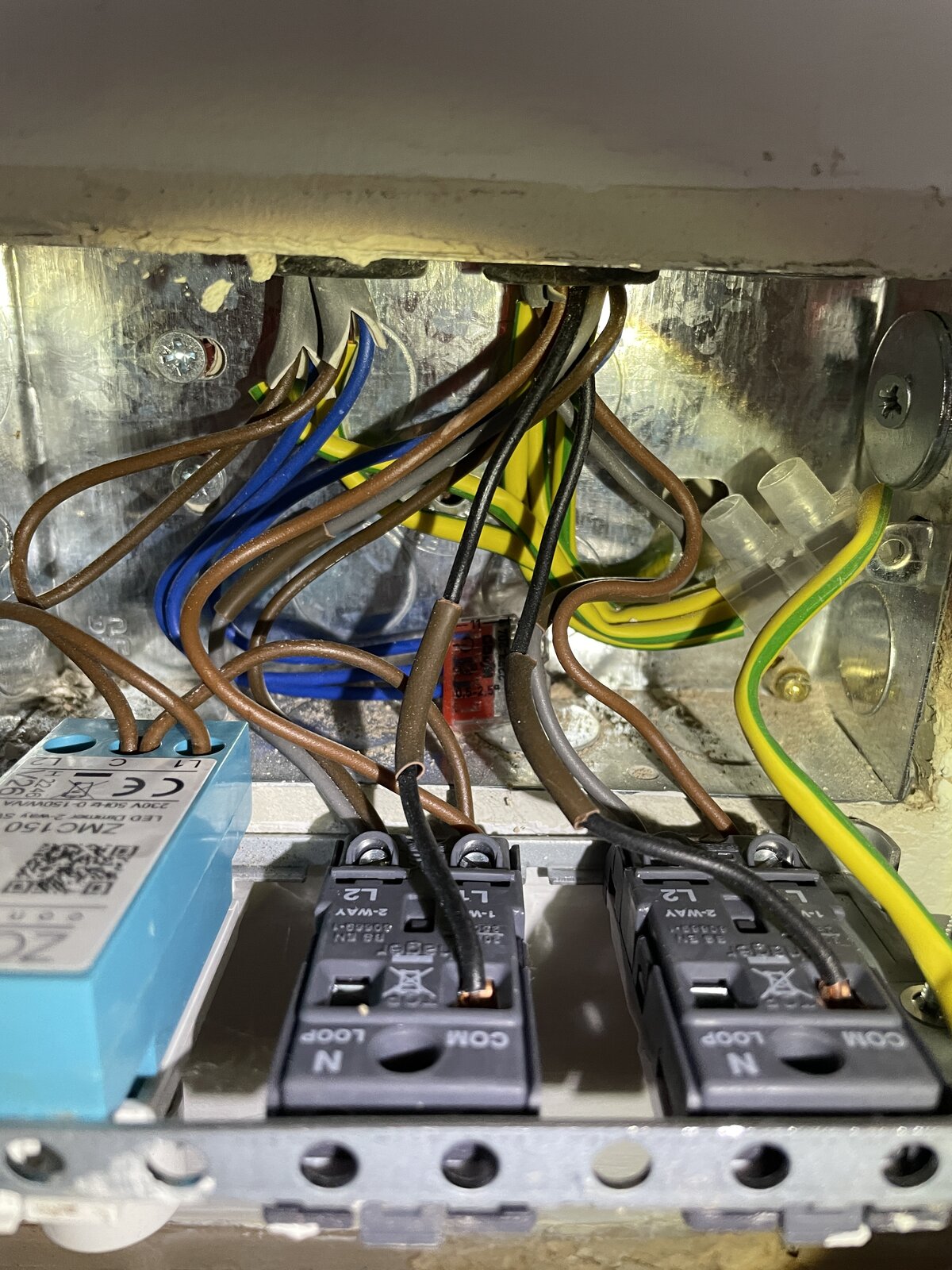

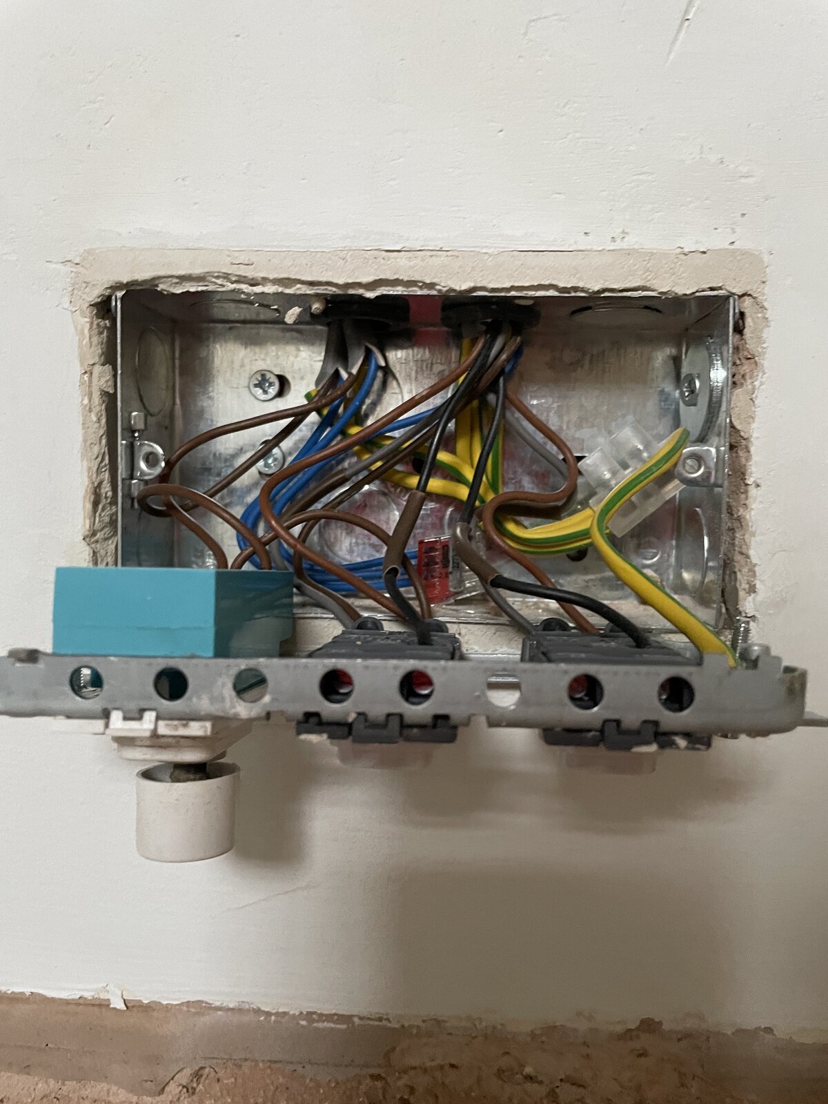

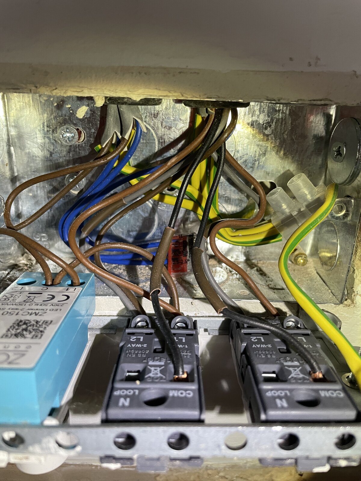

Thanks both, took the plate off but certainly more than the three cables I can see chased in from the top making it inside, I think 5 in total link up to the terminals. The dimmer is the lounge light I want to move, fyi.

Depending on the locations of the parts :
Quite simply, you have to take the wires that are connected to the dimmer and extend them to the new position.
The two brown wires together must be kept together (or rearranged satisfactorily) and although the single brown and its accompanying blue wire could be pulled up to the ceiling you would then need to find another supply neutral for the blue..

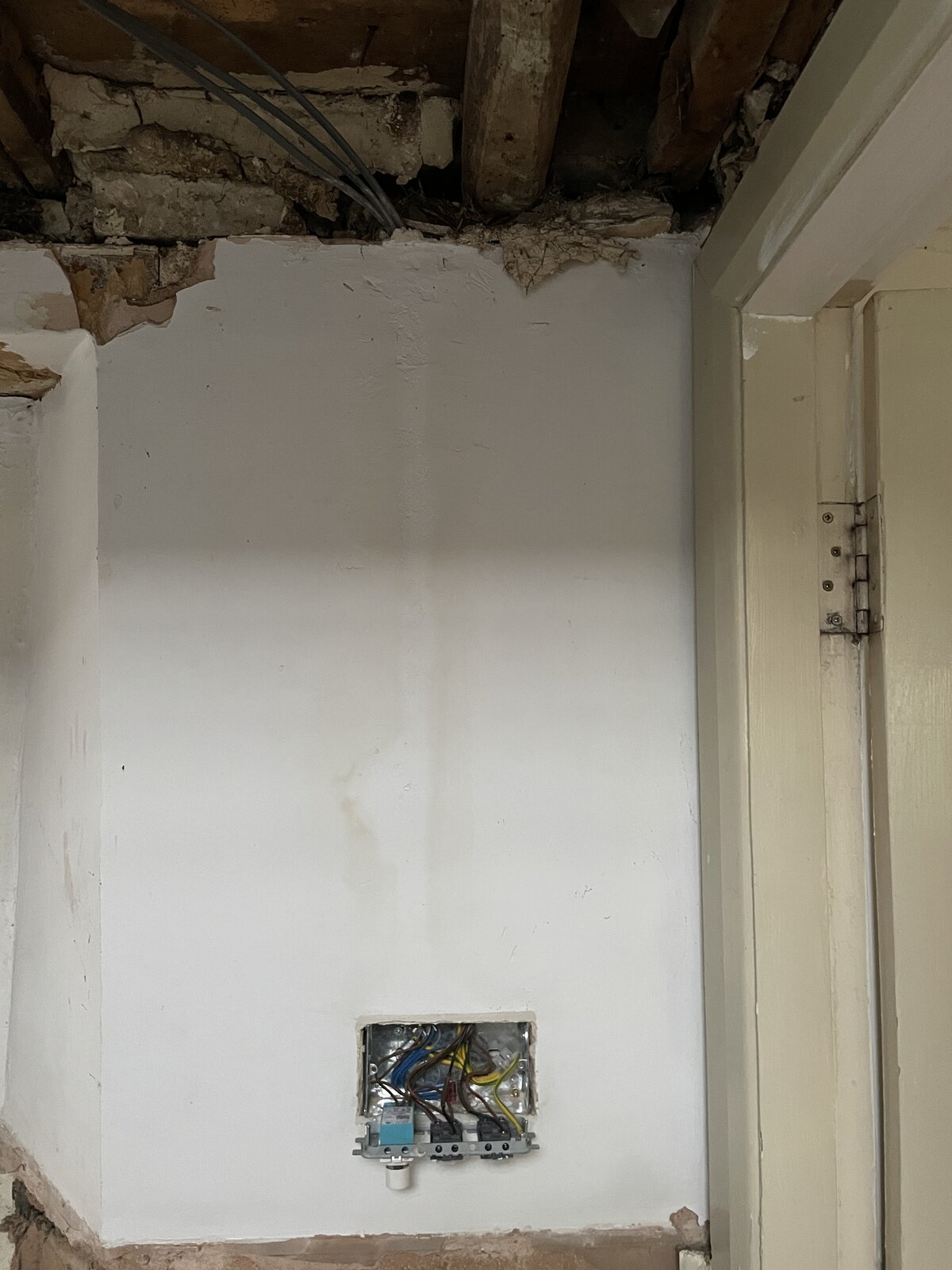

Is the ceiling down in the lounge too, what are the relative position of the accessories
