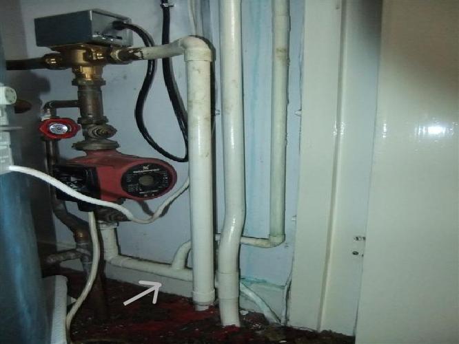

Can you post a pic showing the pump and the fitting on the side of the cylinder.
More is better so not too close up.

I needed to see where the cold feed and vent connect, in relation to the pump.

Still can't see where the pipes are connected, if you move some of the insulation in the loft so that the pipes are more visible it may help, also in the airing cupboard can you get pic of the pipe(s) at the front, on the right.
I agree with YB, re the blockage.
The pics of the pipes in the attic only show bits and pieces of pipe, unless we can see a whole pice of pipe and where it is connected we cant say what may be right or wrong. the lagging/insulation can be replaced if disturbed.
