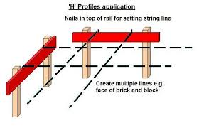

Knock a couple of pegs into the ground about a meter from your trench, fix a horizontal batten across them and string your line to it.
You can set these level (fiiddly) when pulling your lines, or have four different datum pegs hammered in close to the corners, for height setting. Set your corner block to the line and the height of it to the datum peg. Do all four block corners and set your line to the blocks.
Hey, good morning and thanks for the detailed diagram. It is very informative.
I see where setting out is the most important part of a job, get this correct and hopefully all should go well. I imagine it can be quite hard working around all those lines though.
