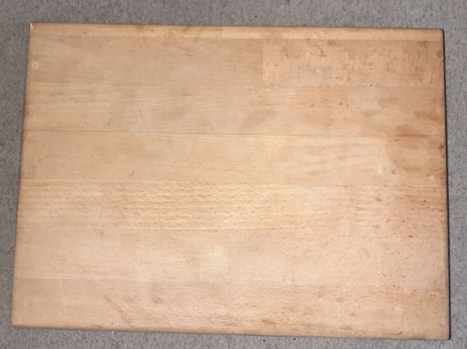

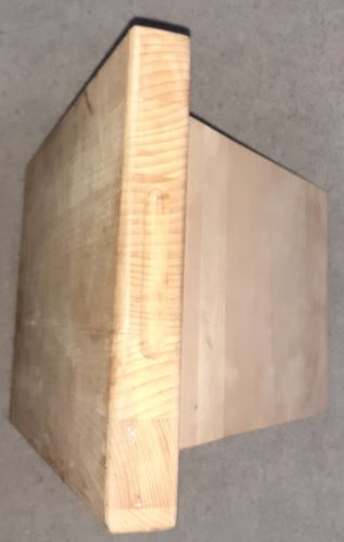

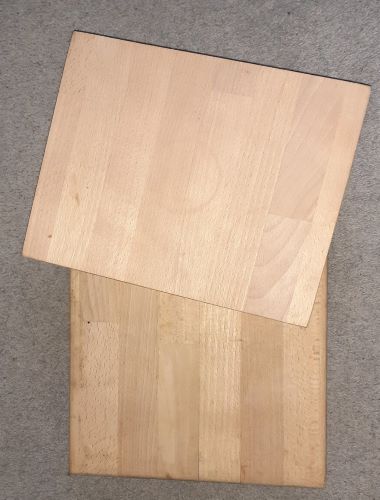

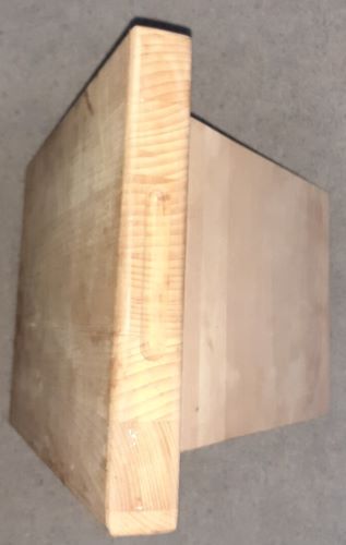

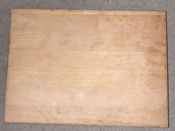

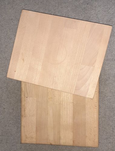

You need to be able to surface plane your timber (to get a reference surface) then thickness it, so you have a flat top and a flat bottom which are coplanar (I.e. the thickness is consistent). A basic planer/thicknesser like this Titan planer/thicknesser (at under £180) will do that (just remember a dust extractor will be useful in the future). You then need to be able to rip the material into strips - that's what a table saw does, but a bandsaw is another option - and cheaper. The ripped material needs to be edge planed then edge thicknessed (on the planer/thicknesser) to get consistently dimensioned pieces. The surface finish you get off a planer/thicknesser is streets ahead of what a table saw can ever produce - and you need a good quality surface finish. You then need to saw the strips into shorter pieces - for which a mitre saw is really needed.Finally you can assemble everything, glue it and clamp it - for which you'll need some sash cramps. When the glue has set the surfaces and edges will probably require minor adjustments because I guarantee that the surface won't be dead flat - in a craft environment that probably involves either hand planing. or belt sanding (surfaces) and hand planing the edge grain edges. At that point you can break the arrisses, rout-out any details like finger recesses. etc and lastly you need to sand everything and then finish it (probably with an oil finish). That's the process in a nutshell
To give you an idea, these two cutting boards were planed-up and assembled in my workshop from scrap offcuts of beech, about 25 or 30 years ago. The project was a trial to see if I could recycle some of the scrap offcuts I had from a regular contract job I did. They are a bit scruffy with the odd cup stain because they are straight out of my kitchen and they have had some use (the photos are of the "best" sides). Nothing fancy, just machine planed, glued, cramped then surface sanded (belt sander), edges radiused and finger recesses cut (a wee bit wobbly because they were freehanded). What you are talking about is similar, but with different timbers. Note how even after 25+ years at least my joints are still really tight
