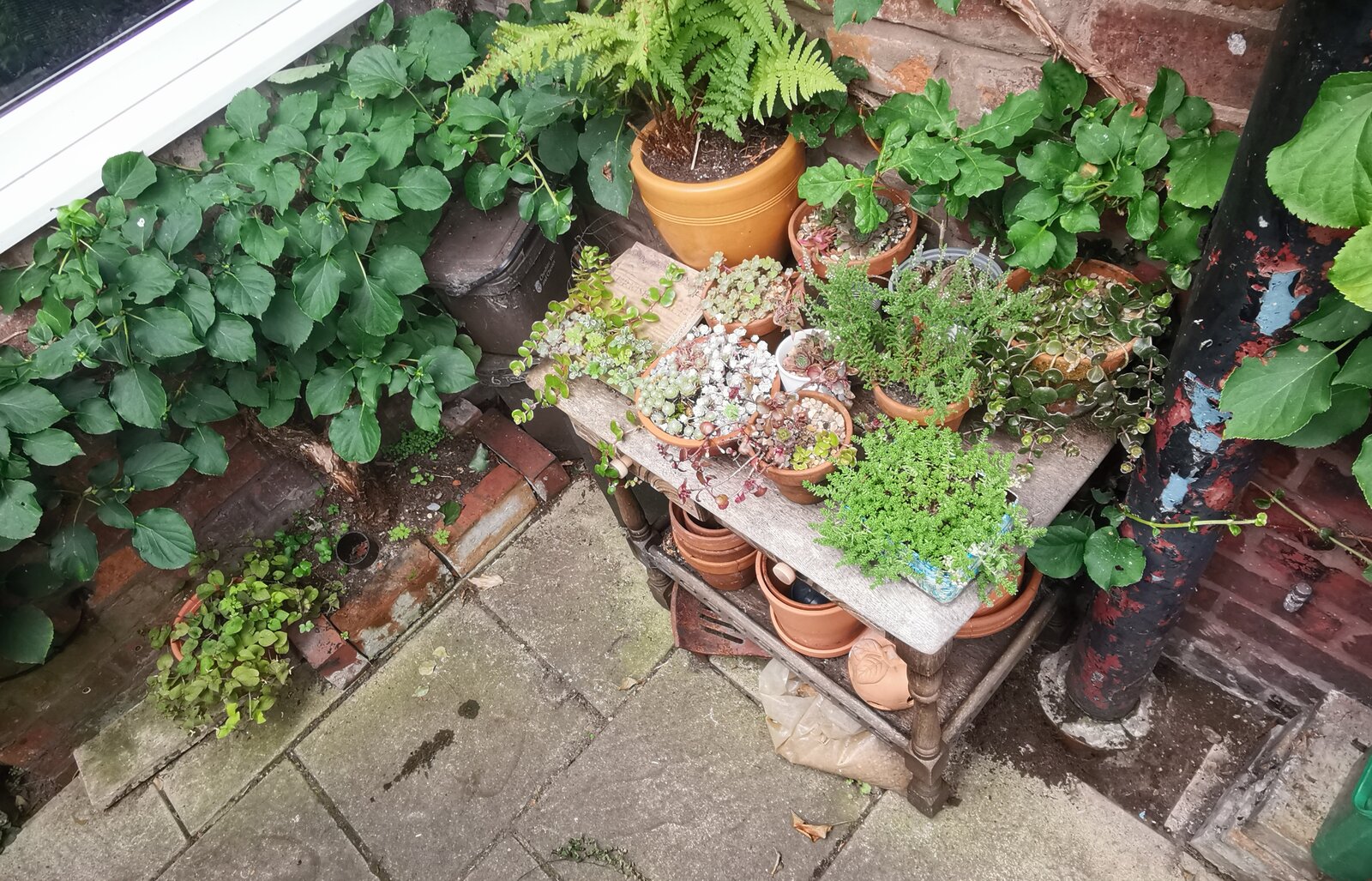

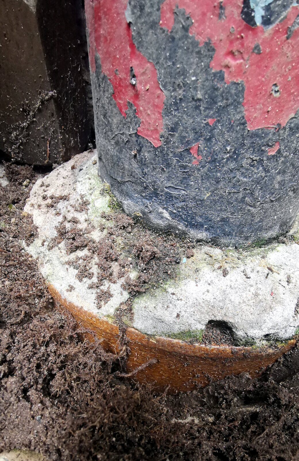

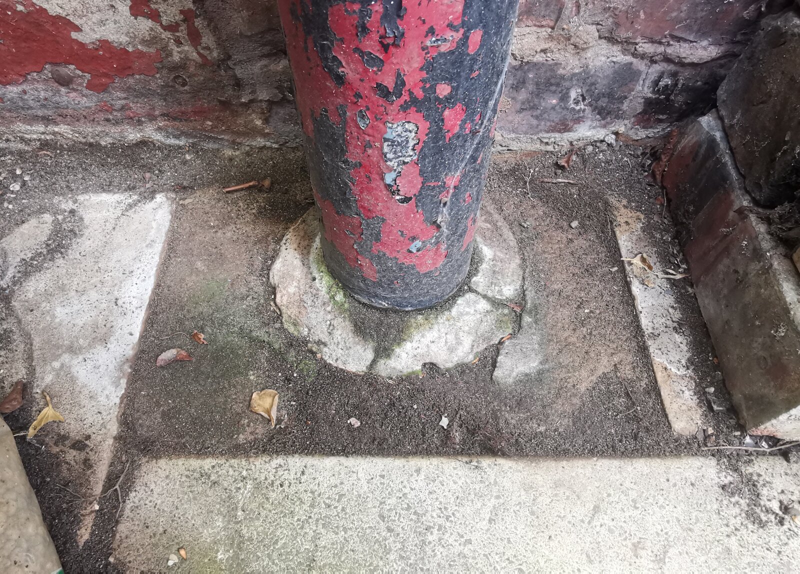

Ok, this is the soil pipe situation. Some of the mortar has gone with just soil. I have smelled it coming from here. Any advice on a mortar repair would be appreciated. The house was built 1883 and the pipe is aspestos .

I'm just hoping it's a case of new mortar and some chicken wire to make a frame.

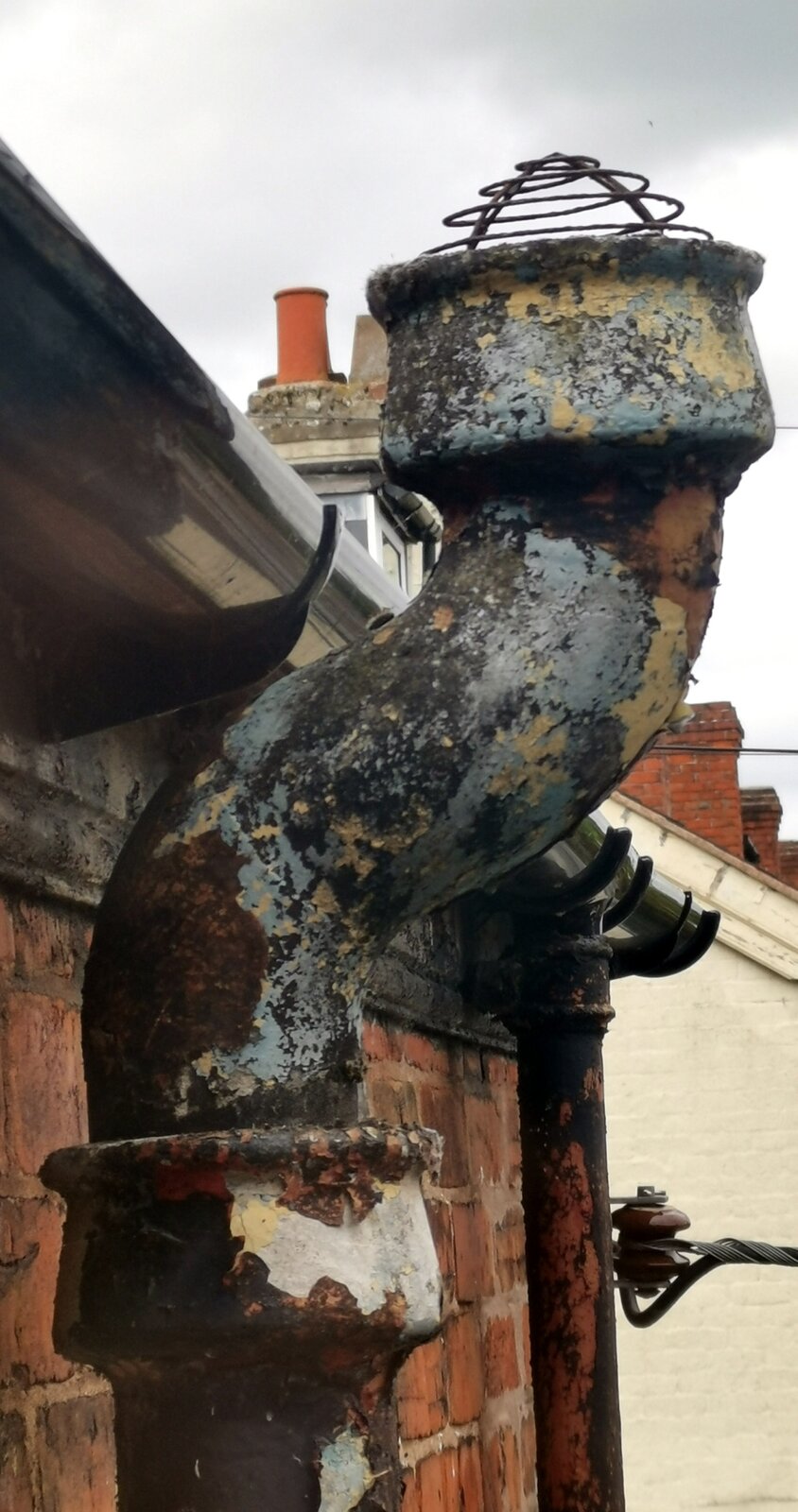

The gases should be escaping from the vent surely ?
Odours/gases will yes, but if sewage is leaking lower down, it may be this you can smell.

I'm not questioning as I haven't investigated further yet, I just asking about the vent. I'm just hoping it's a cracked mortar issue.
On closer inspection there is a hairline crack and a root going into it from the climbing Hydrangea. Here is also an image of the pipe in context to the surroundings. As you can see space is tight.
