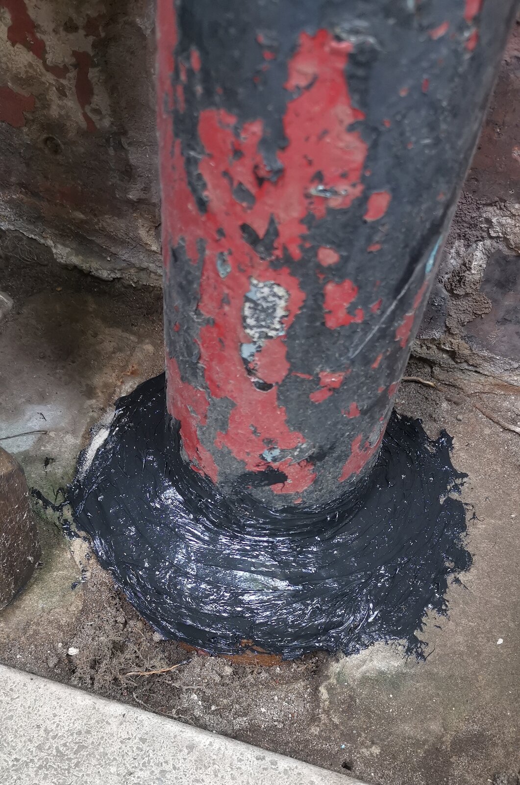

I'm not questioning as I haven't investigated further yet, I just asking about the vent. I'm just hoping it's a cracked mortar issue.
but....
The gases should be escaping from the vent surely ?
If you want to attempt to get to the bottom of the issue, you need to accept there will some effort involved. There is plenty of room, you may need to lift some of those paving slabs to do a full investigation, unfortunately you cant make an omelette without breaking eggs.
Alternatively, if there is access available to the drain taking the stack from a nearby Manhole, get someone with a CCTV camera to survey the pipework and report on tis condition.

I could check the kitchen sink trap but the smell def comes from outside in the drain area too when upstairs bathroom water drained.
Lift up the nearest manhole and start checking from there.

It's intermettent. Since my last post the smell stopped. I thought great, it must have been temporary. And now it's back since the weather has hot ted up. Doesn't make sense. Still haven't got round to lifting the drain cover as so many other jobs.
I have sealed it with CT1 Adhesive & Sealant and yet the smell still emanates from it :(

Ok, after almost 10 months I just smelt it again coming from the drain. Why oh why would this happen again after such a long gap ? :cautious:
I did that last time and it was clear. I'll try again tomorrow just incase. Our neighbours had a similar problem (not on our pipeline) as the sewerage was backing up into upstairs shower and yard. manhole was blocked and it turned out to be lumps of cement blocking the pipes.
