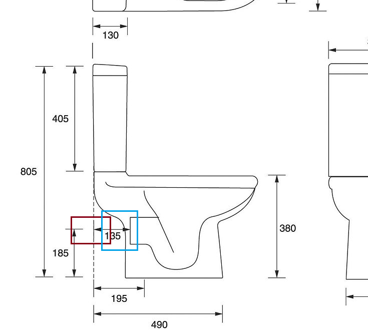

Oh, probably a daft question ... the soil pipe will go straight through the wall. This is the toilet I picked up today.
So, centre of pipe needs to be 18.5cm from floor level, but how far out should it stick?

I think this is the diagram (not from Screwfix website though)
source: https://everydiy.uk/p/screwfix.com/6779J/Ideal-Standard-Della-Close-Coupled-Toilet-Dual-Flush-6Ltr
It needs to stick out from the wall 23mm PLUS a suitable length for the connector to connect to.
It may be best to have about 130mm projecting out so you can cut it to the correct length when you 'dry fit' the pedestal.
Don't forget to take your floor finish into account when deciding on the height - more so if you're overboarding with ply or having tiles.

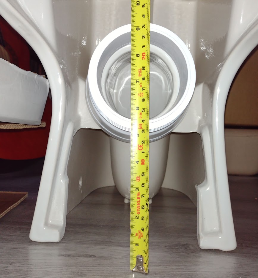

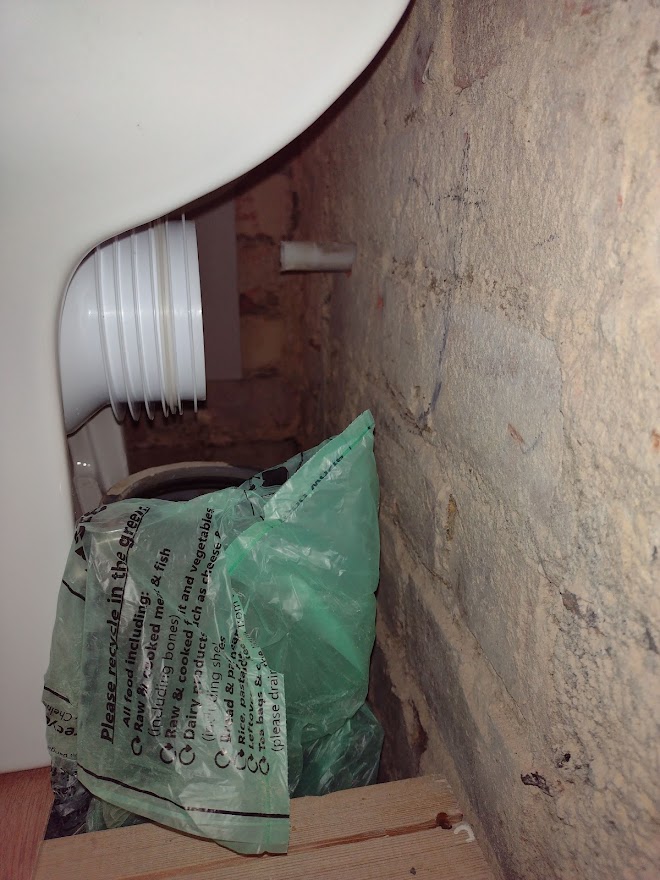

It's coming through the wall - my question was, how far out should the pipe stick from the wall? I have a 13cm pan connector and the toilet outlet is 13.5cm from the wall - so, how much of the toilet, and the pipe, goes into the pan connector? Does the toilet almost meet the pipe, with half the connector in the pipe, and almost half over the toilet outlet?
On my loo, the pipe is near flush to the wall and a flexible pan connector links to the loo.
In your case, surely the flexible connector deals with any mismatch is levels? Obviously is there is a mismatch, the exist from the loo should to be higher, so stuff flows down

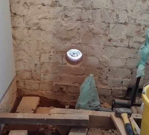

Right, done a small pilot hole in what I think is the correct place ....
Hole is 13.5cm above the level, which is 4.5cm above the top of plyboard, making 18cm total. There is some wiggle room with the connector as far as I can tell.
(just an approx position / sanity check)

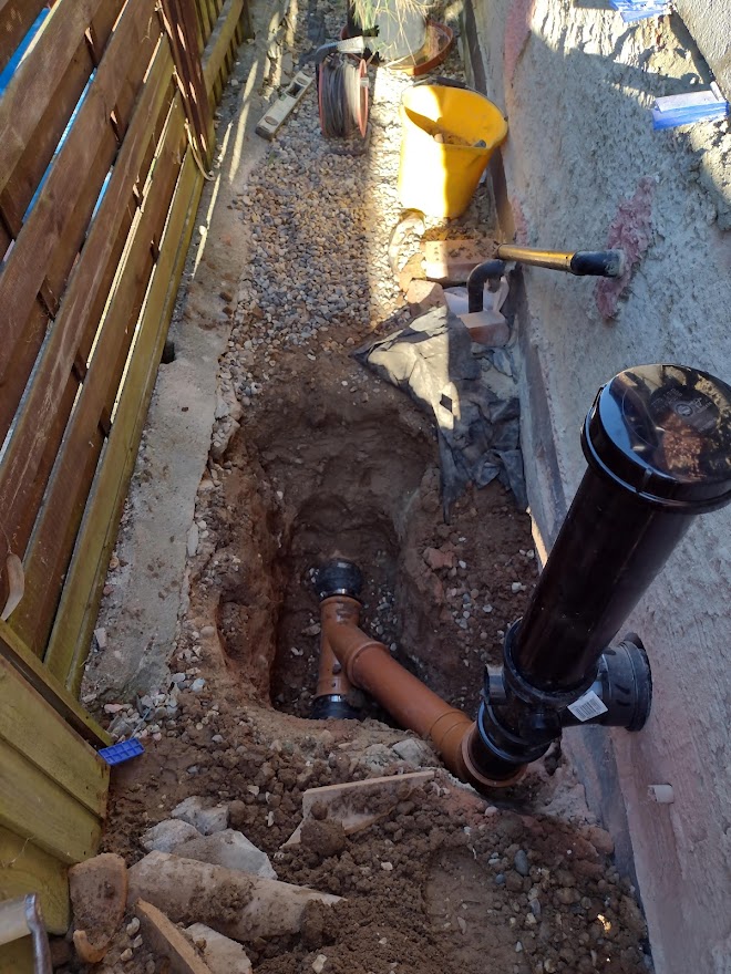

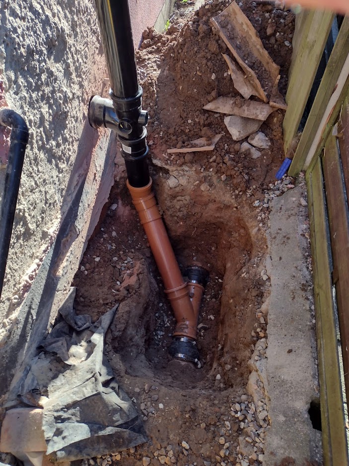

Sorted. With vent / rodding access.
I'm saying nothing, other than "rest bend" and "how far away from the wall is that stack!"
But I'm no expert, see what building control say when they come to inspect it.
