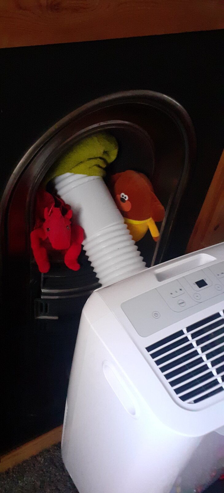

Ok - it’s chuffing hot.
I have an air conditioner with hose, and can back it onto what was a recessed front door porch alcove.
does that make sense?
my front door is a couple of feet recessed, maybe three. This means that the wall to my left as I walk into my front room would technically lead to outside if a porch had not been added.
I have access to a mid sized sds drill but would need to hire a core drill.
assuming standard brick, would a “normal” SdS (Makita) core drill a 100-150 mm core?
I have plans to enable boxing in and plugging the core hole for winter.
the porch allows for insulated ducting etc.
