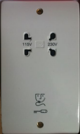

I'm looking to for a shaver socket in the bathroom. It'll pretty much be exclusively for charging toothbrushes. I'm trying to get a handle on the current regs. Does it still need to be a standard transformer style shaver socket and are these OK for toothbrushes? I have read about some getting a bit warm. If its not necessary than I'd rather fit one without but will obviously comply if it is. Its going outside zone 2 ("zone 3"), but will be within 3m of a zone 1. Its going on lighting circuit which has a standard 30mA RCD if that makes any difference. If it does need a transformer are any better than others?
Yes, if it is within 3m horizontally of Zone 1. Always worth checking the Wiki first... ;)
Some are, some aren't.
They are all OK for toothbrushes. Some are not marked with a toothbrush symbol but that does not mean they can't be used. A toothbrush charger is such a low load the transformer won't overheat when used for a long time.
If your toothbrush is suitable for 100 to 240 volts (most are) use the 115 volt socket. This means don't buy the MK one (left hand picture) as the 115 volt socket won't take a UK shaver/toothbrush plug.
The reason for using the 115 volt socket is because these transformers have poor regulation and on low load such as chargers the the voltage rises to around 270v on the 230v output and 140v on the 115v output.
