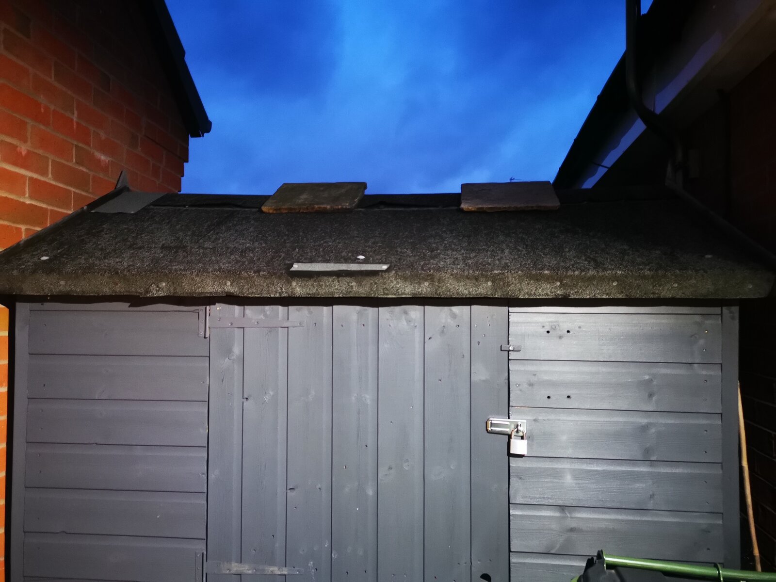

Thanks to this lovely weather I've got to re felt my shed tbh I've been patching it up for a while. I've no idea how I'm going to do it as I can't get the left fascia off as the previous owner has put it up against the wall.
Any advice on what felt I should get? I've had a quick look on screwfix, Toolstation etc what's the difference between the cheaper mineral stuff vs the premium and is it worth paying extra?
Shed currently has 2 paving stones on to hold the felt down let's hope there still there in the morning.

Is that flashing tape between the wall and the felt on the left hand side?
If you remove that you may find there is a slight gap between the roof and the brick wall. You may be able to drive a wedge between the wall and the apex of the shed to allow you to push the new felt down into the gap. Nail the felt as close to the edge as you can. Do both sides of the roof in the same way. Remove the wedge from the apex and drive it back in further down between the brickwork and the new felt on both sides so you can lay your top sheet of felt over the ridge in the same manner and nail as close to the edge as possible. Once the felt is all nailed down securely remove the wedges and replace the flashing tape.

Trouble is there isn't enough room down the left side I'm going to empty the shed and try and move it over slightly with my dad's help, if that doesn't work I'm stuck.
If we can move the shed I might turn it round it'll make future repairs alot easier.
You won't turn around in that space between both houses. You will need to bring it forward into a wider open area.
Doable if you have the manpower and can get around the back to push it, preferably onto something flat like some sheets of plywood or a level patio surface rather than on to grass. Obviously you need to remove everything from inside as even when empty they can weigh quite a bit.

Managed to move it forward enough for us to get a ladder either side. Thought about turning it sideways but I don't fancy having to move the arbour as well so it's staying where it is.
Anyway we got the roof off and then it tipped it down so it's covered up atm hoping it's not raining tomorrow.

Managed to get the new felt on today just got to put the fascia back on 2mos hoping it stays dry as I'm going to paint the back of the shed now I can get to it.
One question we've used 2 pieces of felt the first piece at the back and it went 1/4 to the front part of the roof, we then did the front with the 2nd part and used adhesive on the top 1/4 way down on the back all the videos I've seen they've used a 3rd piece over the middle my dad says it isn't necessary as the 2 pieces are covering all the roof. Is it worth adding the 3rd piece?
Normally crowned with the third piece , a couple of lengths of Tile Battening from top to bottom either side helps to ensure that high winds do not rip the felt off
