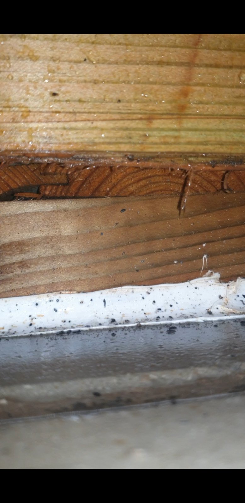

Hi guys, had a bit of a hold up while I was getting the garden sorted. A few things have changed in the meantime.

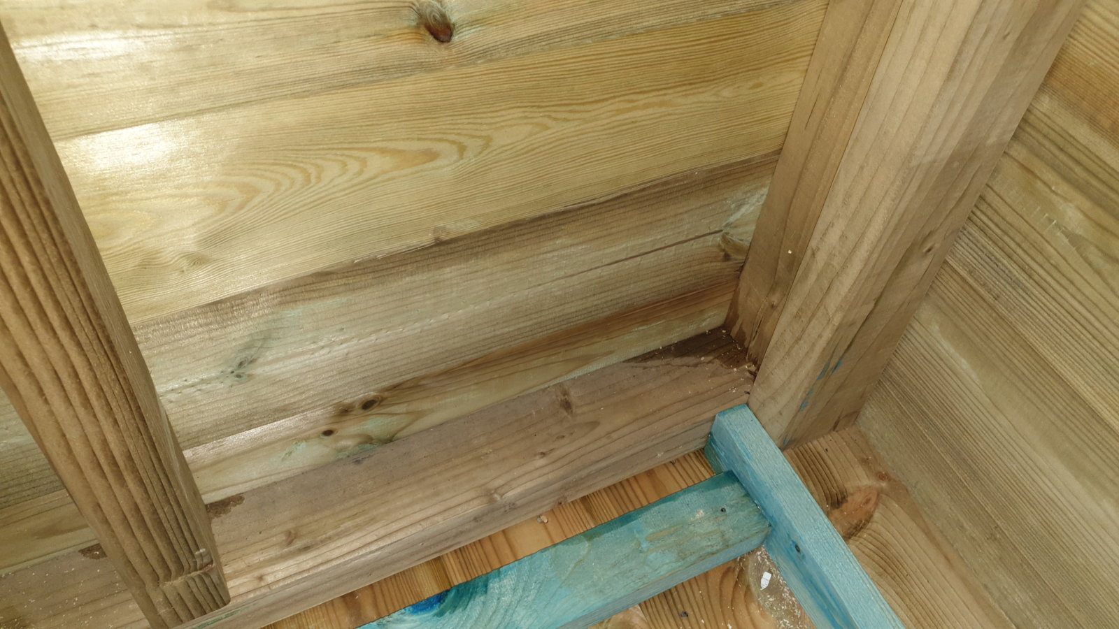

The shed is now 18' x 8' and it is built and in place. The first night it rained, water seeped up inside the shed between the tongue & groove and 3x2 timber in a few places.
Now I think the reason this happened is that the water was dripping from the roof and bouncing straight up back into the shed. So I have now fitted guttering. It rained last night but the guttering seemed to do the job as it was dry this morning.
This leads to my question. As this is an area where rain could potentially get in again if the rain is very heavy and on a certain angle. Is there a filler of some kind I can use on the outside underneath to seal the join where the T+G meets the 3x2 timbre? A waterproof silicone that sticks to wood would be ideal but impractical as you can't see what you're doing under there and very little space. Filler would be easy to use but I imagine it will crack and fall out or is there a type of filler or other material ideal for this situation?
Any advice greatly appreciated as I want to crack on with insulation but need to be sure I've got this sorted first. Heres a pic to show where water seeped in. Cheers.

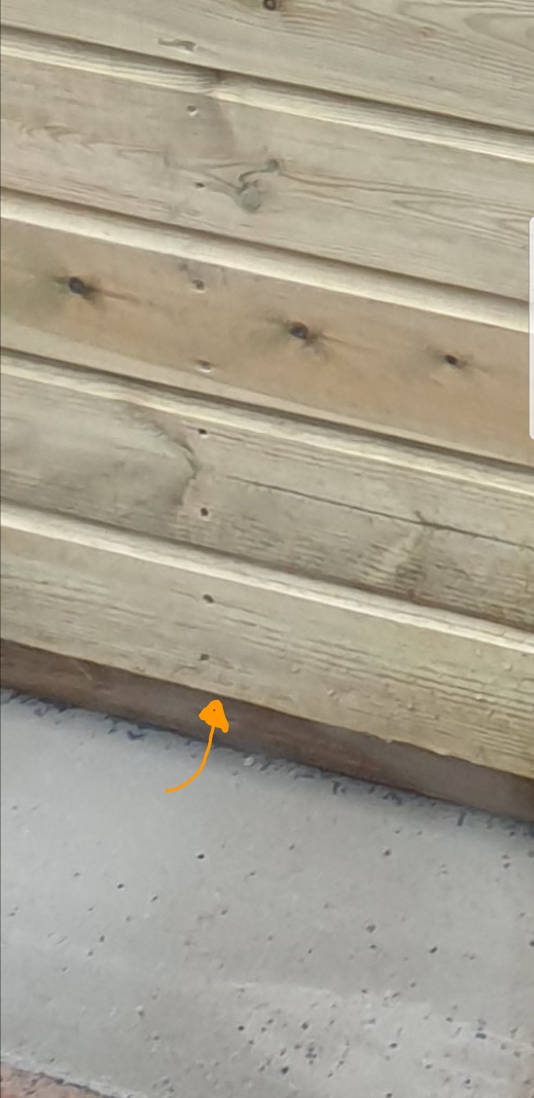

Here's a pic of outside with arrow pointing to where I'm thinking of filling/sealing so any rain bouncinguo in future won't find it's way in up through the wood.
as your damp is on a corner inside
check on the outside theres a baton or other timber to cover the end grain and gap between panels
if the splash back persists try a 45% angle cement bead say 2" wide or a temporary bit off timber along the ground
better to stop the water getting there in the first place
When you look under on the outside you can see the edges of the tongue & groove floor and the bottom of part of the 3x2 batton. So yeah, quite a bit is vulnerable to splash back.
It wasn't just one area of damp inside it was quite a few in similar places. I've used sticks like sh!t adhesive/sealant underneath as it sticks well to wood and is waterproof so it's all completely sealed now so hopefully that will sort it but I may put a batton under there as well.
This photo was taken earlier before I added the sealant underneath. As you can see, it's dripping wet.

I had also earlier ran a bead of silicon across the bottom of the batton as you can see in the pic.
to be honest the very last thing you should do is add sealant or other to stop moisture escaping at the bottom as it will cause more rot
better to stop moisture reaching the base but leave it breathable
wood will only rot at about 19% moisture content above or below it will suffer but not rot
its better to deflect or remove the moisture hitting the base
indeed ii built my shed in 2005 the glazed door is cheap softwood it has only been coated with primer and nothing else
it gets the weather many times a year but is fully sound and untouched by decay as its not sealed
if you think about rot on doors and windows its always at the bottom rail because paint will seal in moisture so it cant escape better to let it breathe and it will last longer
Ahh crap, ok I understand now.
I was going to ask you exactly what you ment by a 45% concrete bead but the heavy rain coming I felt I needed to act fast and do something that I have the capabilities of doing as the sight of water penetrating the inside of the shed is very alarming.
I really need to get on to insulating but can't do that until I have seen proof that no more water is coming inside.
I know you are right on what you said about letting the wood breath but I was thinking that with it being a tongue and groove floor and cladding with little holes here and there that there hopefuly will still be enough air circulation for the wood to breath. I will be using 50mm cellotex and leaving a 20mm airgap on the walls and can leave an airgap on floor to if that will help the wood breath a bit more to make up for my mistake. Also, as it will be used as a games room I will be running a dehumidifier whenever needed to pretty much keep a constant 55% humidity or whatever is needed so hopefully there won't be to much moisture being blocked from escaping. What do you think?
dont worry too much about the silicon it wont do any damage as there is plenty off surfaces around for moisture to escape
if your timbers are on the concrete you need to raise them off by at least a few mm if possible
