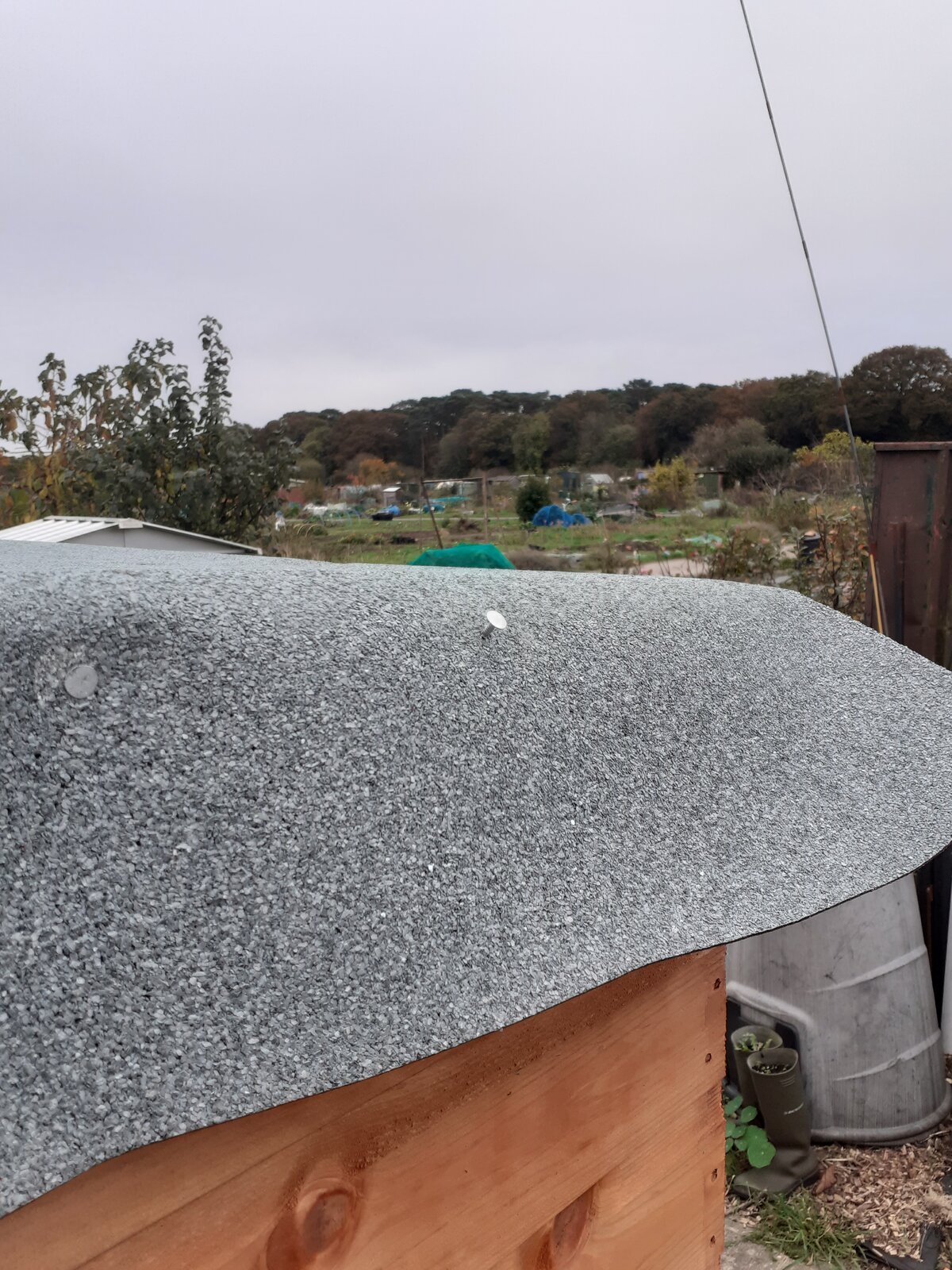

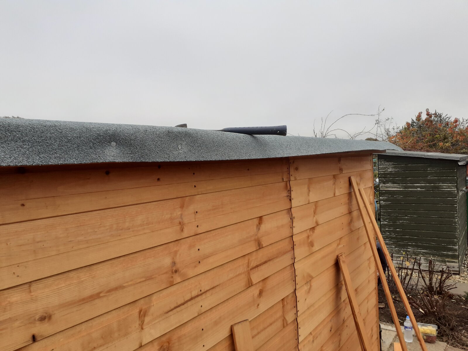

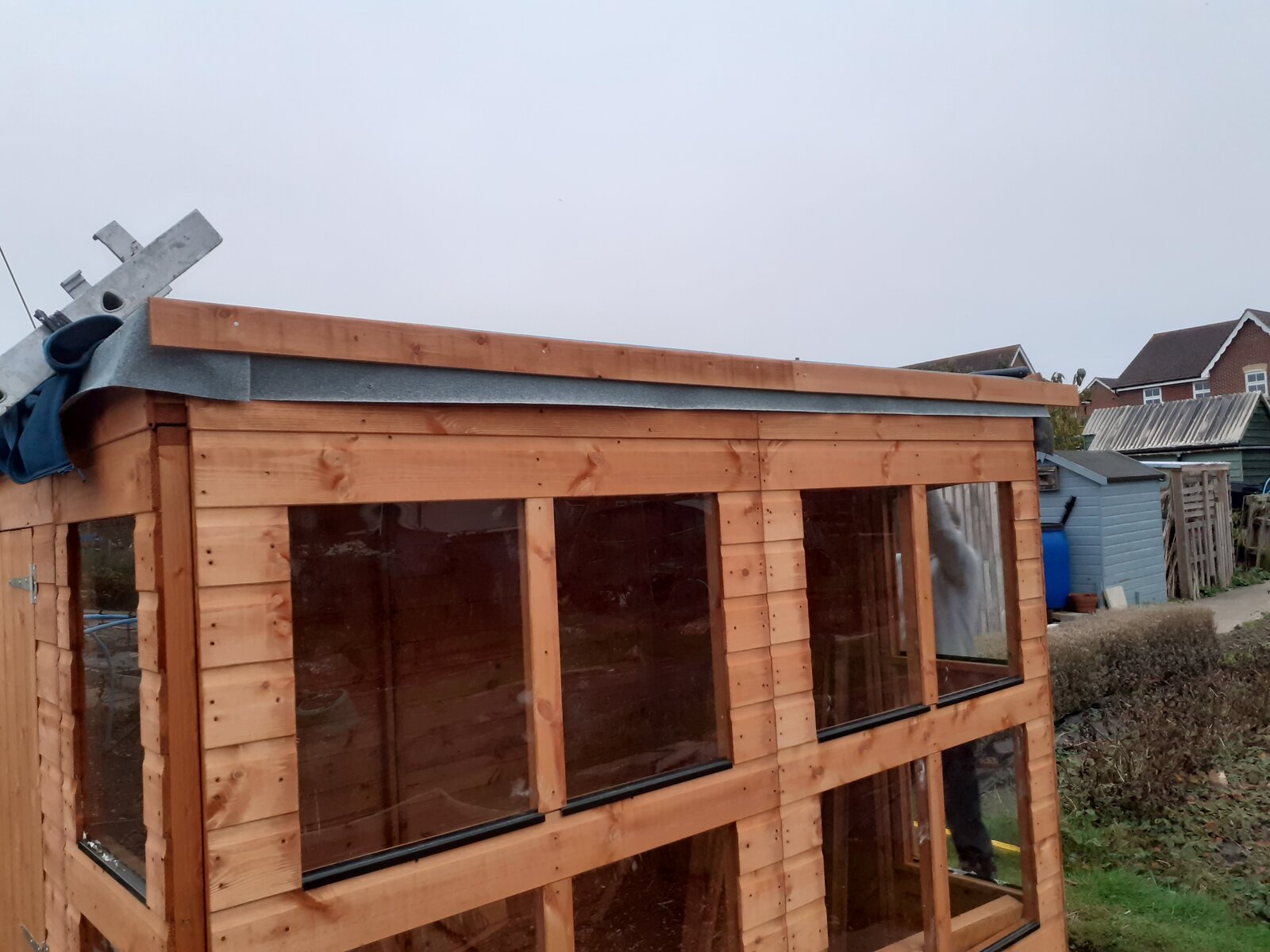

I lined felt up with bottom of baton on one side then flapped a lot of it over other sides. Used felt nails to pin it then put baton over top and ran stanley knife to trim flush with bottom of baton. Ok?

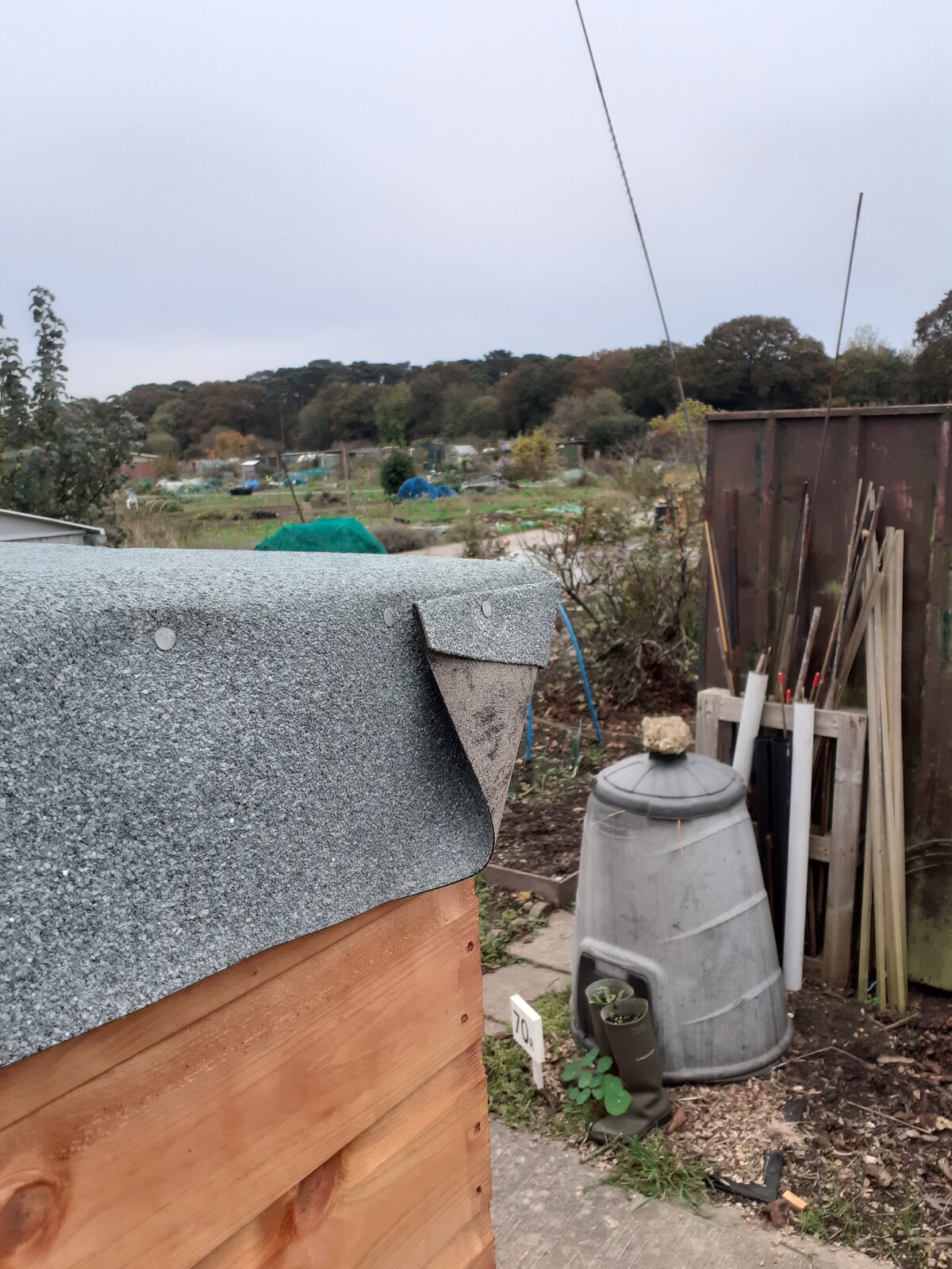

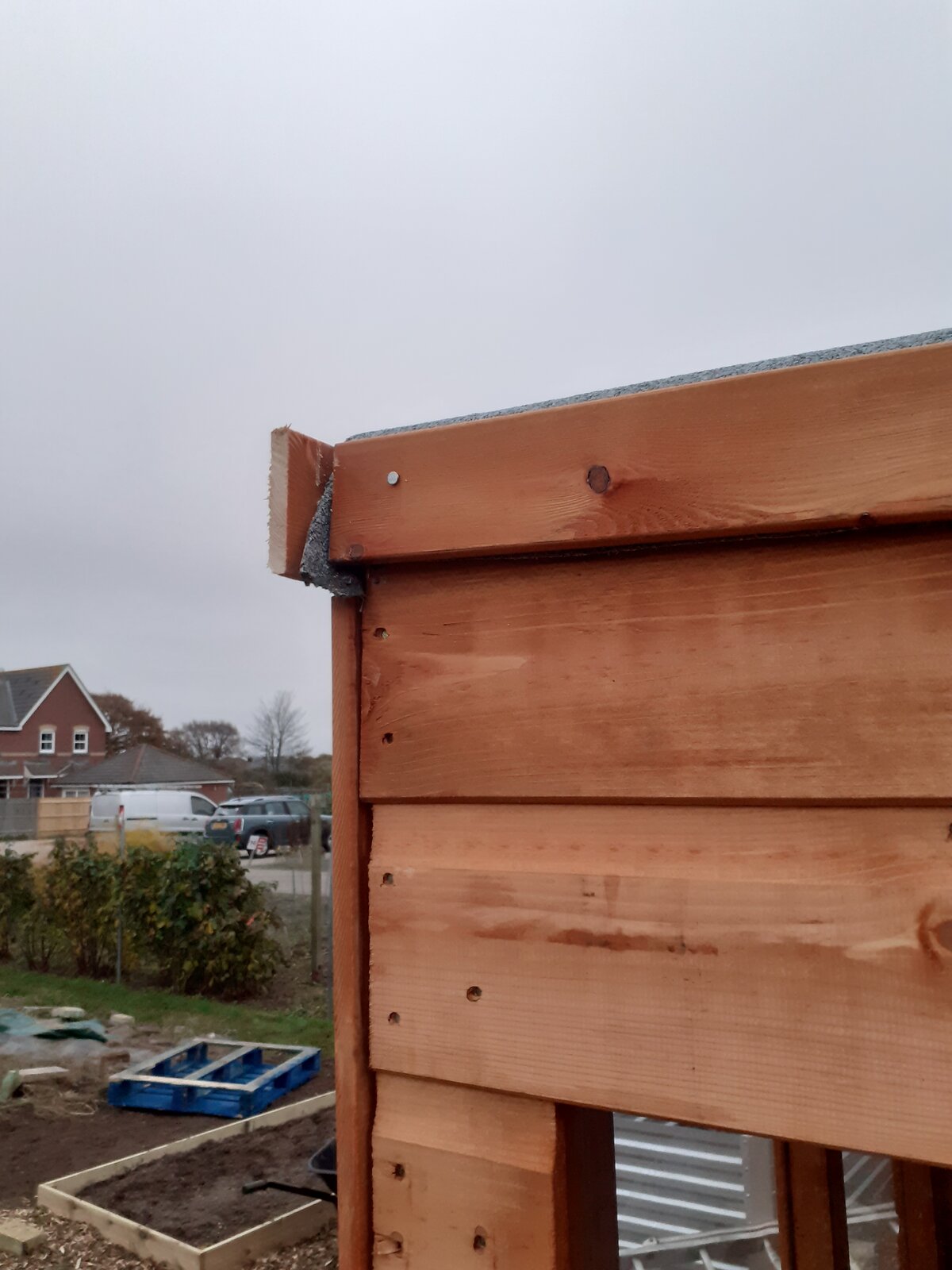

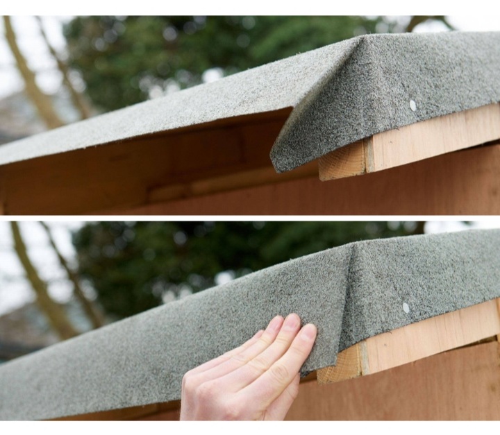

How about corners? Fold them? The felt nails are too small for corners .

That’s generally what’s done.....the felt edges will deteriorate in a while though where the folds are, and some Acrypol will delay things.

Any technique to putting in those little felt nails? Too short to hold while hammering, I ended up pushing them in with fingers then hitting in
