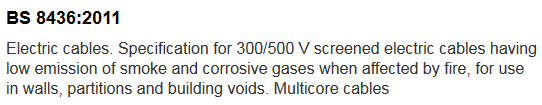

A strange conclusion, given that the standard describes itself as "Specification for 300/500 V screened electric cables"

But returning to BS 8436, the standard describes the use case as "for use in walls, partitions and building voids". Not underground

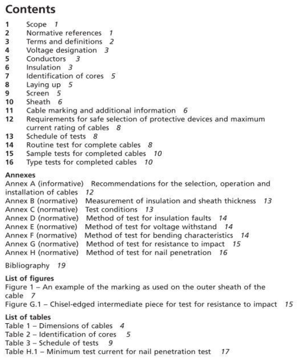

The table of contents:
Chapters 9 & 10 would indicate that the screen is not a sheath, and that the screen and sheath are different layers.
...but 522.6.204 allows that cable while only calling for an earthed metal covering. It does not mention screen.​
