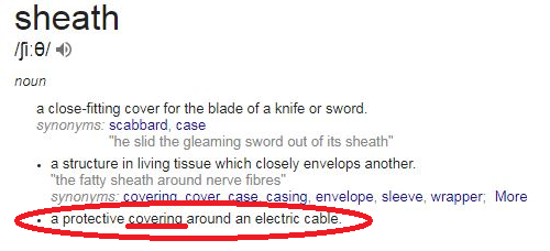

So there is a continuous aluminium covering, a "tube", enveloping part of the cable ?
In the absence of any contradictory definition (see the dictionary definitions I quoted earlier in the thread), this is therefore "a" sheath - being a covering on a cable. It's primary function may well be for EMC screening, but unless you can find a definition of sheath that excludes an "aluminium tube enclosing the cores" then that cable would appear to meet the requirements in BS7671 IF the CSA of the tube is sufficient to be used as a CPC for the circuit.
As said, there may be other reasons not to bury it, though having XLPE insulation suggests that the non-waterproof nature of PVC isn't one of them, but the lack of a metallic sheath isn't one of them.
I trust you aren't arguing that a cable can only have a single "sheath" ?
I trust you aren't arguing that a cable for which the standard does not say it has a metal sheath but does say it has a plastic sheath can be considered to officially have a metal sheath?
No, I'm arguing that a cable that has something which meets the dictionary definition of "a sheath", and where that "sheath" is metallic, has something which is a "metallic sheath" regardless of what the manufacturer or standards call it.
So are you arguing that aluminium is not metallic ?
Are you arguing that a "tube" enclosing the cores does not meet the definition of "sheath" ?
Because unless you argue that one of those is incorrect, then it is rather hard to see how you can argue that in the case in question, the cable does not have "a" metallic sheath. It also has an XLPE sheath over the top of that, but that doesn't alter the nature of the sheath inside it.
Unless you have found some official definition of sheath that differs from what everyone (except, it would seem*, you) accepts as being a "sheath". If you have, then post a link and we can all stand corrected - but until you find and post such a definition, then we have to assume that you are being belligerent in your usual manner of having your own definitions and trying to claim that the rest of the world is wrong.
* Yes, using the dictionary definitions I recently posted showing it's use as "would appear" :whistle:

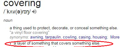

Does it have to define covering for us to know that the screen covers and as such may even be a sheath.

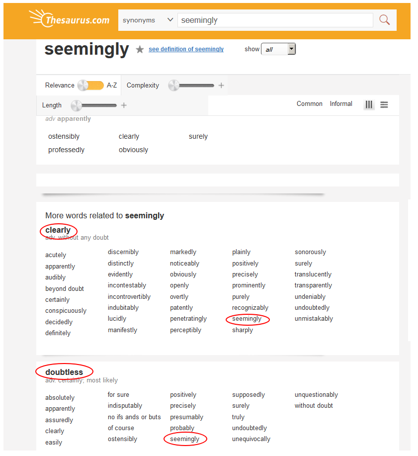

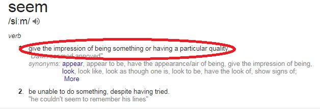

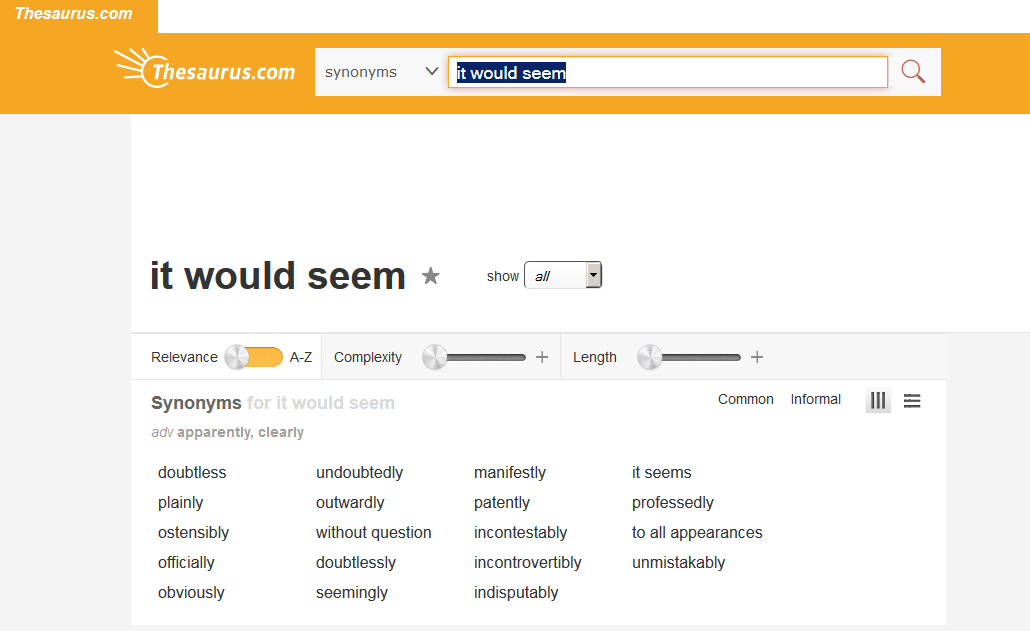

Try looking in a Dictionary rather than a Thesaurus ;) VERB 1 Give the impression of being something or having a particular quality. And Collins seem to agree as well - to appear to the mind ..., to give the impression ...
Indeed.
Furthermore, I don't really care what definitions can be found in dictionaries or any thesaurus. When I add the word "seem" or "seemingly" into a sentence (let alone three times into the same sentence), I do so deliberately in order to indicate a lack of certainty. Virtually everyone will understand that such is my meaning/intention, and most of them will use the words in the same way for the same purpose themselves. If a dictionary or thesaurus indicates otherwise, I would say that it is the dictionary/thesaurus which is 'wrong' in terms of how our language is used.
Consider "The answer to the question seems to be .....". Would anyone (other than BAS) take that to mean the same as "The answer to the question certainly is ...."?

How about "522.8.10 only seems to indicate that that would be OK, there is no certainty that it actually is"?
Ah - the Humpty Dumpty approach. Jolly good.
I shall remember that last part, the next time you tell me that no matter what I think about the correct definition of a word (e.g. electrocution), dictionaries reflect reality, they do not prescribe.
But given your first statement, shall we take it that you don't care that the Collins English Dictionary 21st Century Edition describes seeming/seemingly as
apparent but not actual or genuine, outward or false appearance
So when you wrote this:
Seems alright, assuming all done correctly.
You didn't actually mean it only has the appearance of being all right but you are uncertain?
You were using "seems" in the way the thesaurus entry I posted earlier uses it?
As far as regulations are concerned, I don't think one has to look any further than 522.8.10. That seems to indicate very clearly that any cable with an earthed metal sheath may be directly buried,
Agreed.
Good job I got involved - you and John have been discussing this but you mean different things by 'seem/seemingly/etc'
John is adamant that he uses it to indicate that he is uncertain:
He meant that there is uncertainty over whether 522.8.10 indicates very clearly that any cable with an earthed metal sheath may be directly buried.
