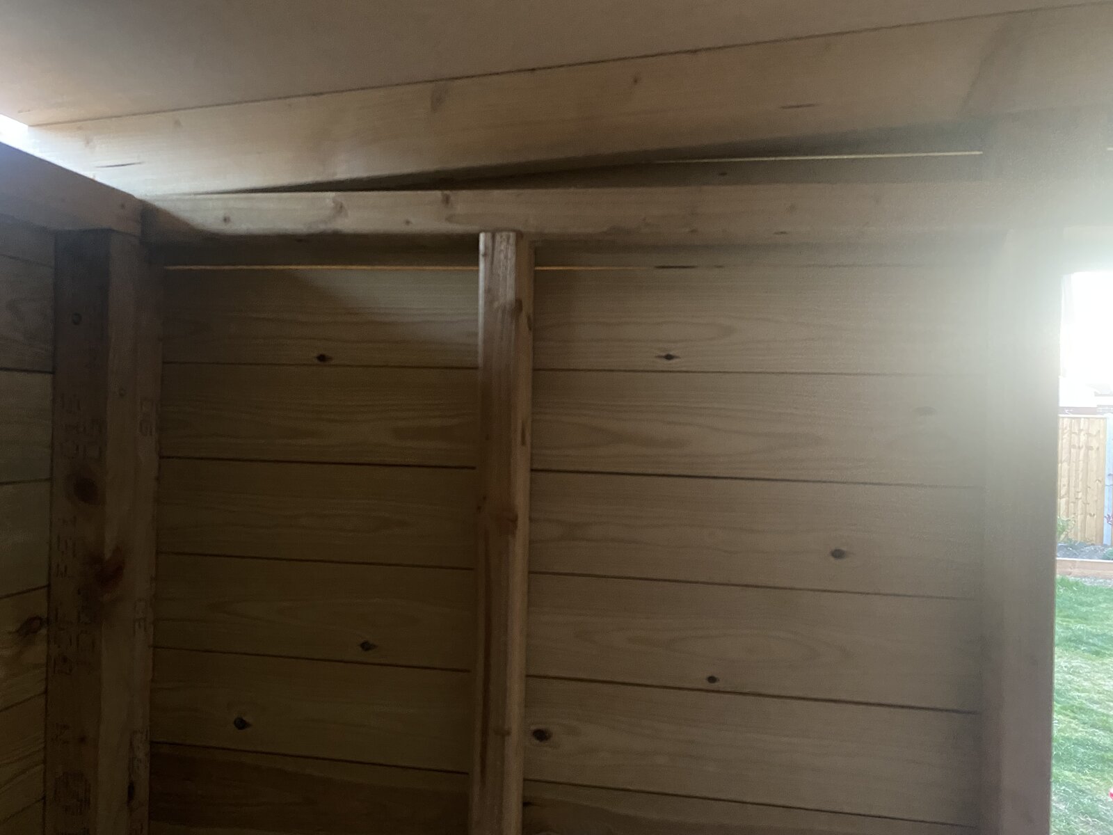

Hi all,
so, been building a shed, and i'm no professional so there are imperfections here and there.
one being between some planks of the shiplap. I don't think it'll let any rain in, but with the changes in temp the boards are having a move about and I can see sunlight through in a couple of places.
Is there a recommended (i assume flexible) sealer to use between the planks on the inside? or should I just ply line it and forget about it?
I am intending to store mostly tools and garden equipment in here, but want it to last for as many years as possible.

all are screwed in from the outside, so moving them now would be a pain in the rear.

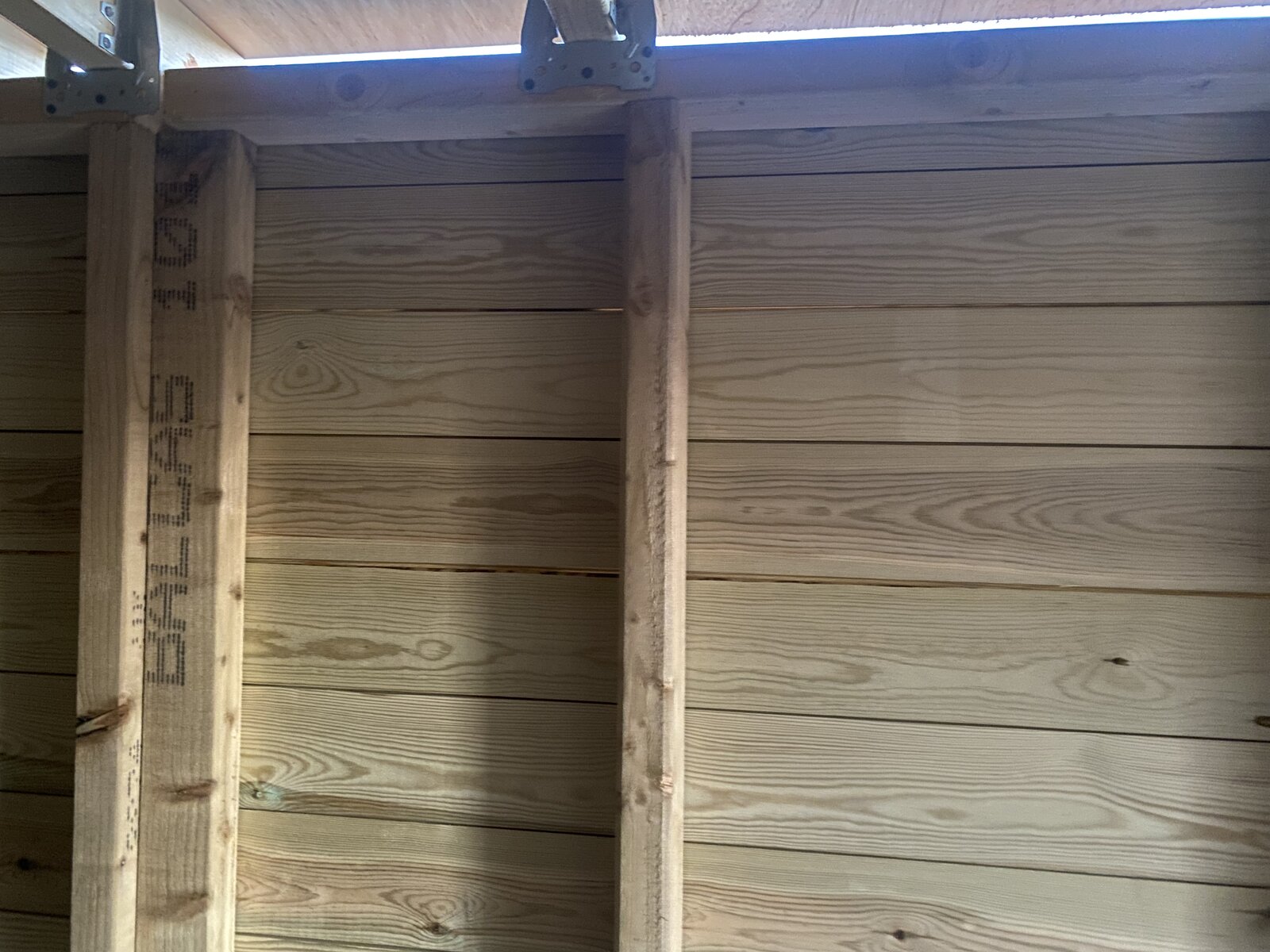

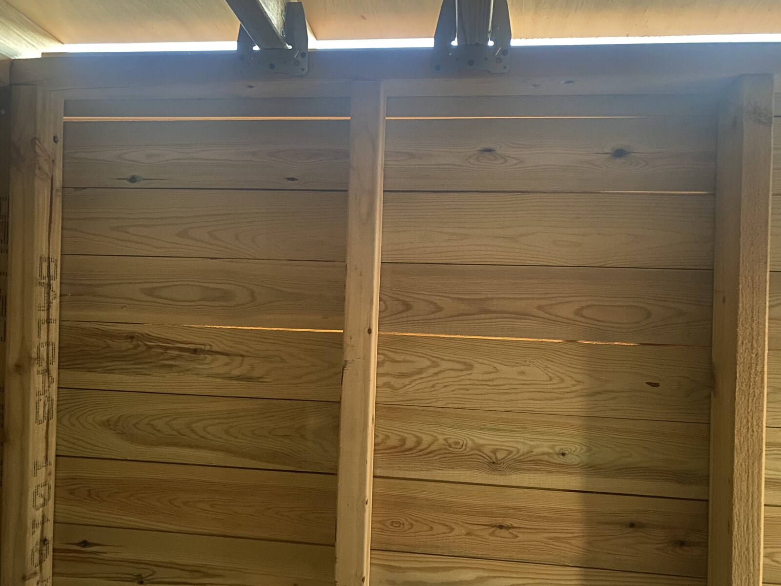

there really nothing else to be done? Attached are the images of the “bad” areas in question (ignore the clear area at the top, that’s to be covered on the outside tomorrow)

I assumed it was really just a limitation of the material and the fact I didn’t dry it out for a month before using it. I’d hoped I could just leave it as is, or fill the small gaps with something - or clad the inside and be done with it
assuming they are ex 5x1" shiplap the coverage should be 109mm with a 2mm expansion gap so measure the bottom off one plank over 10 planks and you should be on 1110 or there about
when you remove any plank swap the order off the first 4or 5 planks when refitting to avoid the screws just finding the same holes
How large is the overlap/tongue?
Wood will move depending on humidity etc.
Perhaps they were not clamped tight enough before screwing.
If it doesn't leak, perhaps there's not a problem.
Oh it’s not leaking at all, it’s purely light coming up from under the tongue if anything. I didn’t want to clamp them too far to allow for movement so they were only given a whack to locate I’d thought pushing too much would create more issues.
so no, purely light, not leaking at all, which is why I’m hoping I can just clad the inside and forget about it for a few years
When wood is wet, it will be at it's largest size, get some hot sunny days and it will shrink... mosty on the width, not length.
Do as you say if you have spare wood.
I’ll be ordering the ply tomorrow if that’s the easiest route to take.
I really don’t wanna worry about the shiplap unless I really have to. Was a bloody long job getting it done and I’m really keen to get using the shed asap
ok my thoughts you need to 100% sort the cladding first otherwise the inside will get damp to wet
yes you can do all sorts off temporary fixes that may or may not work but will mean far more effort and bodges in years to come
