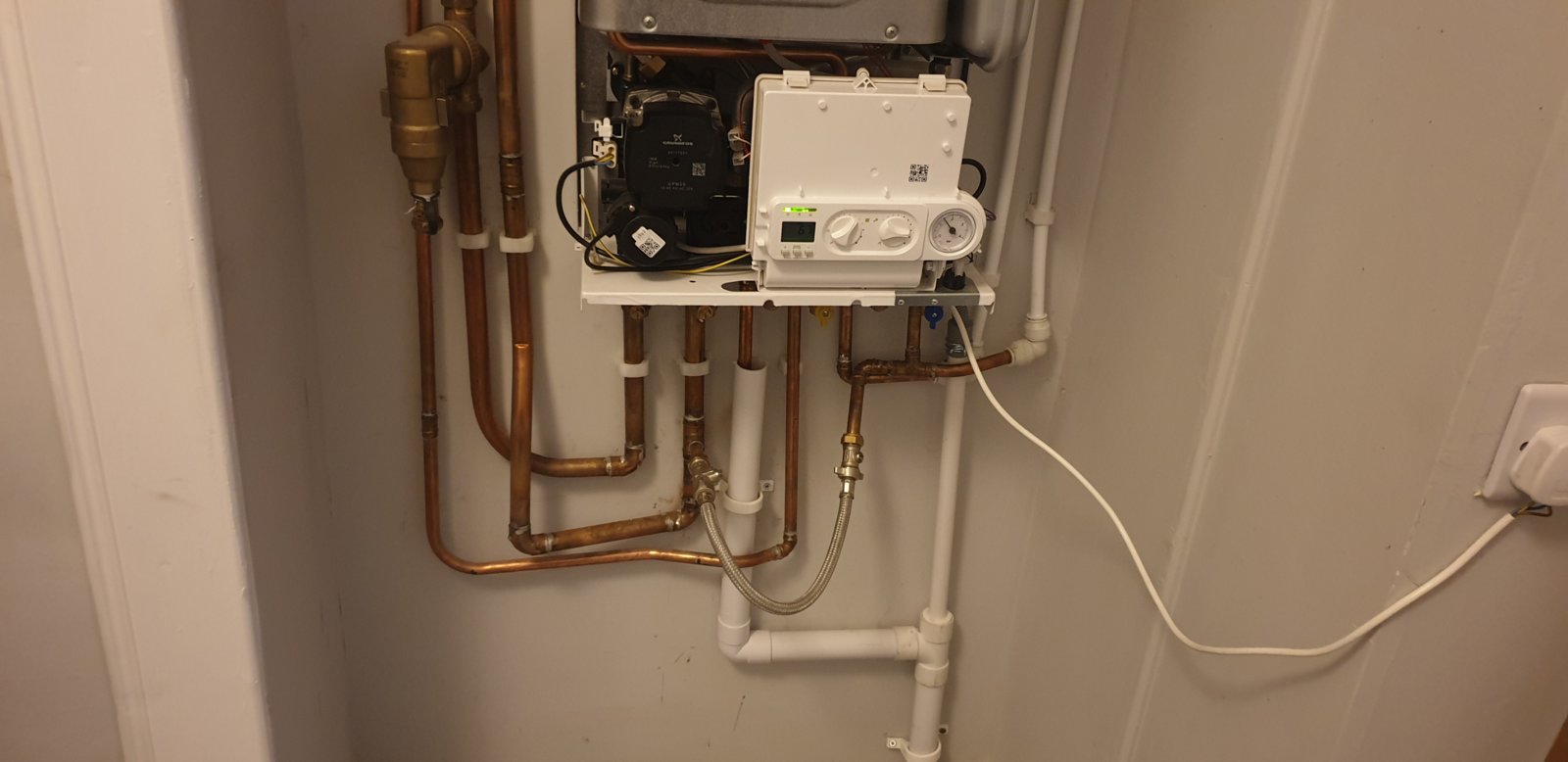

I just got a new boiler fitted a few weeks ago and I'm pretty certain the guy cut every corner possible. The system was not flushed, no cleaner or inhibitor was used and the core for the flue was eyeballed without a pilot hole drilled.
The condensate drain goes into a PVC pipe that was previously used for a kitchen sink (kitchen was relocated by the previous owner). There's no trap on this connection and the fitter has branched the PVC pipe with an open end and placed the copper pipe of the blow off / PRV into this to avoid drilling another hole through the wall (picture attached). Getting some funny smells in the room occasionally, which I'm assuming is sewer gas so I'll need to install a trap somewhere.
Also been bleeding the rads regularly for the last week as a lot of air was left in the system (my CH pipes goes into the loft space before dropping back down to supply the rads from below) and the water coming out the bleed valves is black. The guy installed a Spirotech filter and I've been flushing that occasionally too and the water that comes out is full of little black bits.
The cold feed has been placed on the flow side, if I isolate the return on the boiler and open the cold feed (while keeping an eye on the pressure gauge) would i be able to use the Spirotech as a drain point to flush the system? All the rads are connected on 8mm microbore pipe, would this be likely to result in a blockage?
Finally, would I be able to connect the cold feed with an external pressure gauge to the Spirotech and use the fill point as a drain to do a backflush (after removing the non-return valve) or is backflushing unnecessary?

Wow that’s rough. First thing that should be sorted is the plug (shouldn’t have cables like that on show:eek:). Yes there should be a trap to prevent smells entering the building, also that gas pipe maybe inadequately sized. Yes it should have been checked/flushed prior to installation and should have had inhibitor added for protection, especially since you’re bleeding rads and introducing fresh oxygenated water. 8mm microbore is inadequate in my opinion, and susceptible to blockages.

Yeah, I removed the cover as I could hear occasional drips and wanted to check it wasn't leaking. Just condensate dripping into the boiler trap I think, don't see pooling water anywhere.
The boiler was originally up at high level but the old flue core was only 100mm and the new flue was 110mm, so they had to move it down after hours of struggling to widen the old core with no success. The old boiler was plugged into a socket coming off a fused spur directly next to it and they left me to relocate the old socket and used the nearest socket available. I think they left it messy cause they were lazy and knew I was going to change it later anyhow. Debating wiring it directly into the fused spur but probably won't, easier to just move the socket and neaten the wiring.
My flat is old so the gas pipe is 15mm throughout. He told me that there's enough flow during full gas demand so it's not an issue but I should consider changing to 22mm pipe when I get the money and time. The microbore pipe was also preexisting and I haven't had any issues with blockages yet. Although one rad is full of sludge and will need to be removed and flushed in the garden at some point.

I don't about the plumbing aspect of that but the installation is a f****** disaster. Even if you got that load of bollo for cheap it's still an absolute mess. But what I did notice is the plug top. The cable should be cut so that the outside insulation can be clamped by the strain relief clamp inside the plug top. Whoever installed that mess has just left the three internal conductors hanging outside the plug top. Highly dangerous.

Also just noticed the earth look so like it wouldn’t be the last to be disconnected :eek::eek:

benchmark? The commissioning checklist has been filled in but I don't think it's worth the paper it's written on. Claims Fernox cleaner and inhibitor was used which I know for a fact wasn't. I know I got screwed but I'm not concerned about that, dwelling on it isn't going to get my money back. They know they have you over a barrel when your boiler gives up the ghost 3 weeks before Christmas.
I just want to fix the corners that were cut so this boiler will last and I'm certain having a system full of magnetite isn't going to do that. So my question still stands, is a mains water flush going to be worthwhile or do I risk blocking the microbore pipe? Can the Spirotech be used as a drain point and fill point for backflushing?

What's done is done, cost is now irrelevant. According to the commissioning checklist, Gas Inlet Pressure is 17 mbar and 16 mbar at maximum rate. I think 20 mbar is the recommended for Vokera, so upgrading that pipe is another thing for the to do list.
Still, I ask again. Is a mains water flush going to be worthwhile or do I risk blocking the microbore pipe? Can the Spirotech be used as a drain point and fill point for backflushing? Or do I just add inhibitor and leave alone?
Contact Gas-Safe and ask for an inspection...they will force the installer to correct all the gas faults (at no cost to you) and keep an eye on him.
