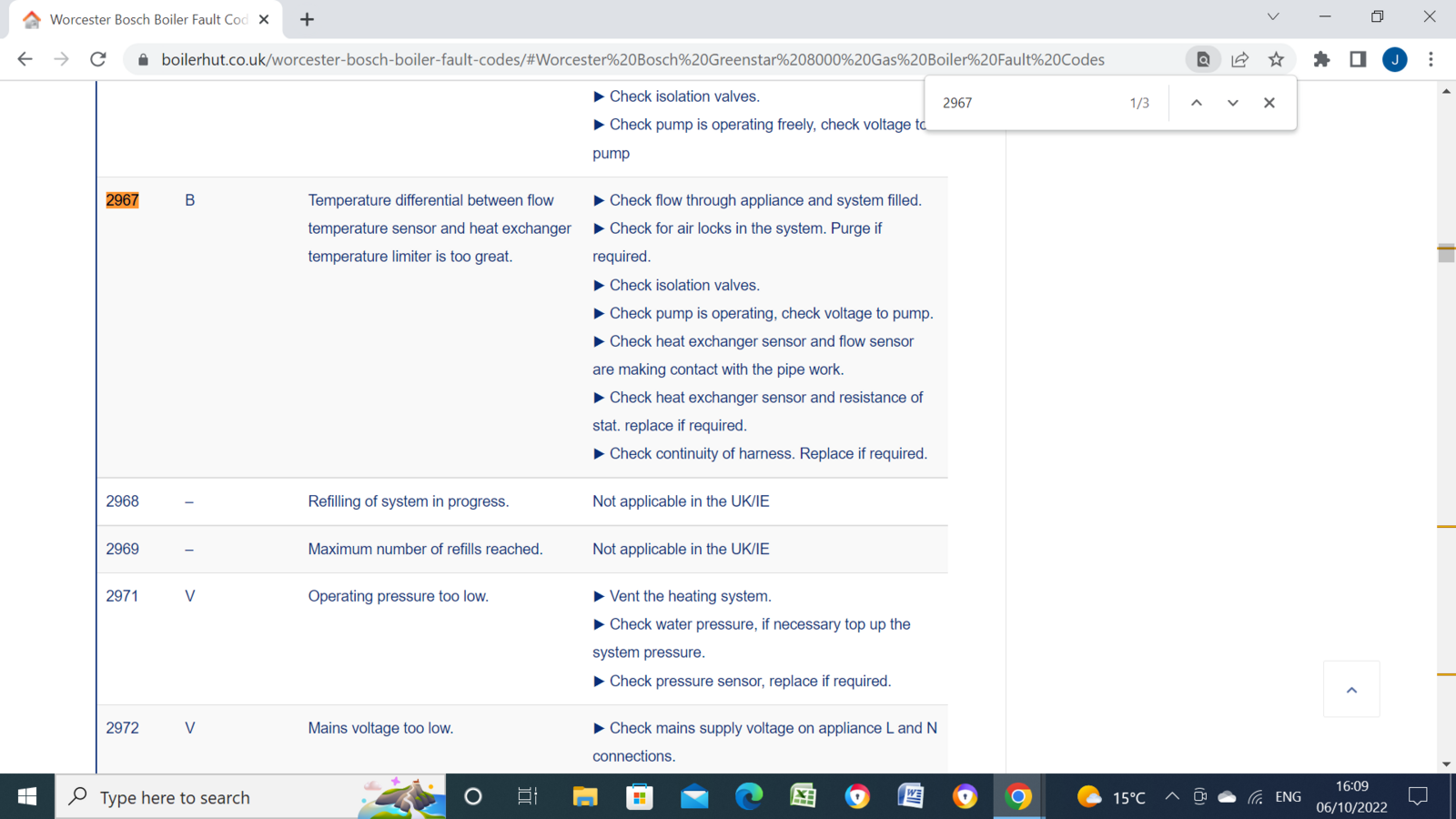

When it cuts out, the status is 2967 "Temperature differential between flow temperature sensor and heat exchanger temperature limiter is too great"

Not at all, if the differential between HEX and Flow temp is too great then the flow through the HEX can't be high enough and it will then short cycle but the restriction could be anywhere, even in the main HEX. Is the boiler protected by a normal system filter close to the boiler? It could be that the X400 has dislodged some crap that's now found it's way to a key area causing a restriction. Could also be an air lock somewhere, if the system is vented. Is everything heating up evenly when it gets up to temp?

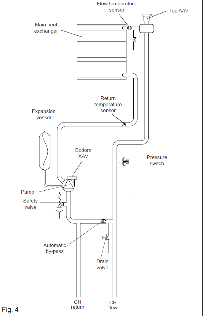

A schematic of your boiler might be of help, You could back flush through both but under no circumstances would I flush through the drain unless it's disconnected from the condensate drain, danger, however little, of getting water inside the combustion chamber or where ever.
Thanks, it shouldn't be to dificult to divert the drain point from the condensate drain.
Flushing through the the air vent is a good idea as the the vent is/should be on the HX flow side so should flush through the whole Hx.
Probably something like this Vokera Vision 20S
