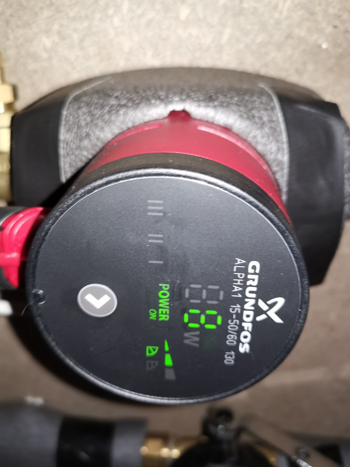

In the previous post I stated it was running in CC. I just checked the manual, and realise it was running it on CP3. The photo is correct and Ive edited the previous post to avoid any further confusion. Sorry!
The photo is showing CP3, if it was on any of the CC curves, either I,ii or iii would be lit on the left.

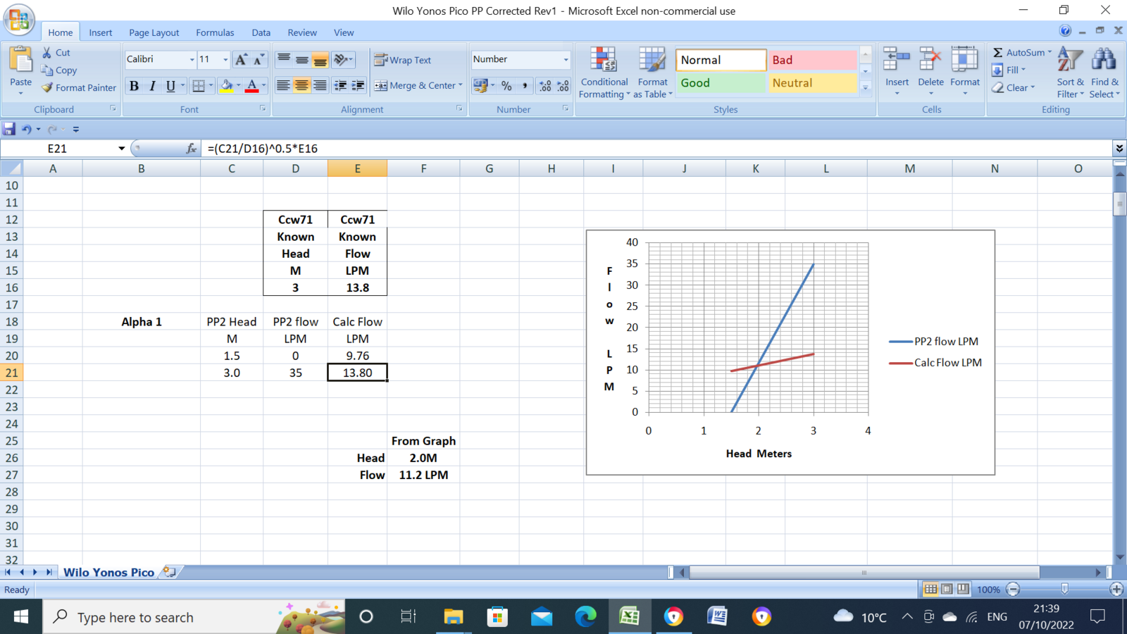

I don't think much has changed since last year, you were getting a florate of about 10LPM @ a 2M head on PP2 which = 15LPM @ a 4.5M head, so maybe no restrictions really, just change back briefly to PP2 and
post the power watts.

Yes, I really don't think you have a flow problem as PP2 readings now arn't much different to that of a year ago and your boiler had no problem with a 10/11LPM flowrate at a @2M head?

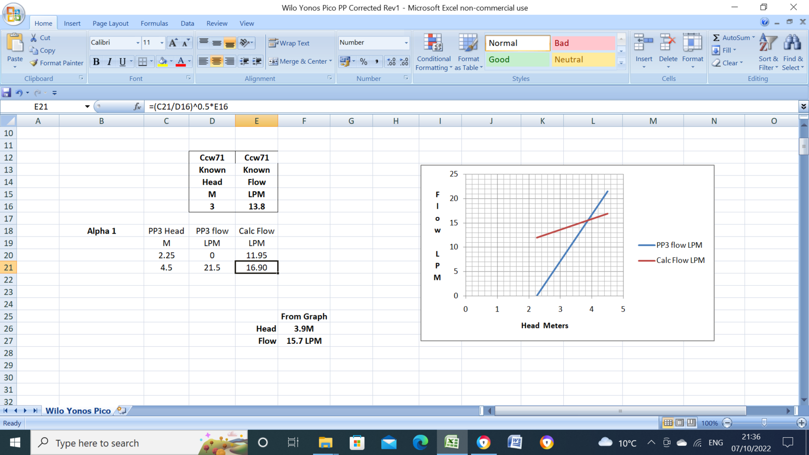

I would suggest setting it to CP2 which at 17W (just now) is producing a flowrate of 0.83m3/hr,13.8LPM @ a 3M head and shouldn't present problems to drawing air etc through the vent, so may have to look elsewhere for your problems.
Re your problem with air ingress/vent problems, just put "combined feed and vent" into the search box, above, and you will see some interesting comments, you can start a new thread when the above is sorted out as I am almost 100% certain that my form of combined cold feed and vent (50 years old) will solve it.
You might just get away without air ingress, if required, by running in PP3 mode as the head will be 3.9M but will give a flow of 15.7LPM.
Original setting, one year ago, was PP2 which gave a flow of 10/11LPM, Present flow is very close, at 11.2LPM so unlikely to be restricted flow caused by chemical clean?.

So from your calculations you'd say there in no restriction. Does this apply to the HX also, or could there still be a partial blockage there? Is it still a good idea to attempt to back flush it or would this just be a waste of time?
You also talked about the flow rate at a 2M and a 3M head. Is there anything I can measure / tell you to allow you to confirm this figure or is it something that comes from your calculations?

Re circ flow, except the pump has developed some fault or other which is most unlikely, then yes I think your circ rate is the same now as it was before that acid clean, there could be a bit of crap holding the internal bypass open (if the boiler has one installed as supplied) now after the clean, monitoring that flow & return will give a few clues.
"CP2 which at 17W (just now) is producing a flowrate of 0.83m3/hr,13.8LPM @ a 3M" that is the actual flowrate which should just about, IMO, allow the boiler to get away.
"You might just get away without air ingress, if required, by running in PP3 mode as the head will be 3.9M but will give a flow of 15.7LPM." Have you tried this setting??.

Last hursdays numbers added up CP3 @ 28W = 16.33LPM. Boiler dT, (64.5-48.8), 15.7C. By calculation boiler output is
16.33X60X15.7/860, 17.88kw, everything pretty good IMO. The Vaillant fires up at ~70% of max output (irrespective of range rating) so fires up at 40X70% = 28kw, by calculation, dT = 28X860/16.33/60, 24.6C, still OK as I think it may flag S53 at a dT > 30C.
Its now trying to fire up at a pump setting of CP2 which flowed 13.8LPM, so dT now is 28X860/13.88/60, 28.9C, very close to the 30C limit if this is one of S53 triggers which it probably is.
PP3 should give a flow of 15.7LPM with a dT of 28X860/15.7/60, 25.56C , might just get the boiler away, give it a try.
