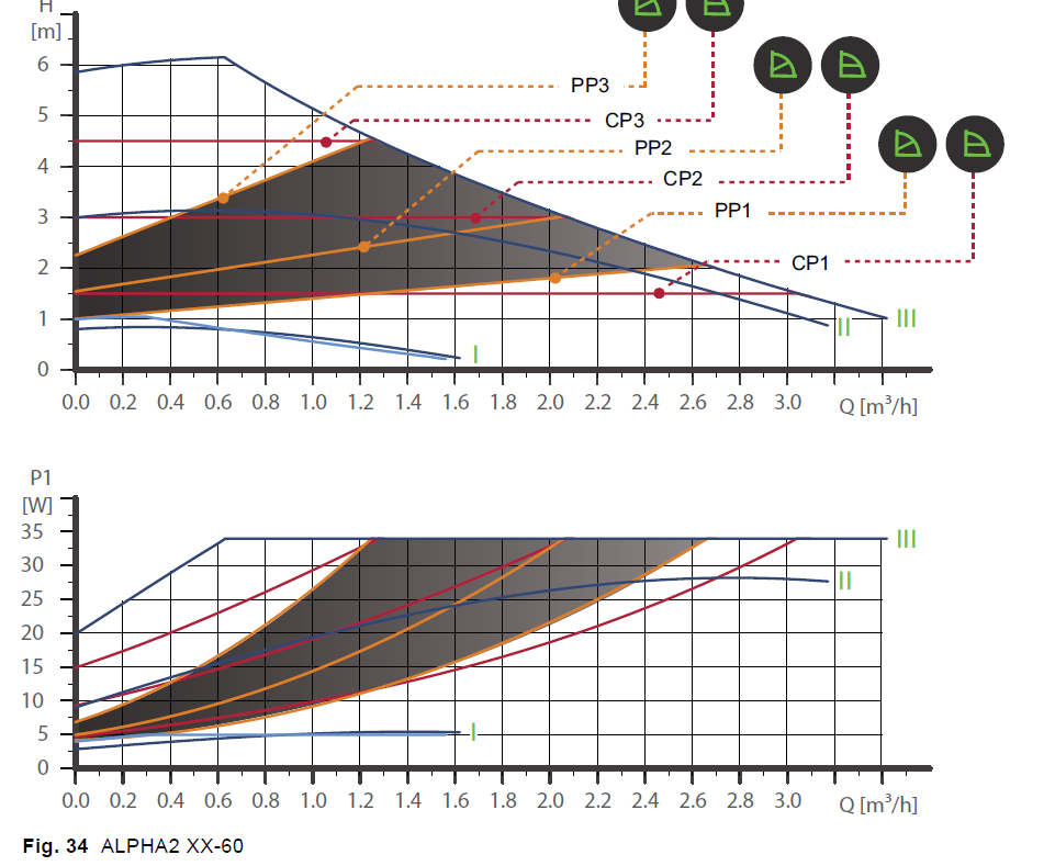

Can you post a photo of, or/and the exact model of Alpha 2 pump.
If its the 6M one and it is running in CC3 then the flow rate is only ~ 0.35m3/hr or 5.8LPM, no good, not enough.
The boiler output, based on your dT of 15.7C and my flow of 5.8LPM is 5.8X60X15.7/860, 6.35kw.

The pump is actually an Alpha 1. It will only show power on the display, so I've been trying to make sense of this, but it's way beyond me.

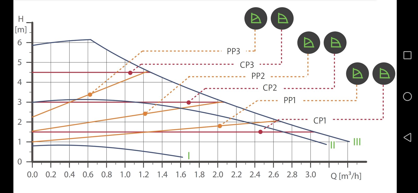

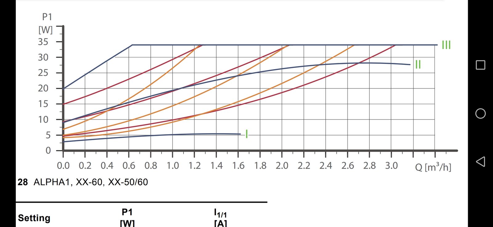

This is your lefthand graph, above.
You will see power in W on the vertical axis, and the flowrate in m3.hr on the bottom horizontal axis, you know that the pump power is 28watts so draw a line horizontally to the right from 28 until it intercepts the Constant curve III, (your setting) then drop down vertically to the bottom horizontal axis and you will see that the flow is 0.41m3/hr = 6.83LPM, very poor for a pump that is running at a 6M head. Your flow rate should be at least 12LPM so problems?.

Well spotted Jonathan, this makes a huge difference, gives a flow rate of 0.95m3/hr, 15.9LPM @ 4.5M head on CP3, that's more like it and if correct, quite acceptable, CC3 should give ~ 15.98*sqroot (6/4.5) = 18.45LPM & ~ 35W so lets see.

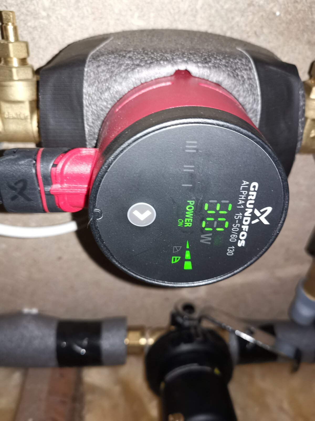

Can you post a picture of your pump + the LED settings (present) so everyone is absolutely sure that the flow rate is as it now appears to be, perfectly satisfactory, and more so if on CC3.
Actually, originally. I misread your setting as PP2, it was CP2, which should have given a flowrate of 15.98*sqroot(3/4.5),
12.9LPM @ a 3M head.
All last year it was set on PP2 and ran about 7-9W. It was running on CP3 earlier when the measurements were taken, though at this speed it seems to draw air through the vent pipe (a different issue to be resolved later) so I later turned it down a bit to CP2 (17W) for a few hours testing. Photo as it was when the temps were recorded.
