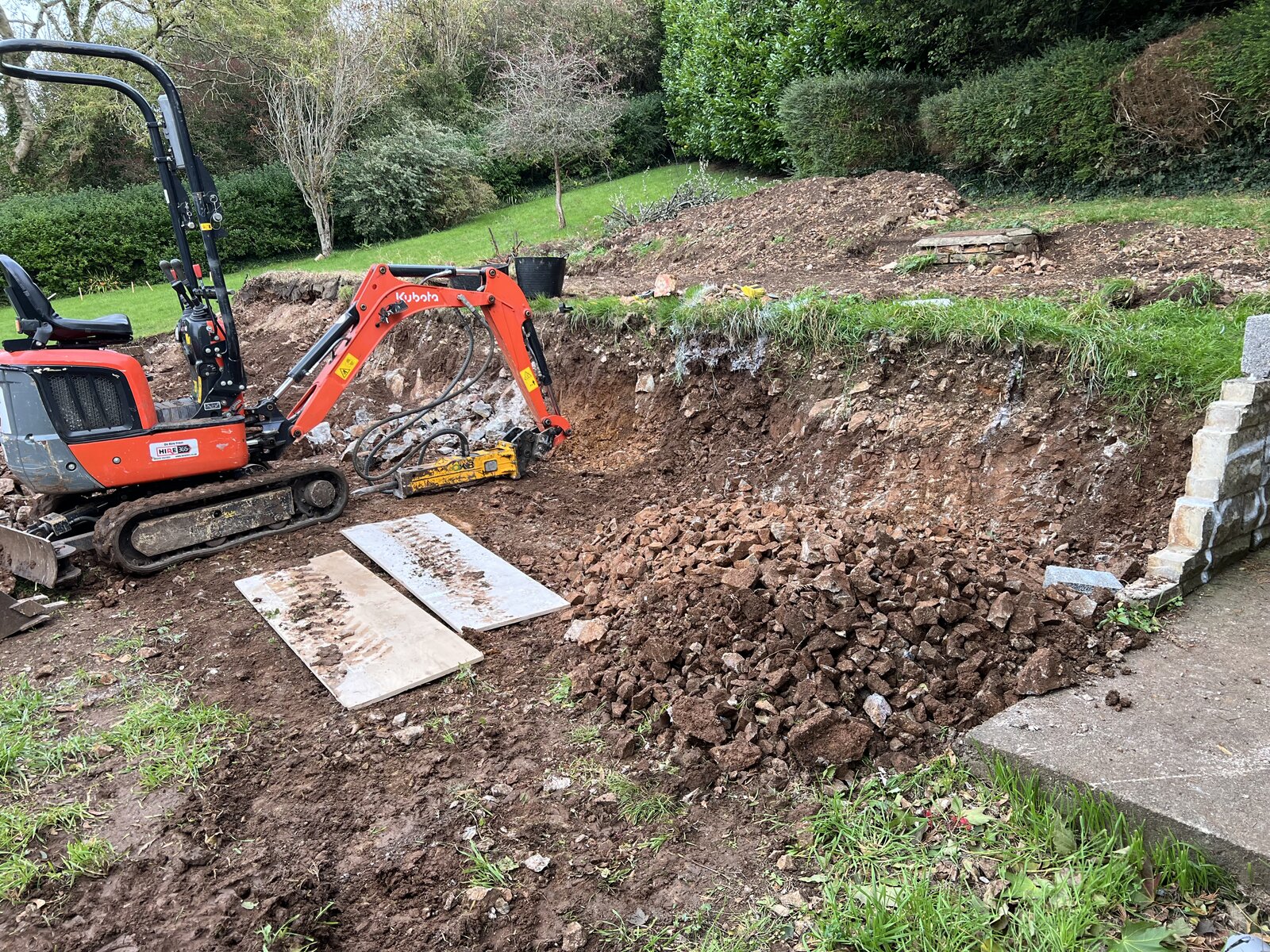

Earlier this year I took down a preexisting retaining wall in our garden in order as part of a wider garden make over.
Then hubris took over, I hired a digger, booked some holiday and went for it! I had fun, the wife is less than impressed with the state of the garden.

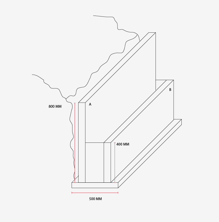

And here is a small cross section diagram, with some rough measurements.
I am getting close to putting in the footings for the retaining wall, but before I do I want to sense check a few things, and hopefully someone can offer some advice?
Q1 - Can anyone advise how deep the footings should be. The ground is very hard (as can be seen in the first image - 10 inches of soil and then its stone / rock) Would 100 / 150mm suffice?
Q2 - How much of a heel / toe should I include.
Q3 - Is it sensible to treat wall A as the main retaining wall and wall B as essentially a small planter connected to wall A. There fore wall B doesn't need a toe (just working out how wide I need to make the footing)
Q4 - If I include weep holes in wall A, and wall B am I right in assuming that this will work for drainage.
Q5 - any good advice I might need to know?
