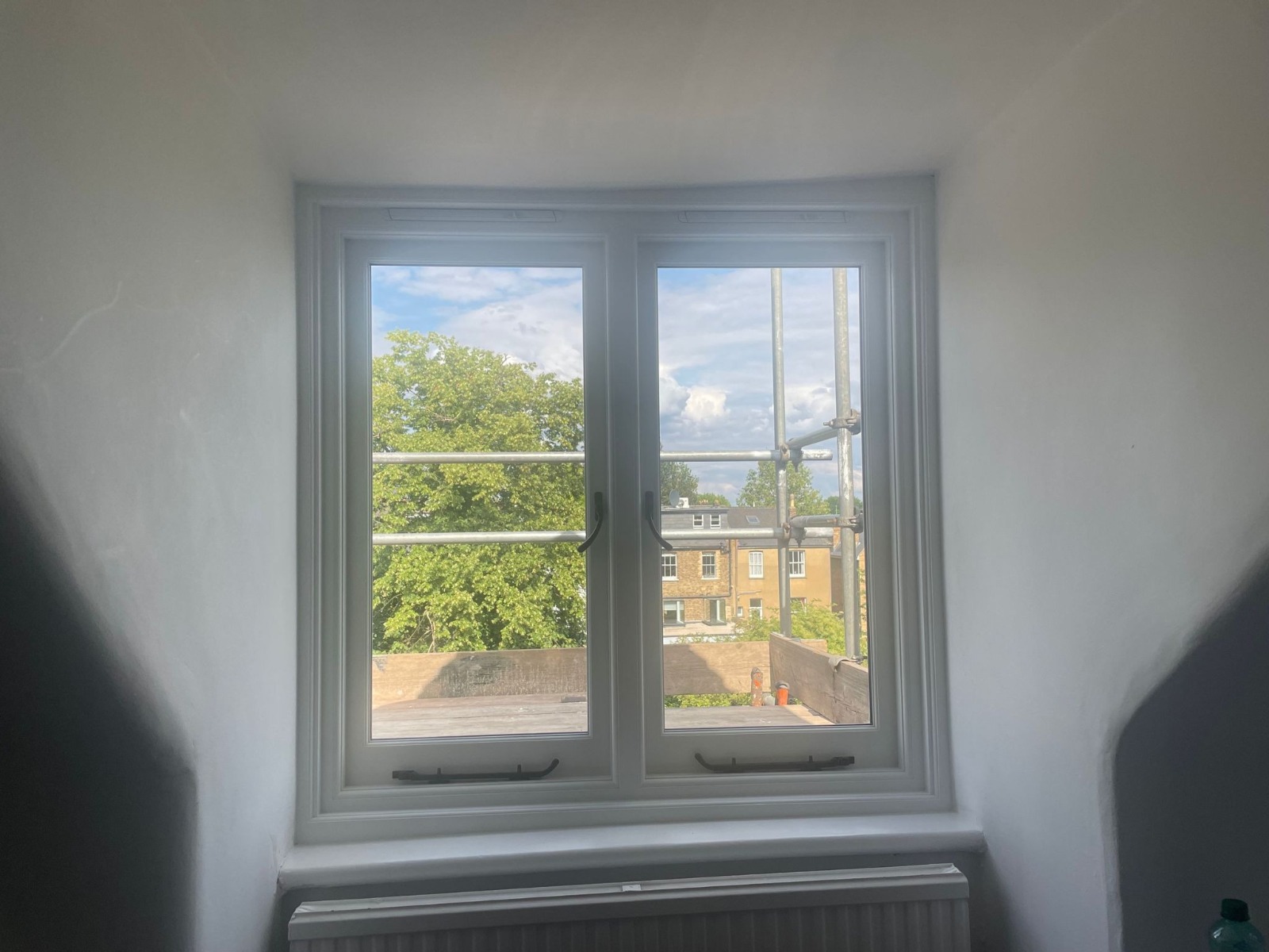

Should a new window have this much build up frame buildup?
8 Mar 2011
158
London

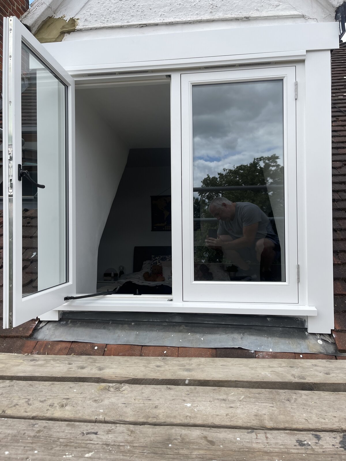

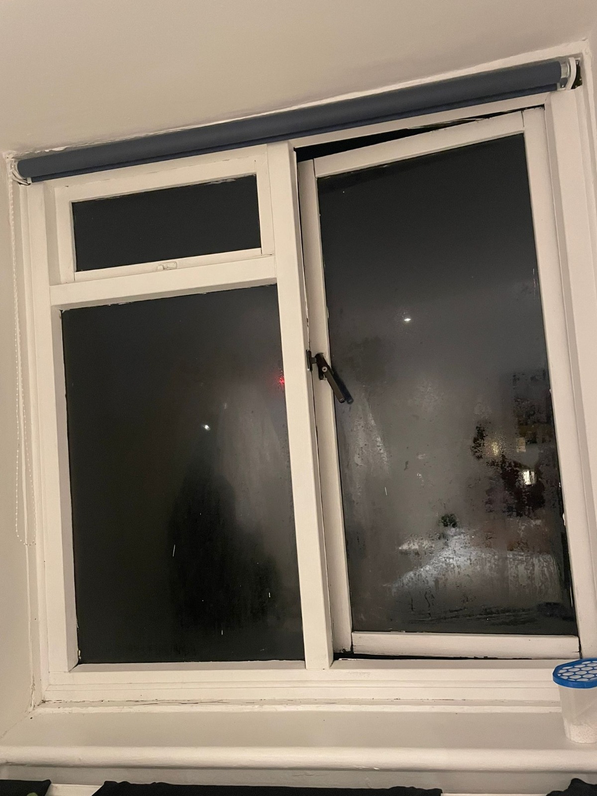

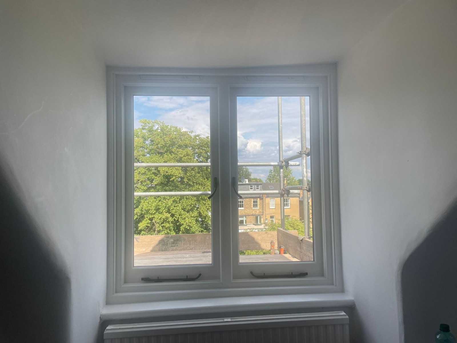

I had my windows replaced, but they have padded out the frame a lot more and added a large trim. So I now have a lot less glass, and extra layers of frames. I'm going to speak to the company on Monday, but just wondering why they might do this or why it might be acceptable? just to make sure I'm not being unreasonable with them.

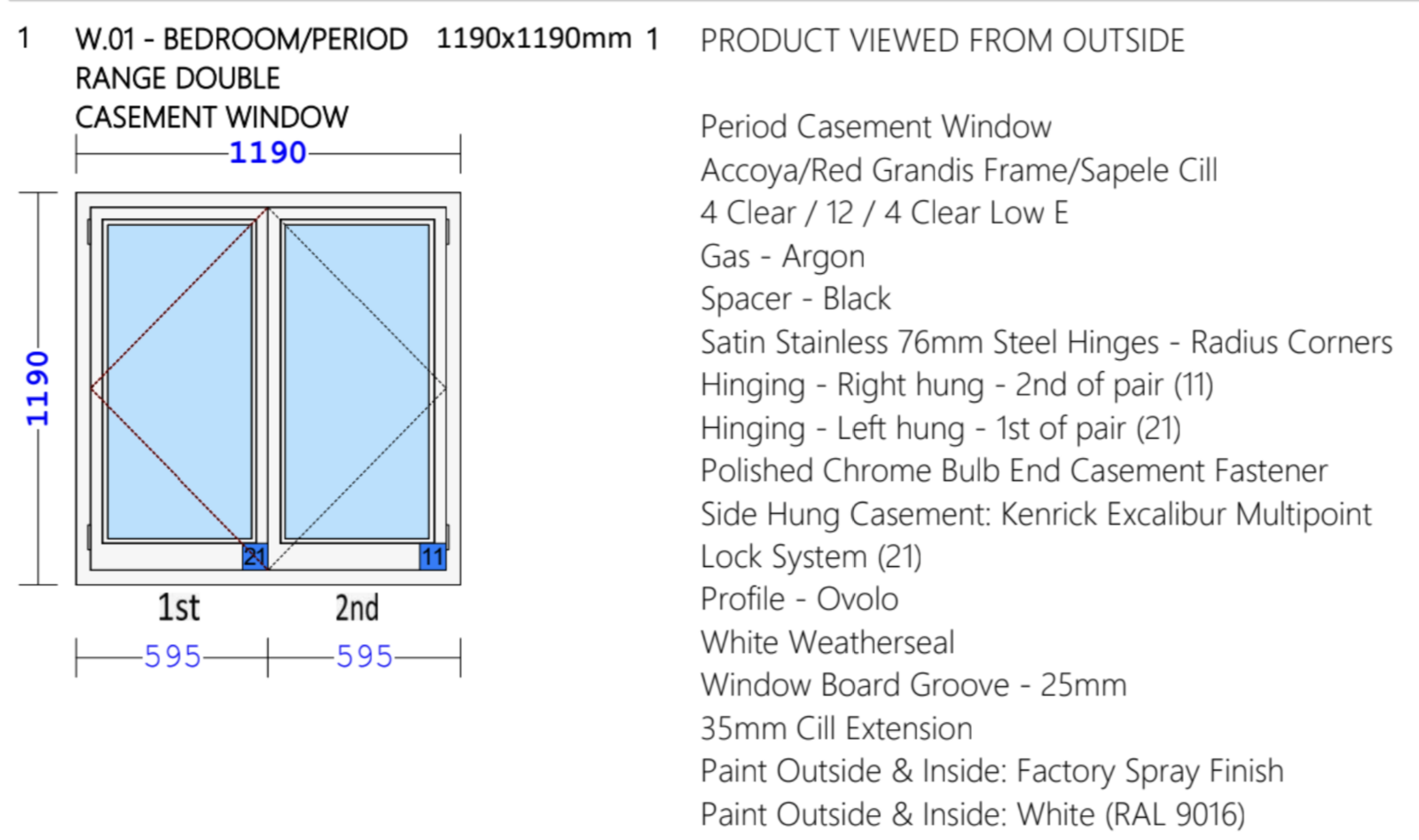

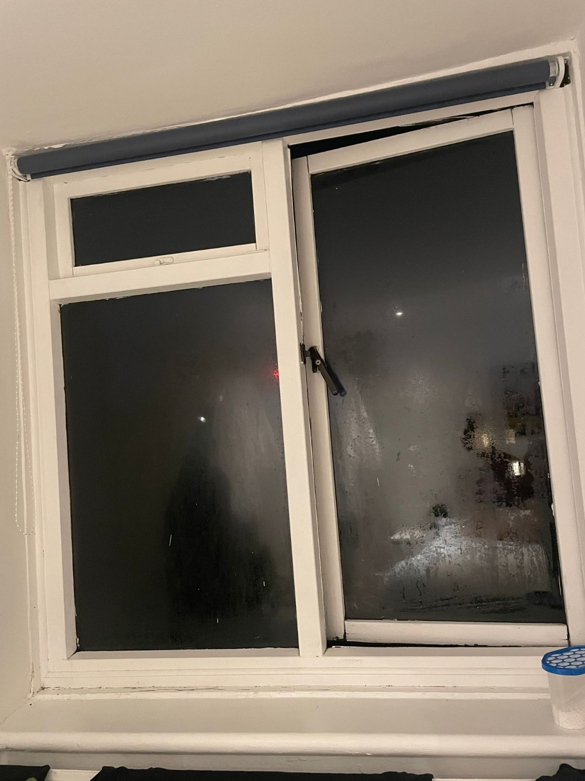

In the photos you can see the original, that one had only one opening side. In the other you can see there is a lot more build up in the lower part thus the appearance of a frame within a frame within a frame. Lastly I provide the window spec them sent me.

Looks like a nice window, but it does look like a frame within a frame.
I'm presuming it's not beading around the edge as it looks too thick.

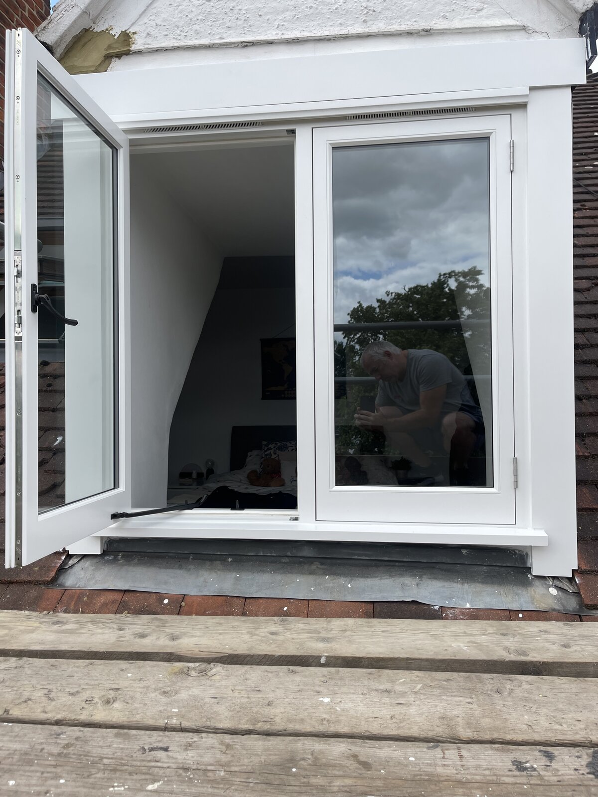

Not sure I'd be 100% happy with this. Have you go a photo from the outside?
Its interesting to note the window details say its only a 20mm unit!

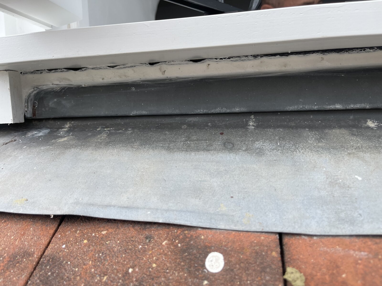

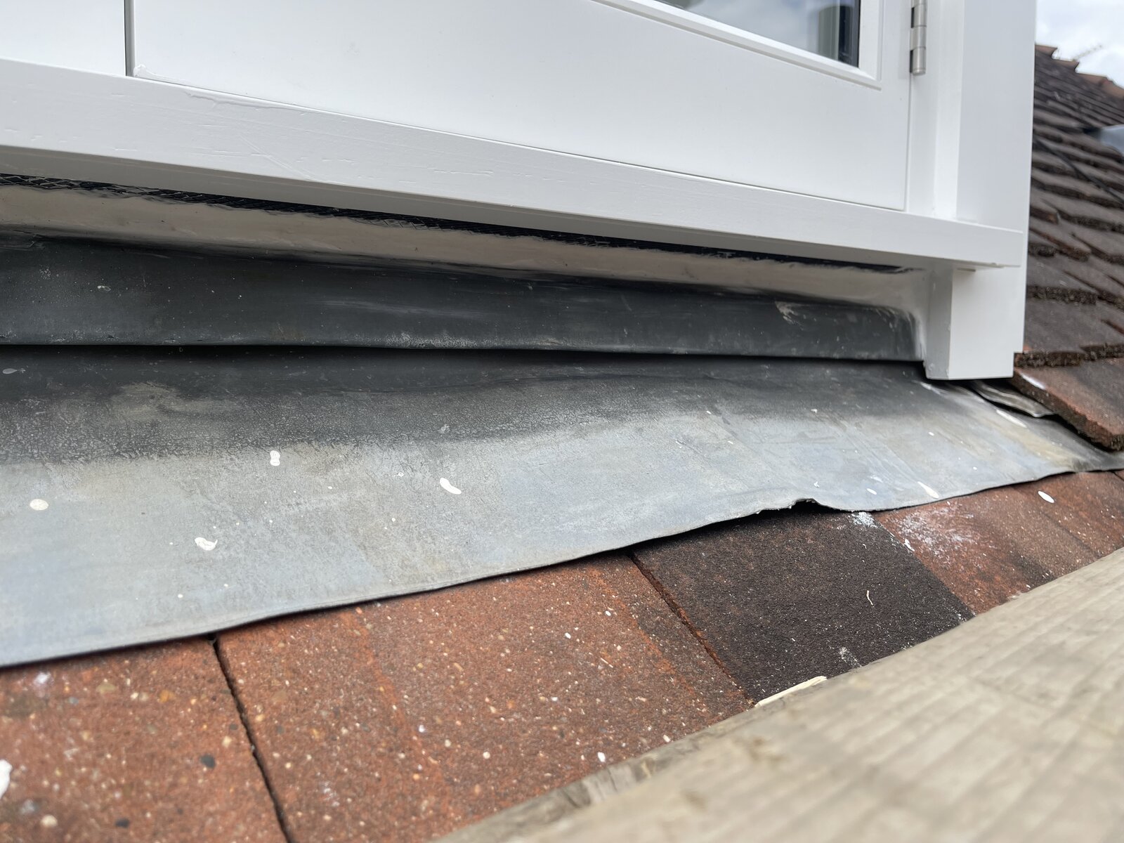

I have attached some photos from the outside. Does that help?
I just went with what ever spec they recommended there, its not something they mentioned to me. That would be the "4 Clear / 12 / 4 Clear Low E"? Tbh I had no idea what that actually meant. Hopefully 20mm will be fine. As it was clearly written in the spec, that's probably on me for not checking before agreeing the contract.

To me (a non glazier/window fitter) it looks like they may have either made the window too small so made a larger frame for it to fit in.
OR
It may be that for some reason they needed to do it that way so it looks right/opens properly from the outside.
What did the fitters say when you asked them? I take it you are going to do so?

Your new Casement Window is made from timber, am I correct?
I'd expect the window reveal (the hole in the wall that the window fits in) to have been measured at the outside - the spec quote says the casement to fit in the reveal is 1190x1190mm square.
If I made the window I'd make it approximately 10-15mm smaller than the reveal. The cill I make out of 6x3" (the 6" wide,3" high), the uprights and head out of 4x2". The rabbit for the lights to go in would be 1/2" deep. The lights (that's the frames the glass is fitted in) would be made from 3x2" for the bottom rail and 2x2" for the sides and top.
The internal reveal should be 1" to 2" smaller than the external one.
Does that help?
Maybe the reveal is much thicker than we know, I can see that without the outermost frame then the trickle vents in the middle frame would be obstructed by the reveal

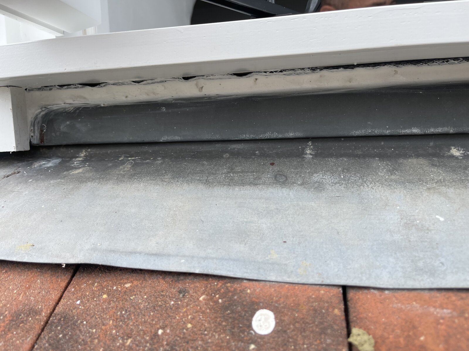

When I look outside I see maybe 15mm of sealant between the flashing and the cill (see added photos) - I doubt they disturbed or moved the flashing. So I guess that worst case I have 15mm extra build up.
Anyway I’ll see what they say, but likelyhood is I just need to accept this and move on. Atleast the windows are themselves good quality.

Do I understand you that the 124(0) measurement is the internal width and height?
If so then the casement is something like 75 to 100mm undersized.
Is this a window in a dormer? If it is then window company has taken the easy way of fitting it.
It is a dormer window.
I just spoke to a structural technician friend, he said the challenge with really older dormers like this is you can remove the outer frames and then hit a lot more problems, as you don’t know how it was fixed underneath. He says it is quite common, most people don’t want the additional expense or hassle. But that the suppliers should have talked me through these decisions. Either way it seems I didn’t ask and they didn’t mention it, so im stuck and just have to move on and chalk it up to another learning experience. But will still discuss it with them on Monday.
This is what he said:
“When I took out the old window frame there was nothing left (the timber window was face fixed to dormer cheeks (so not inside the frame) so I had to make another frame for the window to fit in. If I had kept the original frame and just did a insert like yours, it would have been a lot easier”
He noticed that actually if you look carefully in the old photo there is three frames too, just the other is slim so you hardly noticed it. In the new, you can see 15mm bead of silicon. So he thinks that old slim frame plus new, accounts for the extra build up, which makes it all more obvious.
