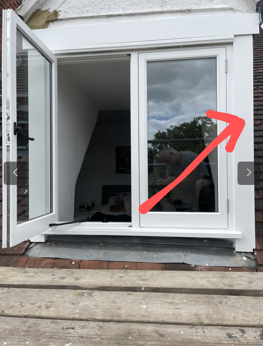

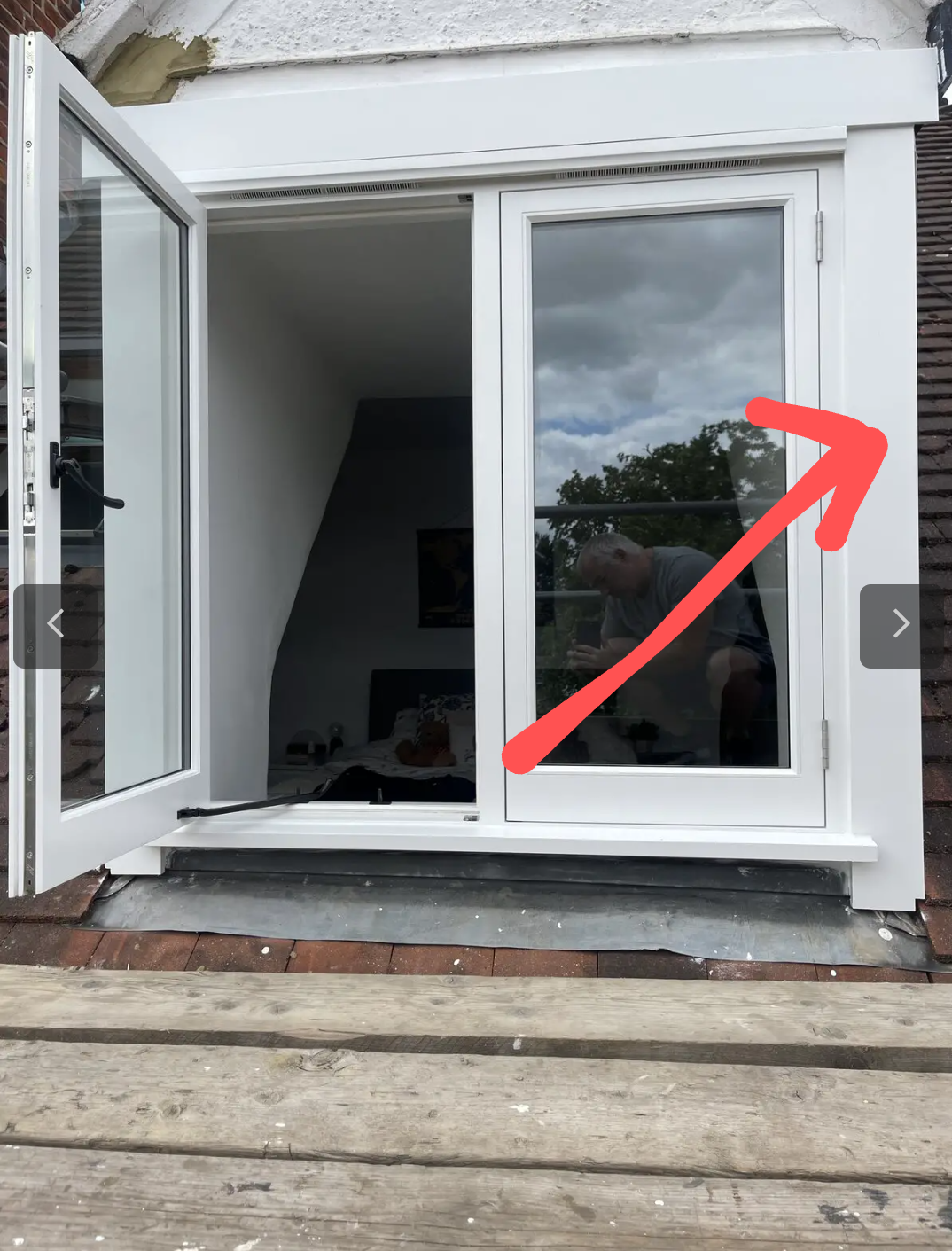

So I've had a dig in my reference books (published circa 1950). I understand what they have done, I think, much because of they way it was measured up. Do you know if the person who measured up the window did they remove the original facia boards from the sides and top of the old window before measuring?
I will say the window man has put the side facia boards over the joining faces of the multiple frames which is good thing.
Would I want the job to replace such a window 'Properly' - No, not without seeing the original plans and photos.
I hope that provides you with some re-assurance. Yes I do think it's a learning experience for you along with others on this forum.
I presume the 'He' in the quote above is the window fitter.This is what he said:
“When I took out the old window frame there was nothing left (the timber window was face fixed to dormer cheeks (so not inside the frame) so I had to make another frame for the window to fit in. If I had kept the original frame and just did a insert like yours, it would have been a lot easier”
I guess the window has been replaced before and the present replacements followed the same practise.He noticed that actually if you look carefully in the old photo there is three frames too, just the other is slim so you hardly noticed it. In the new, you can see 15mm bead of silicon. So he thinks that old slim frame plus new, accounts for the extra build up, which makes it all more obvious.
