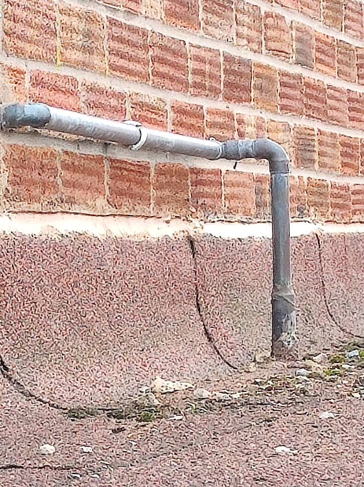

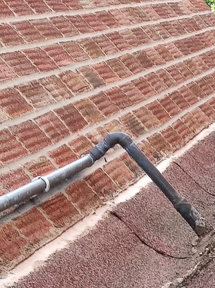

Should i be painting this gas piping?- exposed to elements.
3 Aug 2022
75
Hey all
I got a financial interest in this property a year or so ago and have been trying to fix the various issues (so far have done roofing, new boiler, and done a lot of painting myself.)
In our garage the gas supply branches off with a copper pipe going through the garage roof, i assumed it would be copper piping on the other side (i never go on the flat roof) but instead have this on the other side.
Is this black pipe? should i be painting it? There is no leak (i had a gas check a few months ago) but i dont think that piping has been maintained in 15 years since it was installed.
Thanks.

Perfectly ok to leave it how it is but if you want to paint then no reason why not to
Thanks, i will do - i think i was expecting copper piping not black pipe to be honest, i didnt think black pipe could be exposed like that. Unless it is copper that has gone black i have no idea how to tell.
I will get up there and get it painted with some anti rust paint.
Thanks again.
looking at the joints it is copper pipe that has discoloured
Scrape it and copper will shine through
