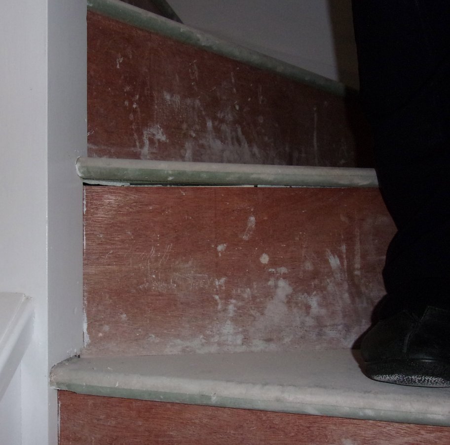

Mum is moving into a new build shortly, but (amongst other things) I've got concerns about the stairs. Some of the steps are already dropping as you can see in this photo. With weight on the tread at the bottom of the photo, it's dropped and pulled down the riser opening up the gap that's visible under the left of the next tread up.

It's normal to glue those triangular blocks on, and pu glue is very strong. The gap itself isn't an indication of a structural problem, could just be inaccurate cuts needing filling/carpeting over. As you need an expansion gap, it may get worse or better throughout the year.
If the step is actually moving when walking in it, then either the wedges haven't been fitted properly or perhaps some timber has failed.
Yes, it's moving. There's no gap without weight on the step, then the weight makes it move that much and open up the gap.

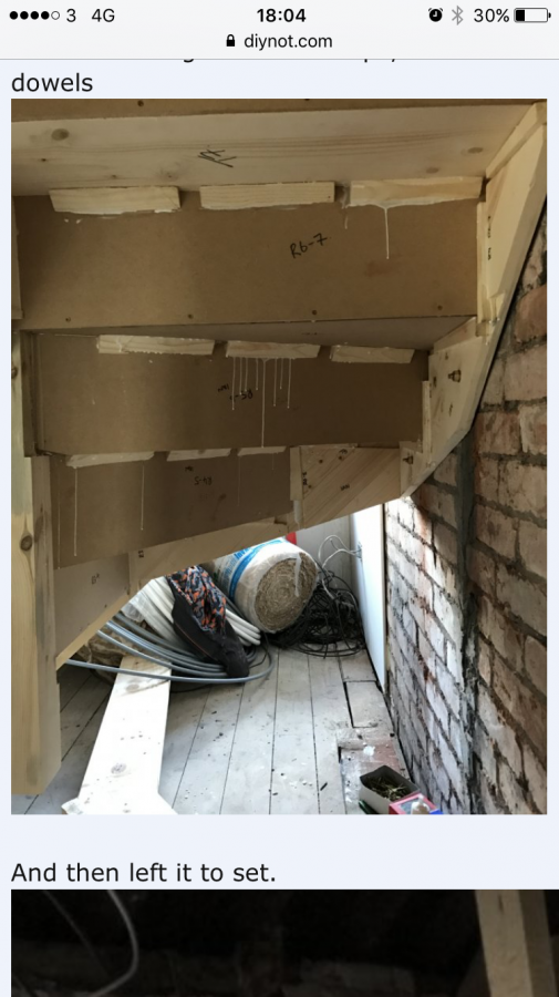

I got some pictures underneath the stairs on a couple of the other houses - I'll upload them when I get a minute. To my eye, there's naff all support at the inside end of the treads.

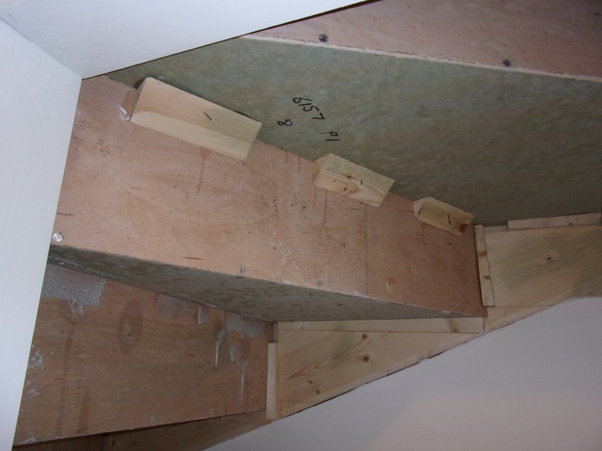

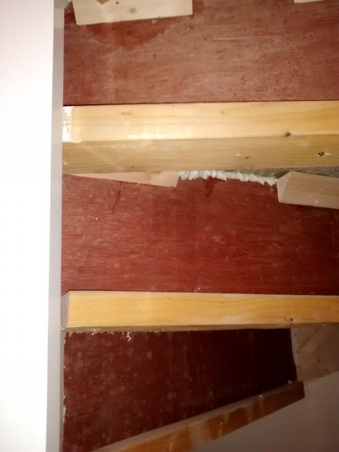

OK, some more photos, not brilliant quality as I only had my mobile with me. I can't quite make out what, if anything, is supporting the narrow end of the treads.
In particular, in this one, it looks like there's a bit of wood "almost" supporting the rear edge of the tread and riser.
And for several of them, they clearly recognise there's a problem, why else bodge on lumps of random timber ?

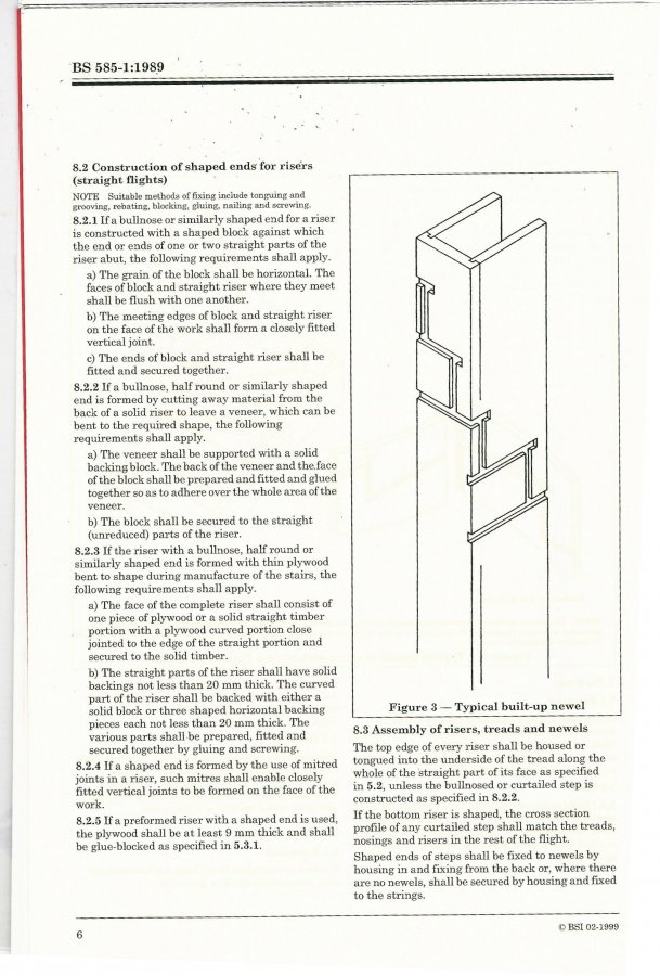

As Bob above, the winders should be housed into the newel; this is from the BS code for stairs, showing the grooves cut in the newel. (It is a built-up newel but the principle is the same for solid newels). The Code recommends min. housing depth of 12mm.

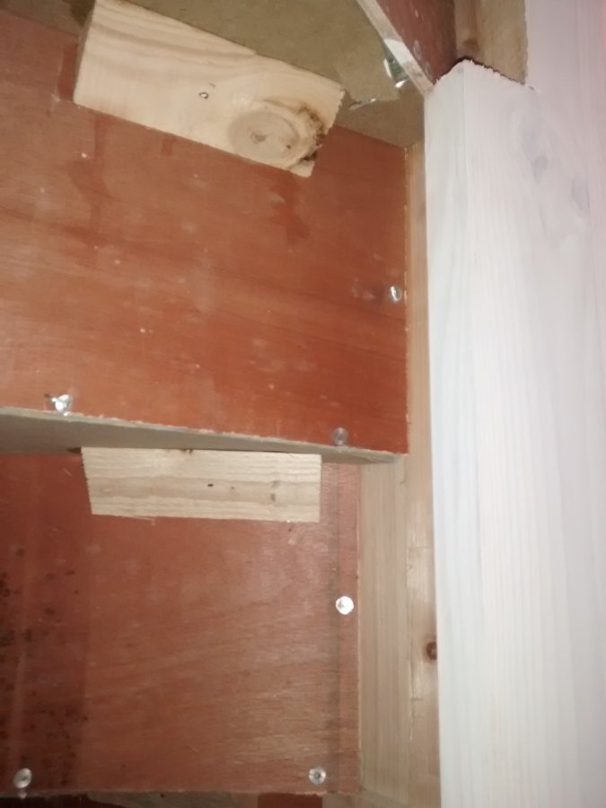

Looking again closely at the photos in my second post, it looks a bit like they added "random" lumps of wood to a straight newel post to provide support for the treads - so rather than cutting a slot, the've built up support.
