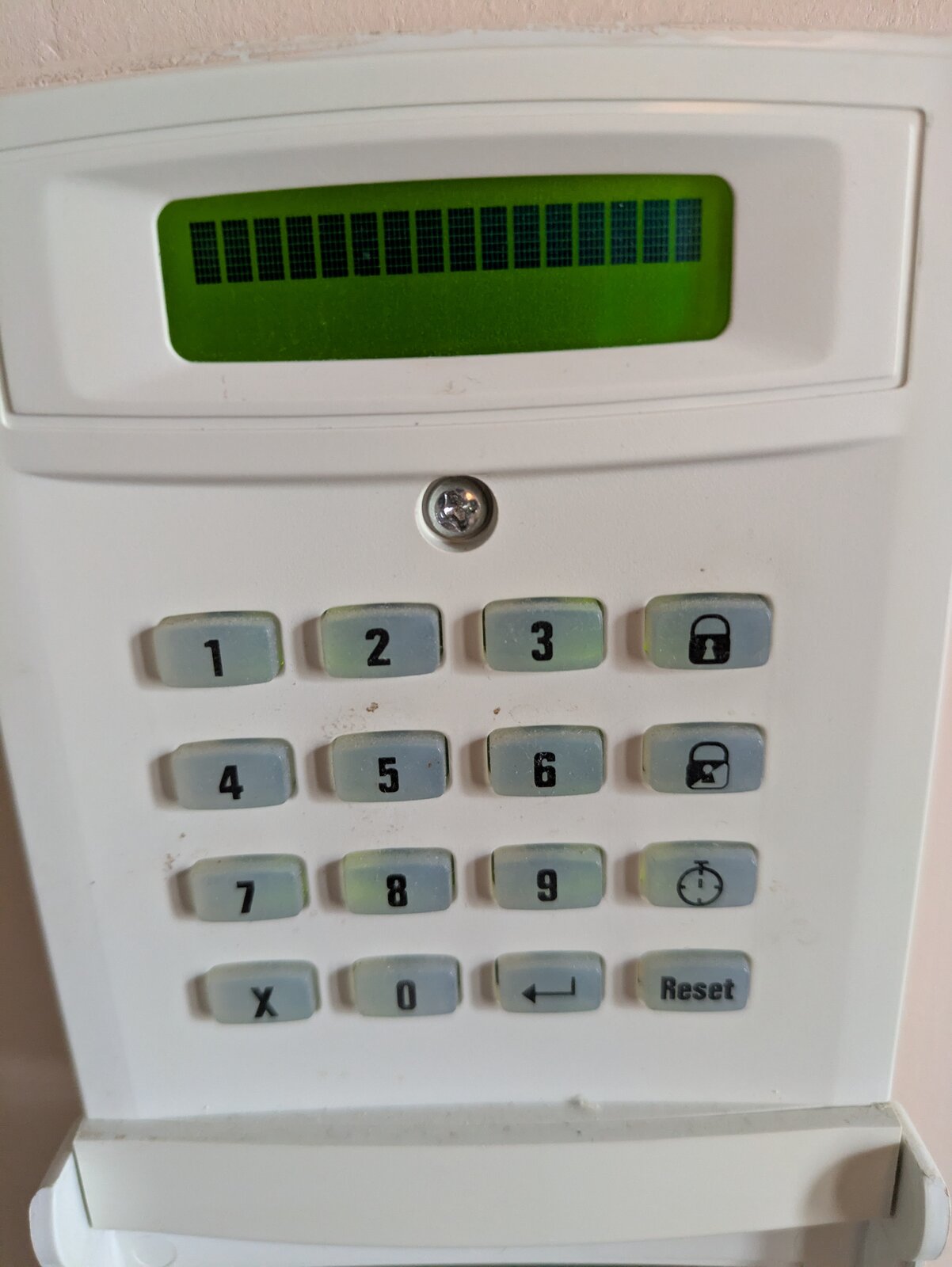

Hi - I'm new to the forum and would be grateful for any help/advice.
I moved into a house that had been empty for 2 years, only to find the fitted wired alarm system keypad showing this (pls see pic). It is a Eurosec CP8L according to the manual left behind.
What does this display mean though, as there's no message?
As far as I can tell, the control panel and pirs are all receiving power, so is it just a simple case of getting the battery/batteries replaced and the system serviced to get it going again?
Unless I'm wrong, I think the system is obsolete so might it be better to go with a completely new replacement of component parts with another brand?
Thank you in advance for any ideas or advice.

looks like a keypad failure of some kind, replacement keypads are available new old stock, I have 2 in the office for the example but these are not for sale but for customers that may need them that have this panel.
I would look t replacing as cost wise you can get a new system with manufactures warranty.
Risco last time I checked had sold out so its unlikely there be any more added to the current circulation that is new.

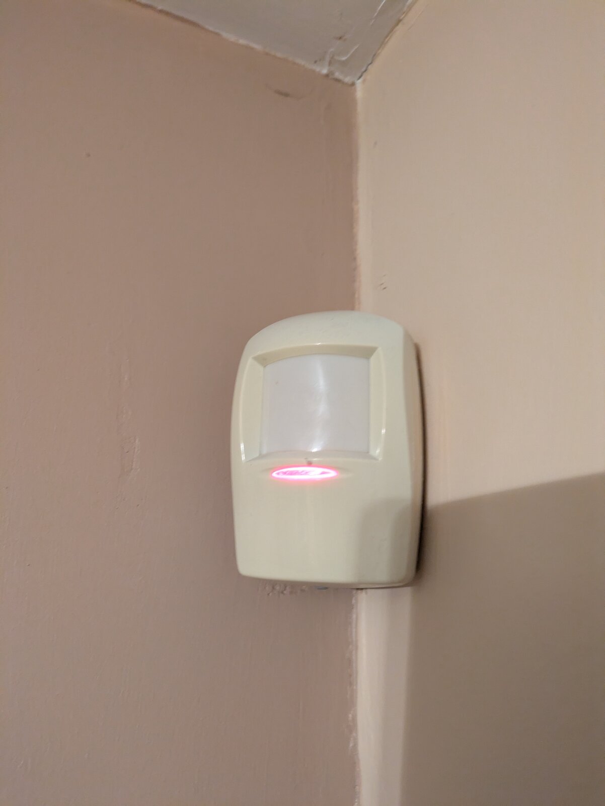

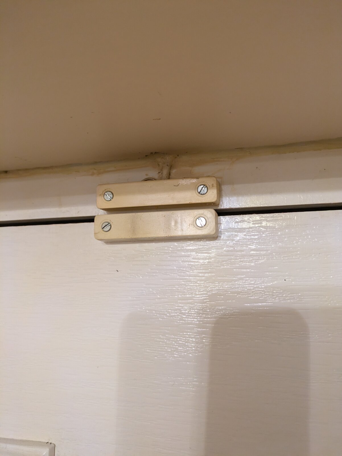

It's too dark to snap a pic of the bellbox but I've attached pics of one of the sensors and door contacts.

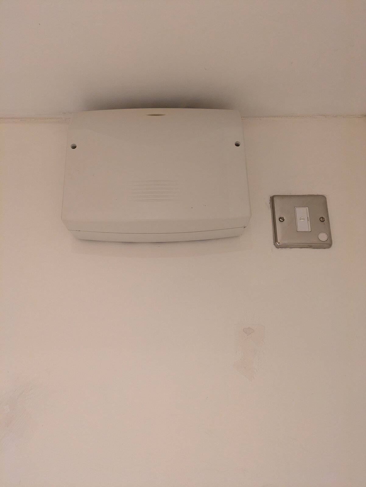

Sorry, meant to add a pic of the panel. I think the space around it for a bigger panel isn't an issue.

Just my need to double check the route of the power cable from the panel to the fused spur so you dont screw through it with another box.

Sensors look basic but in decent condition, so if they are working I wouldn't bother changing them unless you want to.

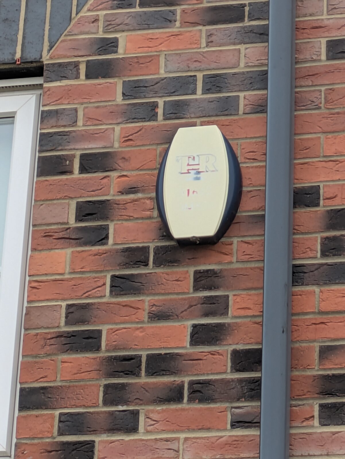

Here's the bellbox. Not sure if it works OK but I'll look to getting that replaced too and start afresh.
