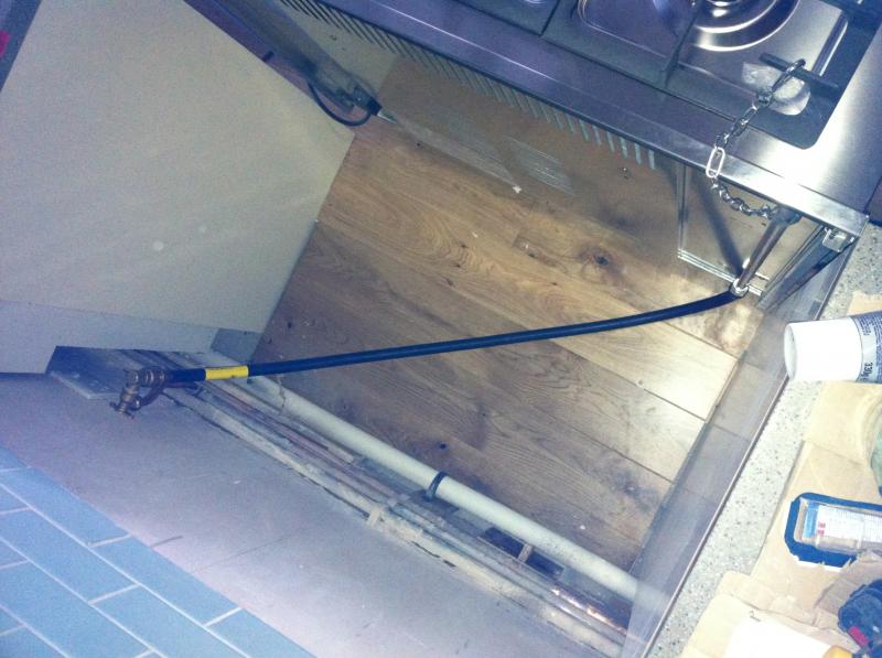

My son's kitchen! Builders in first then the plumber goes to work. We have fitted the kitchen before any appliances were delivered. He is now trying to get the cooker in place and we have BIG problems. With all the pipe work and no recess on the cooker, it's going to standout about 75mm and leave a big gap at the top.
Are we looking at trying to channel those pipes into the wall?
I have added an image of the problem for all to see
This is the problem.

I've never seen a cooker with enough of a recess to take a waste pipe...
OK, hindsight and recriminations aside...what is behind the wall? What sort of wall is it?
It is probably the only solid wall in the house, breeze block and plaster oOh had it been dot and dab plaster board those pipe would be away by now.

1. Re-site power point well clear of where it is and re-run gas outlet into gap behind other unit. Won't be much help if ground level pipes also a problem.
2. Get rid of cooker, install gas hob and electric cooker. Many electric cookers (not hobs) will run off a 13A power socket.
3. Replace cooker with one with sufficient gap behind.
I appreciate changing the cooker isn't a cheap option, but it might be cheaper than a lot of building work.

buffer's idea of dabbling around with a new hob and oven may be the way forward. However, what's on the other side of the wall? If it's external then although its a ball-ache the pipework and waste could be routed through it. :confused:
So is it OK ie Gar Regs to have the gas outlet behind another unit? This is the first main headache as it sticks out about 3 inches.
Brand new 900mm cooker and fitted Earthstone worktops so extra expense in this area would be a last resort.
It is an outside wall but in a terrace of houses so going external is not an option.
Do you think there is enough flexibility in the pipes to try to channel out behind them and then hold them back in the channel.
Oh forgot to mention the new wooden floor has just been fitted throughout, just to add to the problems!
I'll leave the gas question to the gas pros (although my guess would be that providing easily accessible access is maintained, one would wonder why it would be a problem. But regs are regs :confused:)
As for channelling - there is a limit to the depth of brickwork that can be removed.
What's the problem with taking the waste pipe outside? if needs be, you could always just route it over the width of the cooker, making sure that you use some access covers for the stretch of external pipework. Far from ideal, for several reasons, but desperate times.... ;)
Sadly the initial kitchen design was done by B and Q, the washing machine being as far from the outside waste as possible but we did have ""their best kitchen designer"" on the job - alarm bells!!
The idea was to run the waste pipe below the base of the units in the space under the units. This was fine right up to the point when the cooker was unwrapped and we found the legs literally in each corner. They may still squeeze in.
The biggest and first issue is the gas outlet.
Then the pipes are fixed in clips and mounted on the plaster. I hope an inch maybe gained here. If that's not enough then we may have to attack the block work.
How can you find out if a cooker has a recess apart from trying to find a display model!!
Your gas connection for the cooker is only a problem because it's badly fitted, done correctly it would be much tighter to the wall and I suspect your problem in that area would be eliminated.
My thoughts;
Cookers get HOT,
Plastic waste pipes do not like to to get too hot
I would NEVER run a plastic waste behind a cooker as it's a receipe for disaster! :confused:
