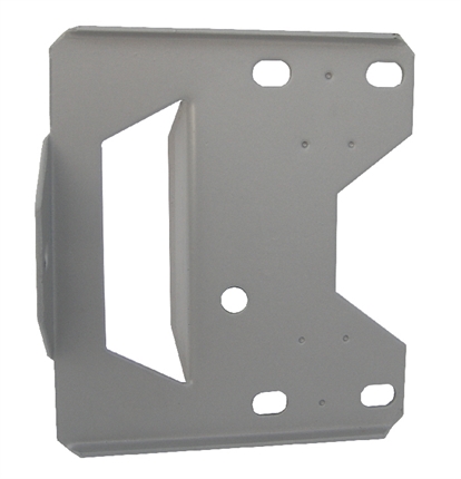

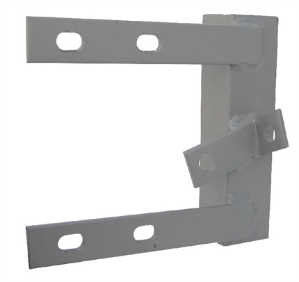

I see these 6" brackets welded brackets..............................and these 6" pressed steel ones far too often trying to support some huge sail of an aerial on a 6ft or 10ft pole. That's a bad choice.

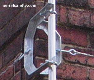

A big aerial needs a big bracket. An 8" mitre cradle really is a minimum.
Better still, change the bracket and fit an aerial with a far-lower wind loading. Log Periodic aerials are becoming far more popular because they work far better than the Wide Band High Gain at the lower frequency ranges on which many of our transmitters are now running.
