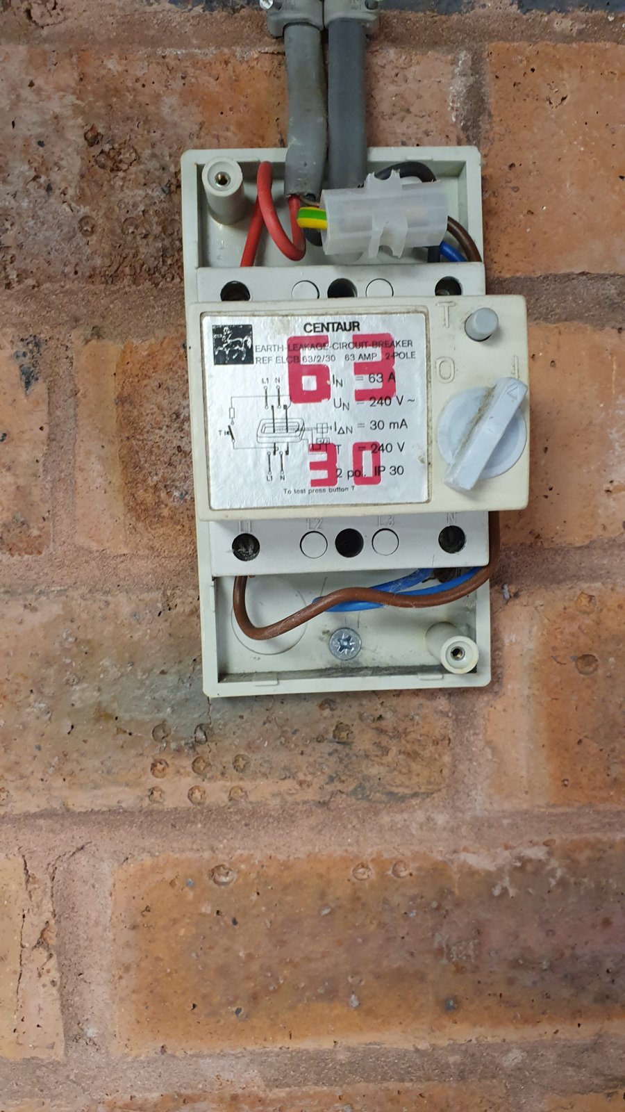

Afternoon all,
My garage currently has a 2 gang 13A socket and I'd like to add a second. I've scoped out the current setup, and it seems a bit iffy to me and wondered what any professionals think (before I get one to physically come out)...
The supply to the garage (attached to the house) is spurred off the CUs 'downstairs sockets' ring. It's worth noting the garage strip lights are fed from the 'upstairs lights' as well. This initially sounds odd as I would have expected there to be a dedicated supply for the garage with its own CU.
So, this supply entering the garage for the socket goes into an ancient looking ELCB. The ELCB is currently only using one of the three outputs (see attached pic), so I was planning on just using the 2nd for my extra socket.
Reading online, Ive learnt the ELCB has to be replaced to meet today's regs, and Part P allows for certain things to be done without needing to notify/certify. It says you DO need to notify if installing new circuits ... But what about replacing the ELCB with an RCD?

That is a current operated device, and does the same thing that a modern RCD does. It is not one of the voltage operated devices which have been obsolete for decades.

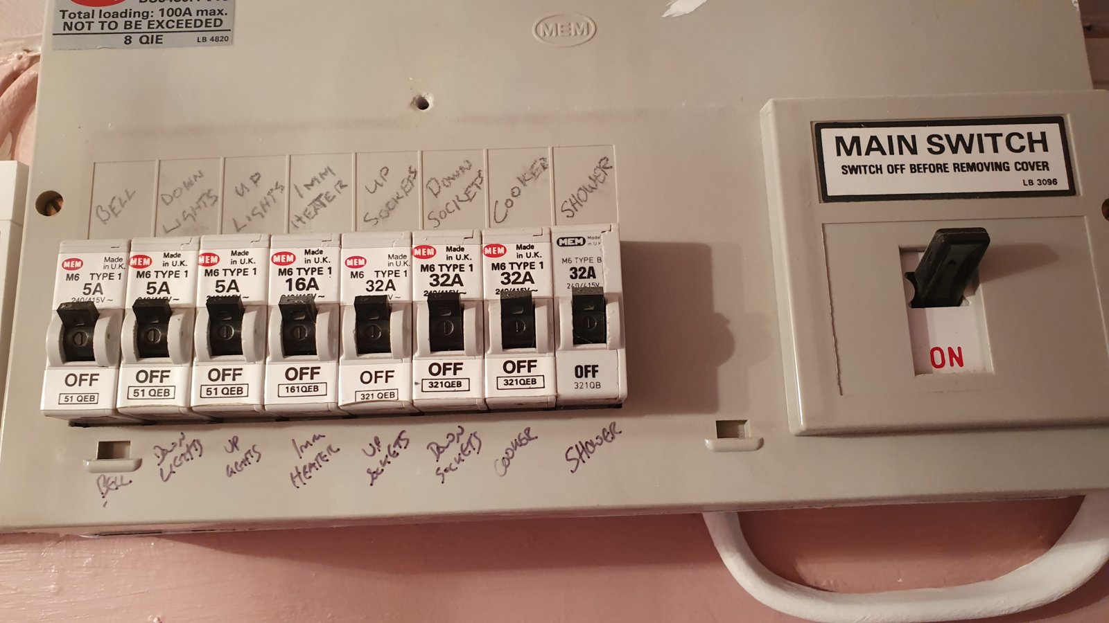

Is there an RCD for the supply - in the main consumer unit?
Hi flameport
Ah ok, I must have misread online. The main CU has a 32A circuit breaker (specifically a MEM 321QEB) which supplies all of the downstairs sockets and the garage. I don't see an RCD anywhere in the CU.
Mike

some people will say you shouldn't have a spur from a spur.
So you could replace that item with a modern 2 way cu with RCD and 20A MCB.
leave the lights alone, That is fine

The ELCB-c you have is a three phase version, however there is no problem using it on single phase. As to spur from spur if the spur is fused there is no problem, what is to be avoided is having 32A available from a 2.5 mm² cable, there is nothing in your post that point to that being the case.
If there is no fuse and you replace the ELCB-c with a double pole RCBO of say 16 amp it would not in theory be correct as a fused spur should be fused to 13A but it would ensure you can only draw 16 amp so it would make it safe by just renewing one item. You can then add as many sockets as you like without there being a problem. The way I have done it in the past is to replace the first socket with a grid socket and fuse, and plate and blank so the 13 amp fuse is protecting all, then you can add as many sockets as you like.

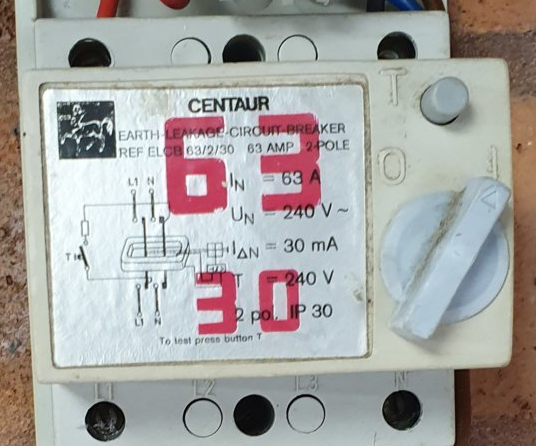

It doesn't have 3 outputs. There are 2 wires in for the supply, and 2 wires out for whatever is connected to it.
Assuming it's working, replacing it with another RCD will achieve nothing.
Far better to put that money towards a new consumer unit in the house, which has no RCD for any of the circuits.
RCDs are required for virtually all circuits now, and RCDs have been required for socket outlets likely to be used for equipment outdoors since 1991.
Sorry saw the L1, L2, L3, N did not see the blanks in L2 and L3.
It's not just the 'clue' of the blanked L2 and L3 - if you look just above them at the label, you'll see a clear description of what it is :)
