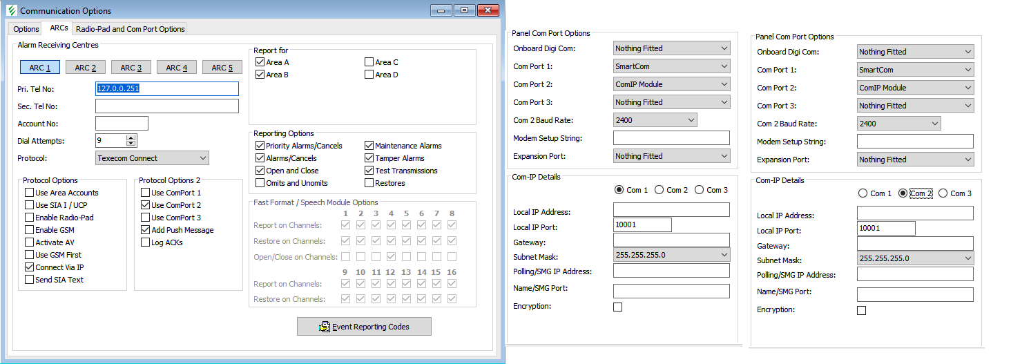

Please can you elaborate on your configuration. I too have a SmartCom and connect to it using WinTex, but would like to connect to it using the IP address (as this may lead to other things I want to try in future). I can not connect to the SmartCom via it's IP address on com2 though. How did you disable signalling as suggested by secureiam? Thanks
The issue is that com 2 sends out signals and the panel cant do both at the same time, if you connect via IP it will need either port forwarding or connecting to the internal ip address assigned which will be the ip address showing in your router for the smart com.

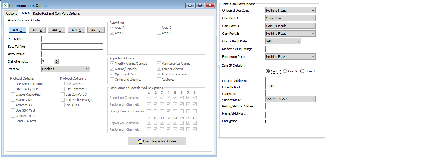

What I really want to do is learn about this system in order to integrate it in to a home automation project. I currently have a Premier Elite 64-W installed with a SmartCom. Everything is working perfectly, I can use WinTex to program the alarm and I can use the Texecom Connect App.
If I understand things correctly, what I could do, and what would be the best solution, would be to install a ComIP module on com3 (by connecting the ComPort+ board supplied with the SmartCom to the digicom connector). However, I don't really need the SmartCom/TexeCom Connect app and would like to avoid the expense of a ComIP module.
So what I would like to do is use the SmartCom as a ComIP module only. Many people seem to suggest this isn't really possible because the com port of the SmartCom is always used for signalling. However, your previous post suggests that configured correctly (i.e. disabling the SmartCom aspect) it is possible. I just can't figure it out :(
I have attached WinTex screenshots of my working SmartCom configuration. Any guidance on how to disable the SmartCom and enable ComIP IP address access would be appreciated. I will post other screenshots of configurations I have tried shortly.

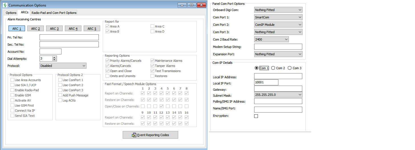

While talking this through and preparing screenshots, I think I may have found my issue. I was specifying the wrong IP address. It's always the simple things. I disabled the ARC1 protocol to disable signalling, and explicitly specified the SmartCom IP (as currently issued by router) to Com 2. New screenshot attached.

I am still trying to fully understand the purpose of the SmartCom to be honest. I don't think physically rewiring the smartcom is necessary as the Arc can be disaaled leaving com2 available for ComIP communication.
The way I have it set up now is as per my most recent screenshots, so the ARC is disabled. I can still communicate with the panel using WinText via SmartCom. What I will be losing is the 'signalling' (notifications?) to the app and the cloud (?). As this is a domestic stand alone installation losing notifications sent to the cloud is not an issue (I don't have a subscription to Texecom Cloud yet - it's free for 12 months right now - so going to try it). And the app isn't great so no loss there either.
