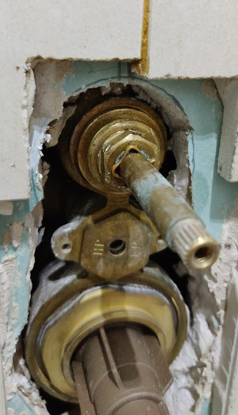

Hi folks,
The cartridge on my shower tap has seized up after about 10 years of use. So the plan is to fit a new one. However, the old one simply is not budging. I sprayed on some WD-40 but it won't twist at all (attached pic).
I read you shouldn't force it by twisting too hard. Is this true or do I simply apply more elbow grease with my spanner?
Any pointers will be most helpful. Thanks all.
James
Some of them have a grub screw (usually 2.0, 2.5 or 3.0 mm Allen key) in the underside of the body to keep the cartridge from unscrewing. Use a small mirror like a dental mirror, and a torch, to see if that is the case. If you know the make and model, look up a spares exploded diagram.
Try it tomorrow morning....................after you have had 3 shredded wheat.
Or ask a teenage boy, they normally have a good grip.
Andy
Thanks guys...sorry I mean the control valve (top valve in the pic) which controls the flow/on/off of the shower.
There aren't any grub screws holding it in place. And may have to try the shredded wheat at this rate! Ha.
