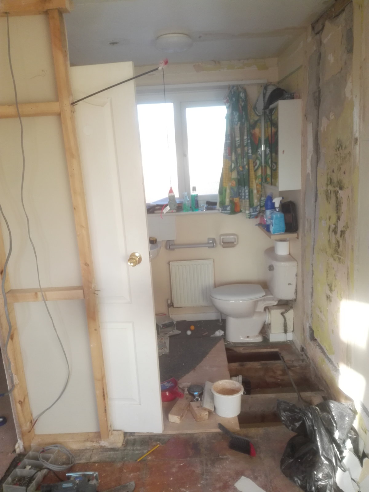

I have an en-suite that is 1.6m by 1.7m.
I need a non-slip tray, so will go with a low level Mira Flight Safe. The enclosure (if a quad) can be a maximum of 900 x 900, but I need a grab handle to get in and out safely.

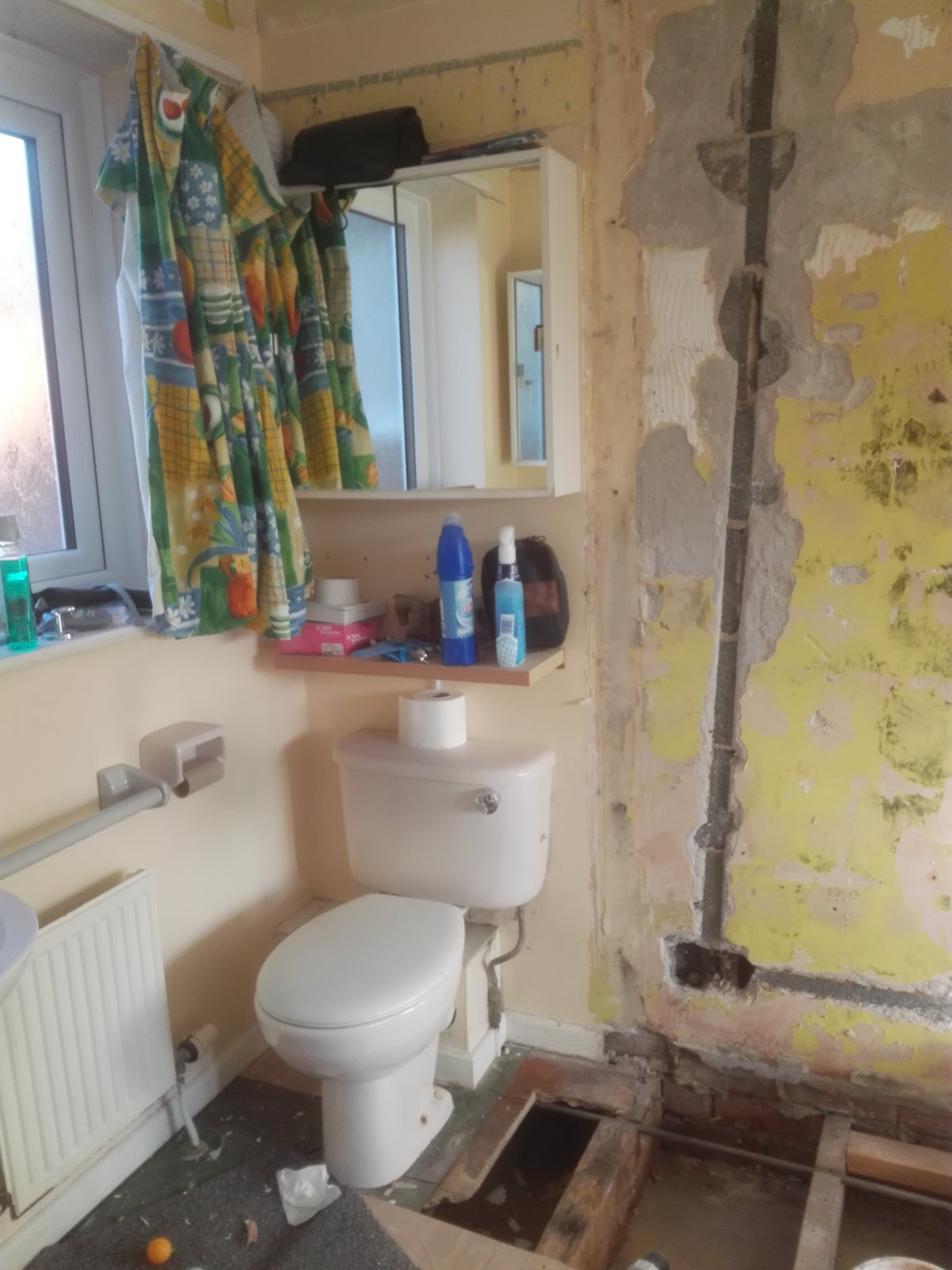

Can you take pictures of your existing. I do this sort of thing alot I may be able to suggest what's good
Ah. The existing is sadly demolished, but I can get pics of the space.
The room is 1.7m down the window wall and 1.6m the other way.
To the right of the WC was a 700 shower tray with a stud wall separating it from the WC.
The dividing wall to the bedroom we had to demolish as it was rotten from a long-standing leak. The floor too was affected. The area near the tray was soft but the floor in general is swollen and uneven and the damp even extended to the other side of the wall under the wardrobes in the bedroom...
The original plan was to put a 900x900 quad in, but I feel I will need (if not now, later) something to grab onto as I get in and out of the shower.
And yes, there WAS a double socket behind the tiles inside the shower tray. And the water was seeping behind....:eek:
Edited to add text.
If I got the en-suite extended out into the bedroom where the bin bag is (and halfway down the removed wall, essentially taking up part of the space where the wardrobes sat) then we could get a 1400 x 900 tray in, but I'm not sure how that plan would work with an enclosure, because part of the tray would be in the recess.
