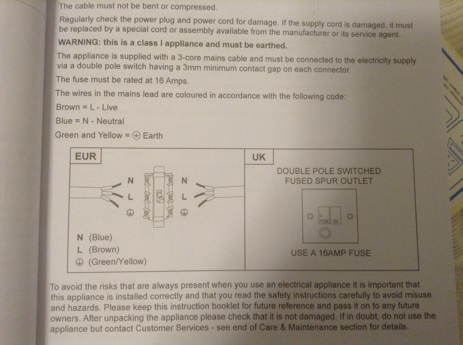

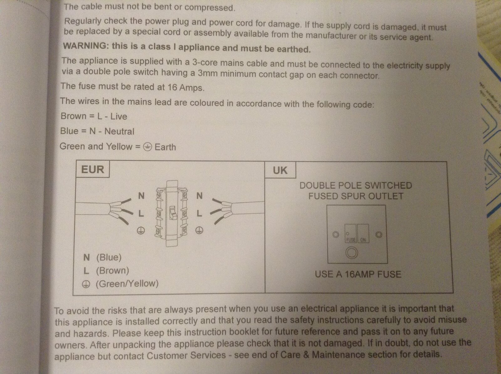

A problem with shower isolators is people will insist on turning them on and off every time they use the shower instead of say twice a year when they go on holiday. This is not helped by shower manufacturers incorrectly saying they should do this.
Go away with your manufactures are incorrect nonsense. It’s boring and nobody cares.
It is not nonsense. It is frequent and people should care if the errors are dangerous like this one you will have seen before.
