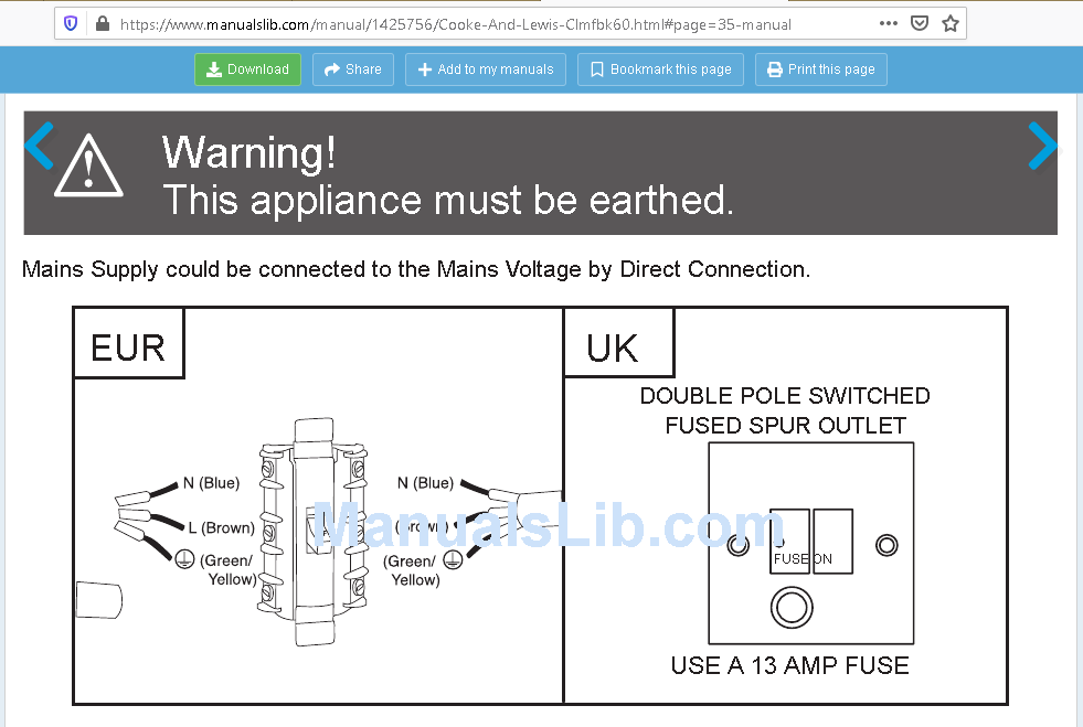

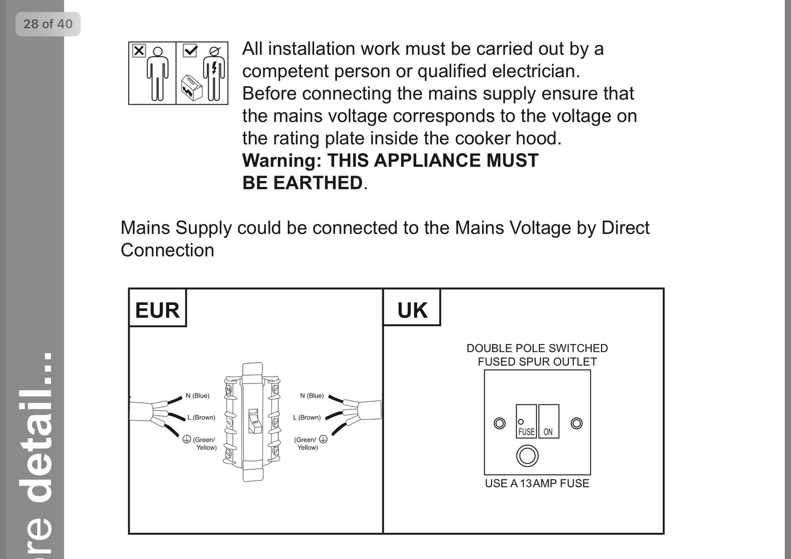

It is not nonsense. It is frequent and people should care if the errors are dangerous like this one you will have seen before.
Great news everyone. Cooke and Lewis have spotted their typographical error and have corrected it, so we can all go back to following manufacturers instructions now.
