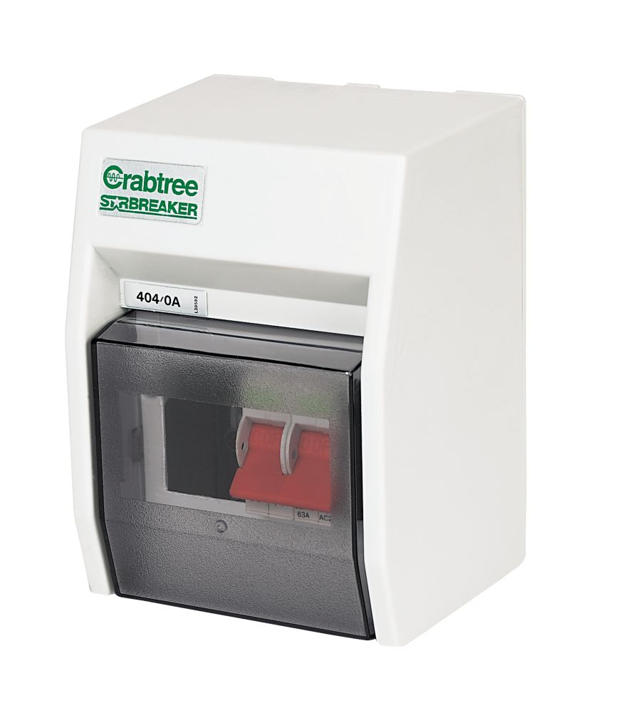

With a 6amp and 45amp MCB, placed AFTER your pull cord, in the airing cupboard or similar.

Surely another 45A mcb won't be necessary or desirable.
You will get posts about dedicated shower circuits.
I guess a further 45amp MCB is not required. Fit a flow switch, it's a completely seperate system then.
