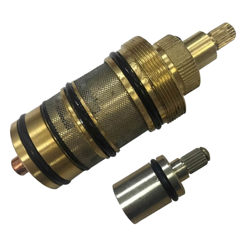

That's not a deck mixer, that's an exposed thermo shower, same issues as far as narrower waterways and a thermostatic cartridge are concerned being restrictive to flow.
Anything that isn't compression type/screw down valves with full flow pipework will be restrictive in a gravity fed setup. It's just the nature of things unfortunately. The only other option would be to install a bespoke wall mounted setup where there were the 2 hot and cold taps/valves with a diverter to port the flow to either a bath filler spout or up to a shower. Even then though you need to ensure the diverter and shower head isn't restrictive to flow @ low pressure either.

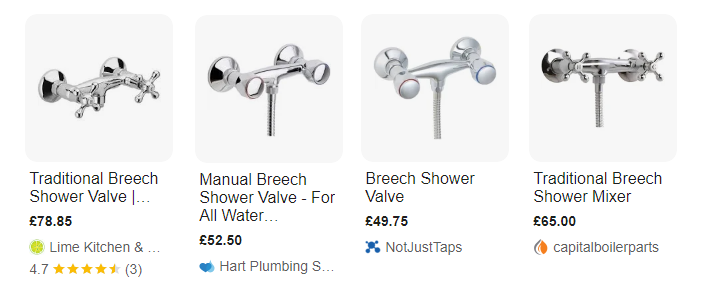

Am I in luck, or am I still wishful thinking? While thrashing around, I found these. Any reason why these won't work? These would resemble the deck mixers.

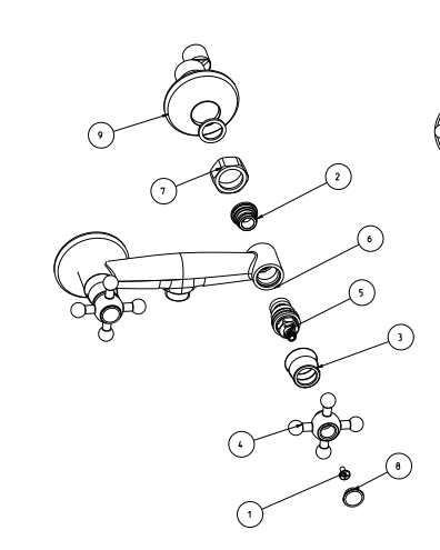

A typical breech mixer diagram suggests there is no complex restriction in the mixer.

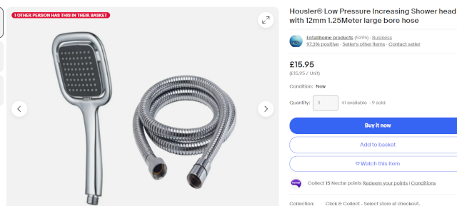

They may do yes - certainly look like a free flowing design and as there's no thermostatic valve to go through then they would certainly flow more. Only compromise is no auto temp control. Don't forget widest possible shower hose and hi flow shower head too.
Doesn't the shower hose come in one size? The connector on the valve looks to be only one size.
As far as the end fittings are concerned then yes - usually all are 1/2" BSP - as far as the internal diameter (ID) of the actual hose is concerned then nope. Largest ID I've found are the MIRA hoses.
