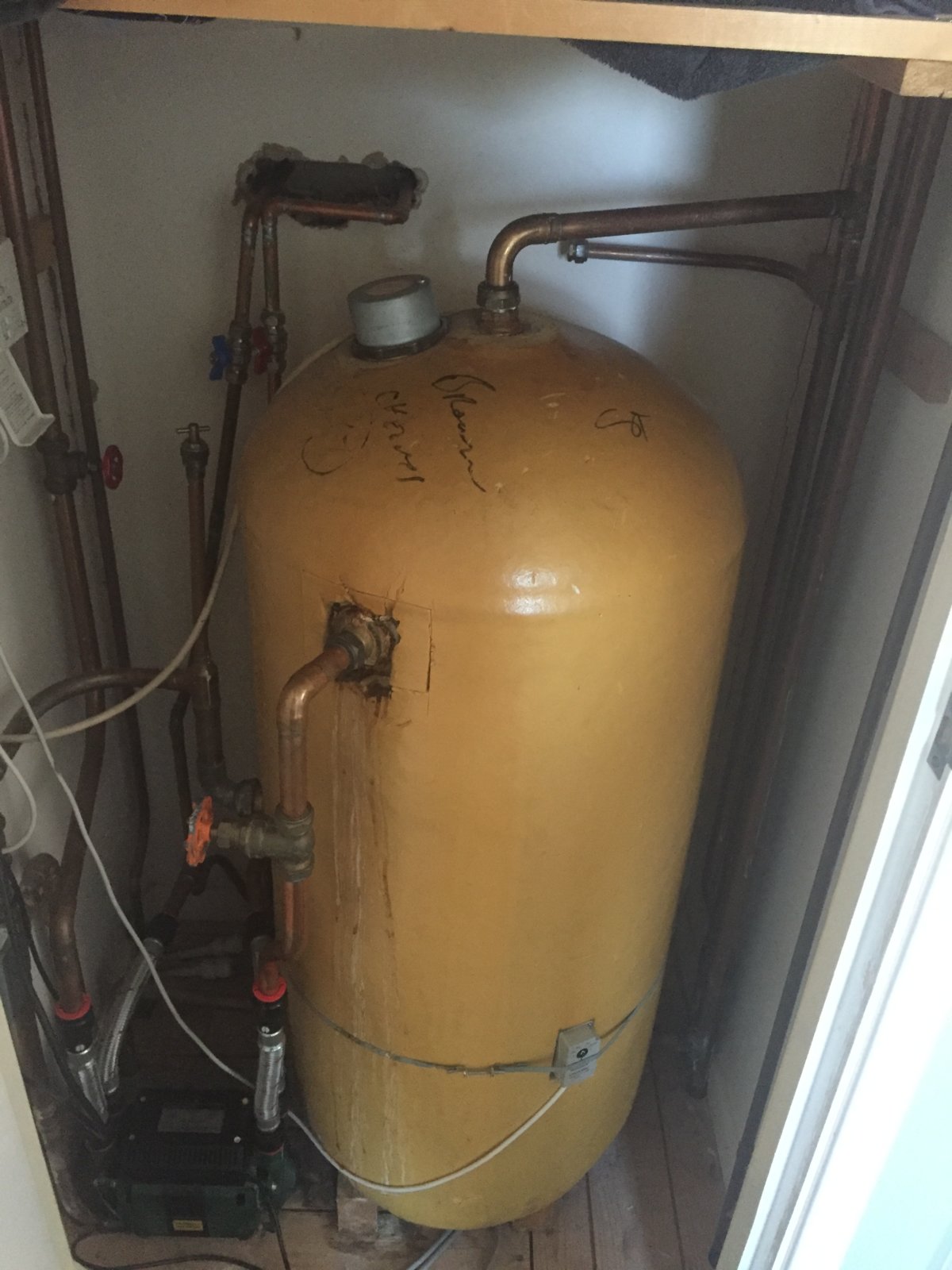

You do know that the white plastics slot has to be one quarter turn ,so slot is across the pipe ,not in line with it ,to be fully off ? That's very odd that all 4 don't work ??
And what type of isolation valves are on the fixed Pipework ,gate valves by any chance ( big round red handles )?
