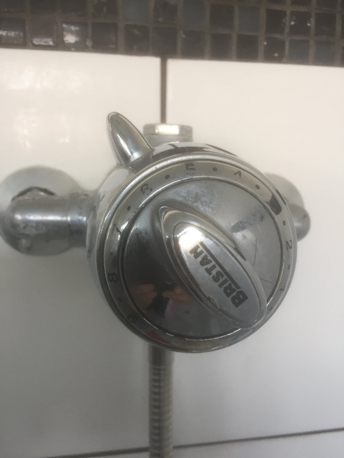

Hi, I turned the shower on this morning and there was only a trickle from the hot water. There is usually a surge and then there is pressure. Has the pump stopped working or could it be something else?

Need more information than that
What kind of shower?
What kind of pump?
Is your hot water gravity fed?
Are you getting your usual water pressure from other hot water outlets?
Hi, it is a Bristan mixer shower. Hot and cold water running as normal. I can’t find any pump and have looked near the hot cylinder and in the loft. When you turn on the shower it sounded like the pump is under the bath and the panel is tiled. I will have to remove the panel to investigate. It gravity fed.

This is the mixer

Is the pump making any noise?
Check to make sure its hasn't been unplugged / switched off before damaging tiles.
