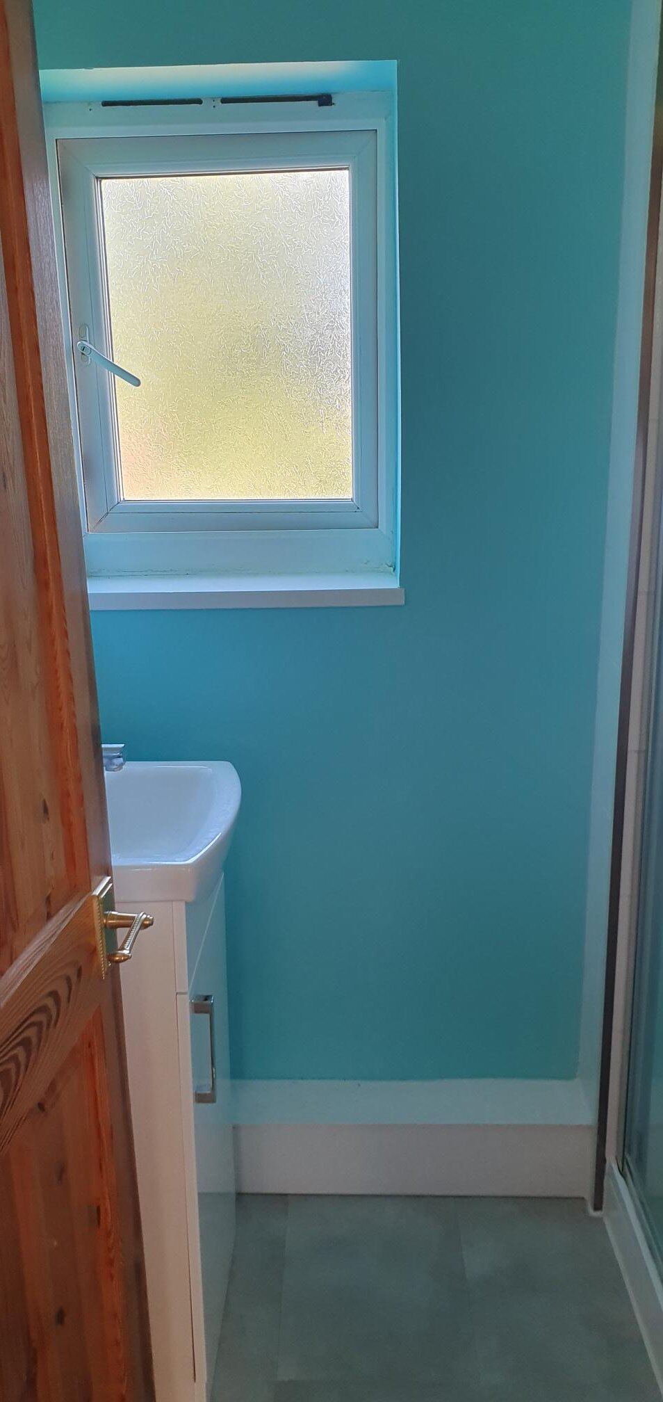

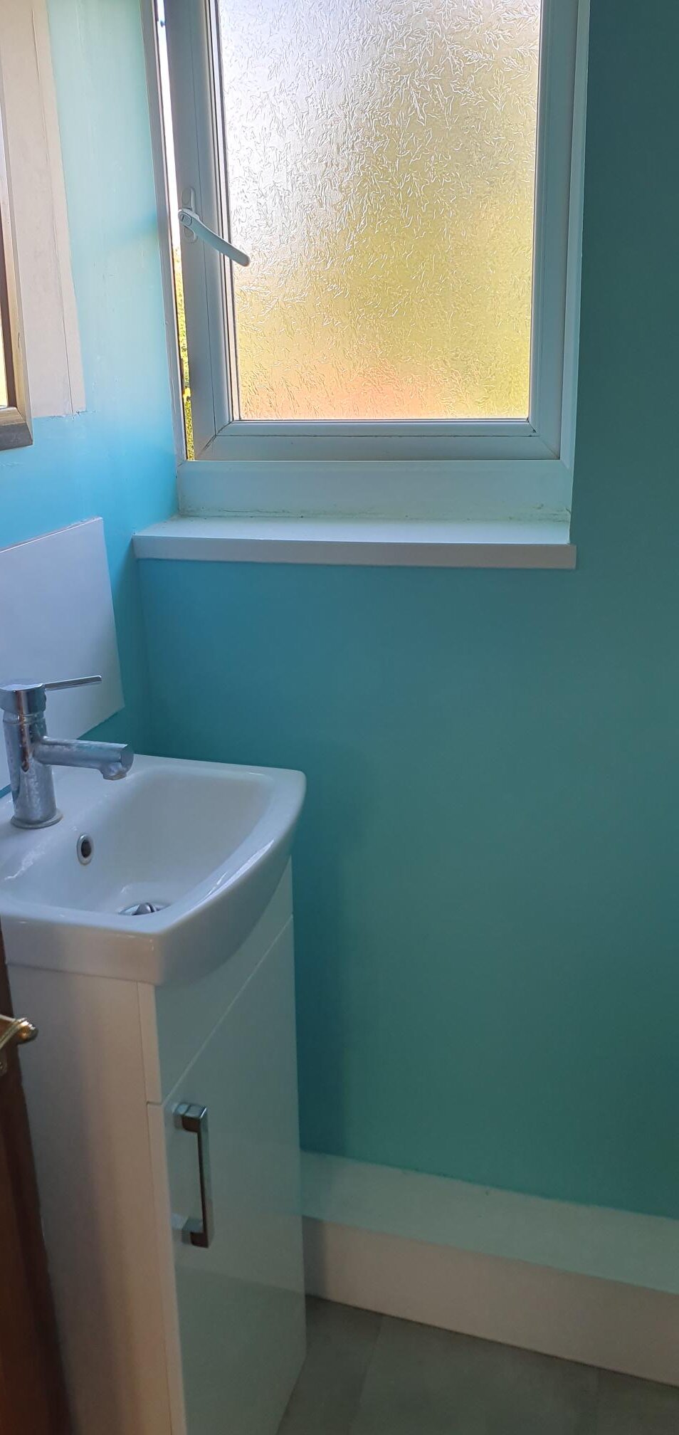

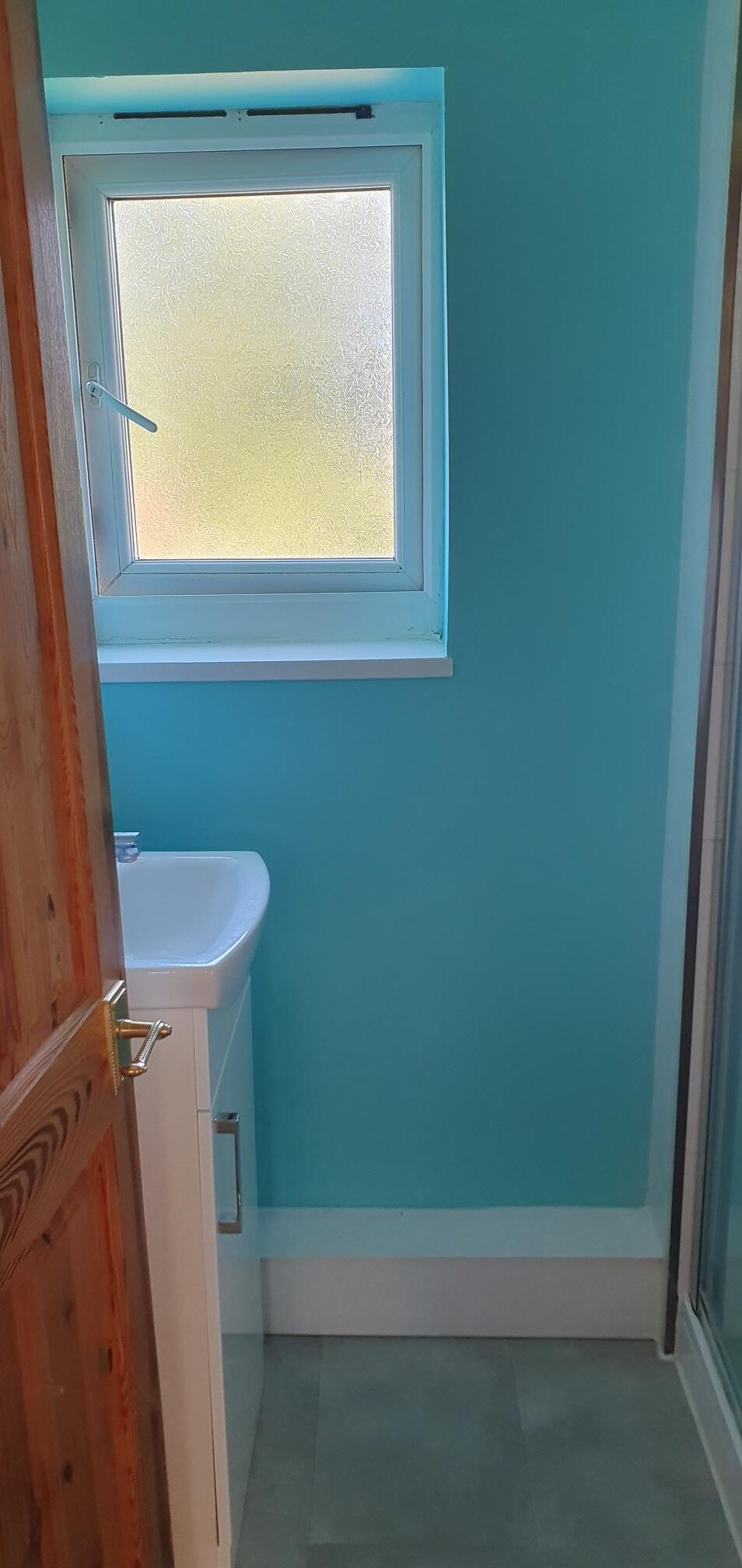

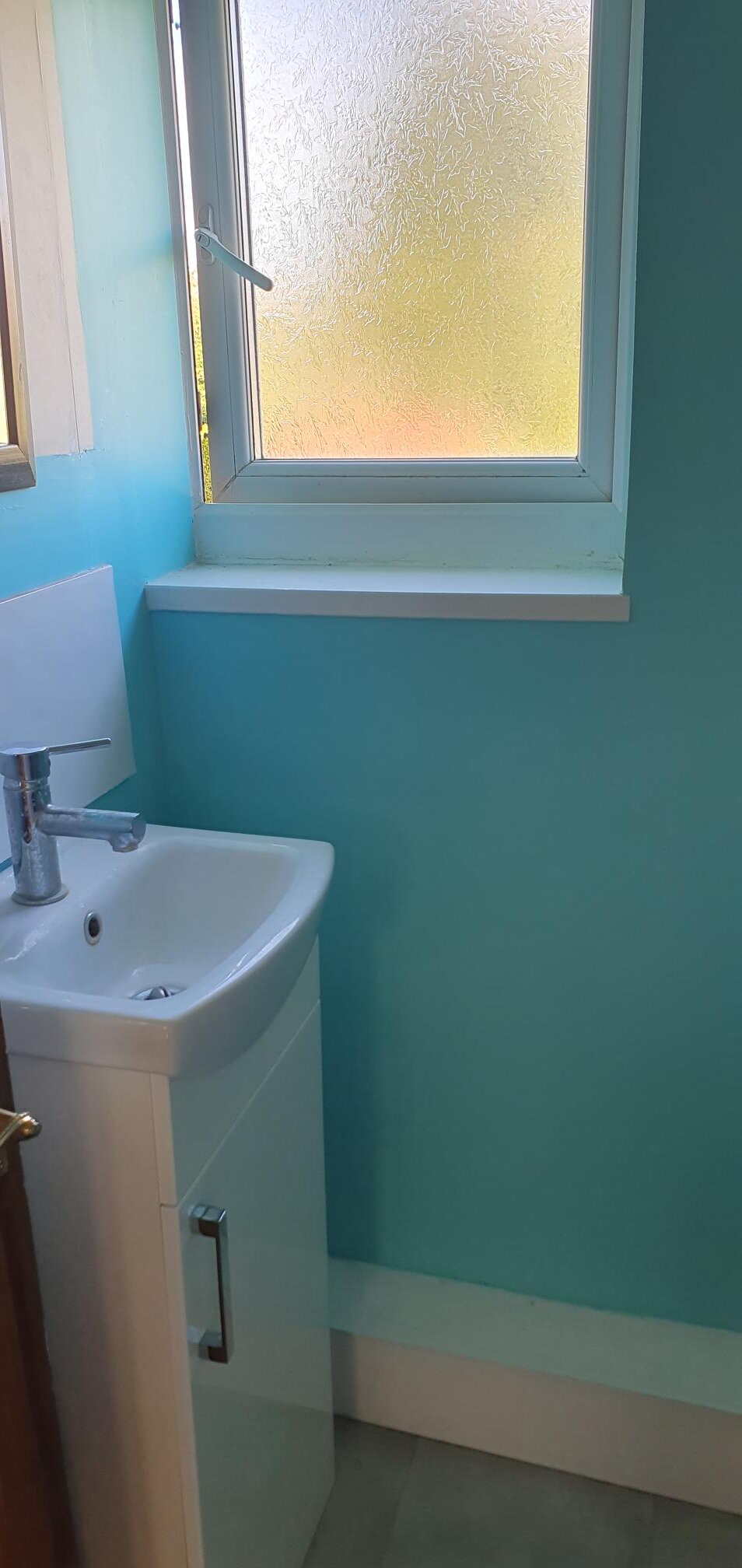

Replacing a basin that was put in as a rush job but space is very limited. Needs to be as big a bowl as possible as it's the only bathroom so more than just a cloakroom hand-rinse (toilet is in a separate room), and as 'splashproof' as possible as it's a rental.
Options:
* same location, wider rectangular basin with right-end tap (hard to find anything which makes use of the width available without being too deep)
* corner unit (not sure if an oval bowl will end up smaller than the above option)
* rectangular basin under window (biggest space but awkward standing by the door/have to shut the door to use it, and much harder to reach the window to open it)

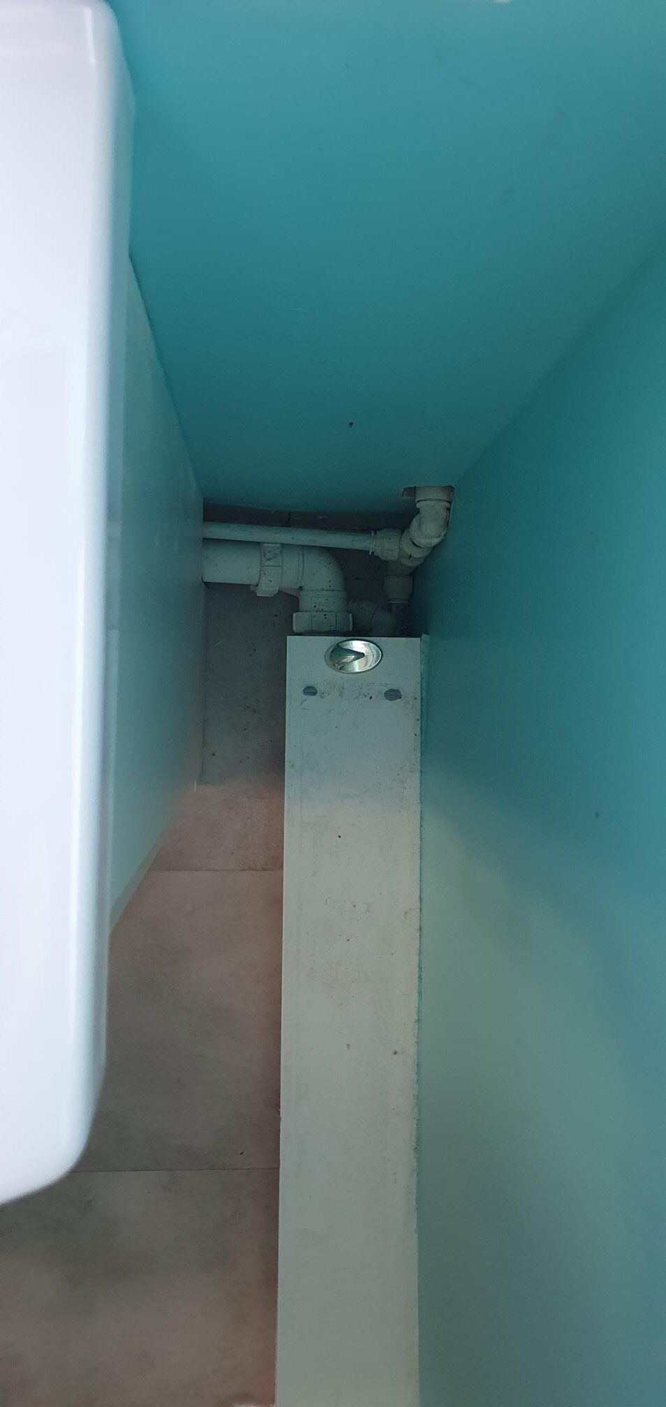

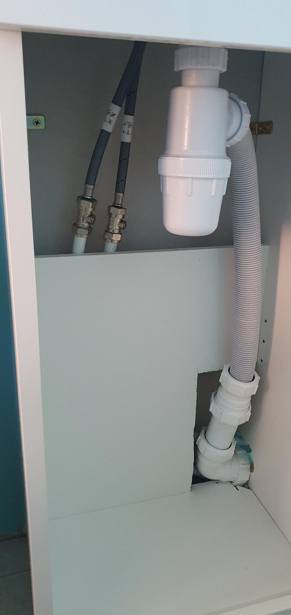

Attached pictures of the space and existing plumbing (the boxed-in pipes run to the shower on the right). Minimal disruption desired! Current basin is 400x330 max.
Thanks for any thoughts.

Most people would want a mirror over the washbasin which rules out under the window. You will need to give available dimensions to get meaningful advice
There is a mirror immediately to the left. I expected people to value a larger basin over ideal mirror placement but maybe I'm wrong. The under-window option is my least favourite anyway though.
I wasn't looking for advice on what will fit in the space, just whether those 3 options are even feasible with the current plumbing and, any general views on positioning.
I would fit a pedestol basin, that avoids the inevitable damp cabinet issues. As above post a sketch of the plan of the room with dimensions.

From a day-to-day use perspective, I’d prioritise basin size and comfort over perfect positioning with the mirror. I’d stick close to the existing layout and maximise basin size within that footprint—it’s the least risky and most practical option long-term.
