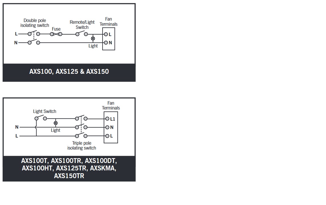

Thought it best to make a new thread given that some of the circumstances have changed, this new thread continues on from the following:
So I installed a replacement fan - the original was a Greenvac Airvac AX100T, I bought what is advertised as a direct replacement, the AXS100T
Do bear in mind that the original AX100T used to switch on via the light switch, so the AXS100T, as a direct replacement, should also do the same ...... yet it doesn't. It DOES switch on via the pull cord (the original also had a pull cord switch which worked), and prior to that when I flip the light switch the new fan does briefly turn but then stops.
There is a fan, the AXS100, which is NOT stated as being a direct replacement for the AX100T (it's instead a replacement for the NDX100B). but that one IS advertised as "Remotely Switched".
Also bear in mind that the lights in the shower room are three small 12 volt spot bulbs with a converter of some sort in the attic.
So I'm puzzled - I can't work out how the original fan worked just fine from the light switch and then stopped doing so a few years ago. And also, even though it's not advertised as being a 'remotely switched' fan, why the 'direct replacement' won't work in the same way.
Note that the electrical terminals inside the original fan are marked L, N and SL (there's the stub of a wire in the SL terminal and in the electrical cable (Red, Black and a bare wire for Earth) the bare Earth wire is just a stub and it's a lot shorter than the Live and Neutral wires).
Is it possible that the unused Earth was wired as some kind of Switched Live ? Surely not? If so, perhaps it corroded and broke off?) I didn't see any piece of spare wire though).
The terminals inside the replacement are L, N and L1. I've not used L1.
The instructions for the replacement (which also cover other models in the range) are available in the Downloads area of the following page of the manufacturer's web site:
I'm also now wondering if all of this is safe. It's been wired this way for over twenty years. Perhaps it's time to find a local electrician to take a look?
L is permanent live. Never goes off unless you have a isolation switch. This powers the fan after the bathroom light is switched off.
L1 is the switch wire. This lets the fan know when you turn light on and off.
N is neutral
Earth is earth.
So you need both the permanent live ( on 24/7) and a pull switch live.

Prior to me bridging L and L1 I've been looking at the wiring diagrams for the new fan (AXS100T). It's interesting to note that the other fan (the Remotely Switched AXS100, which I don't have), if wired up with double pole isolating switch, needs a fuse on the live connection.
However with the fan that I have, if using a triple pole isolating switch, no fuse is required.
I don't know what type of light switch mine is.
Here's the two relevant wiring diagrams from the fan's installation instructions:
