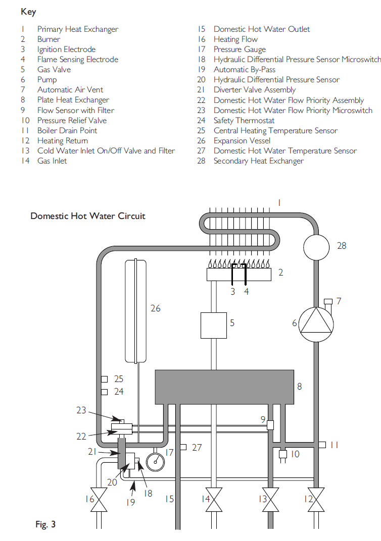

Combi is a Baxi Combi HE30, all major parts replaced last year by Baxi. Anyway it's bloody lucky I was doing the hot water temp test because on entering the loft I saw we had a mother of all leaks coming from underneath the boiler, I had an empty storage tub under the boiler which was almost full! So if nothing else cheers lads.

The cold feed which enters the boiler, in turn gets heated and comes out of another pipe to give you this heated water (hot water). The cold feed will have an isolation valve and the hot usually doesn’t, and it should be 15mm, so thinner of the several pipes underneath
Fix the leak, or get it fixed if you’re unable yourself.
If doing the Xover test, the cold water inlet is probably item 13.

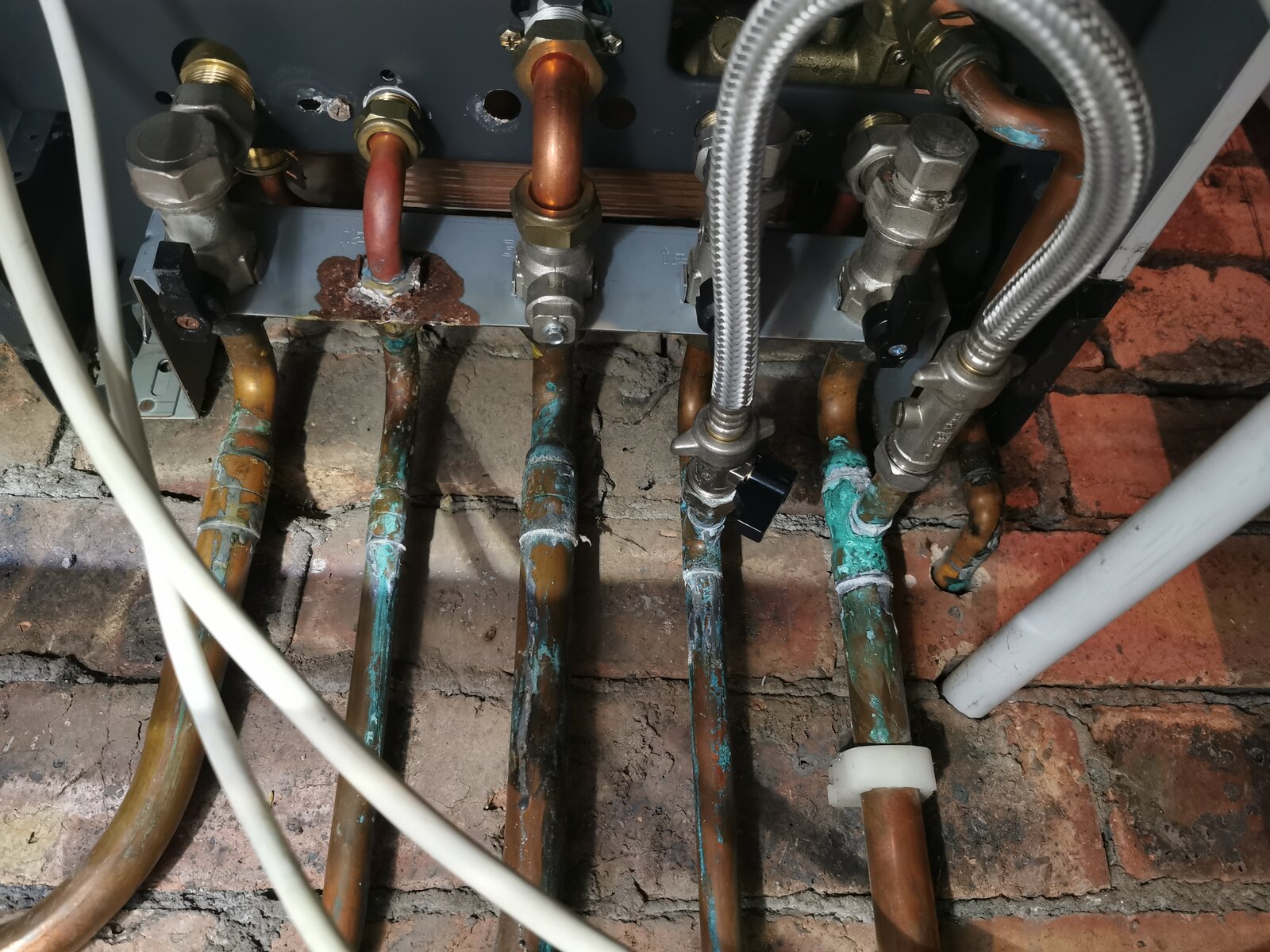

I turned off the water to the boiler (I'll attach a pic, I turned the off where the silver flexi-hose is) and the shower continued to run.
It’s the one above the braided hose on the boiler. If you turned that off and the shower ran (opening hot side only) then I’d say you’ve found your culprit
It’s the one above the braided hose on the boiler. I feel you turned that off and the shower ran (opening hot side only) then I’d say you’ve found your culprit
I turned both off (one then the other) but the one on the boiler was super stiff to the point where I thought I was going to break the plastic handle thing on it.
The culprit being the diverter valve? How is the rainfall shower still working good?
I reckon we need a new boiler at this point.
