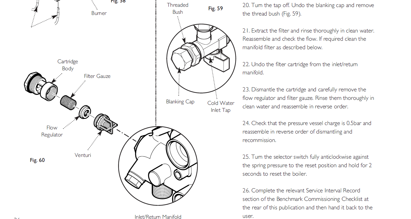

Your boiler may only be able to modulate to a minimum of 11.0kw, if so, then (from mains at 20C), a minimum flowrate of 7.8LPM is required. You might try increasing the DHW flow temperature to max and see does it make any difference as it might increase the mixed flowrate a little.
Also post the exact boiler model number and any details from the label as someone here will identify/know the minimum output then.

Boiler might only require a service + DHW thermistor testing but that flowrate is marginal at 7LPM for a 11kw output with present mains temp of +20C.
As a temporary measure, if the problem shower head is required for hair washing or whatever then opening a hot tap to some degree might allow the boiler to continue firing.
The above is from a Main 30 HE, can't find a Baxi Combi 30 HE but a 130 HE shows a similar venturi set up.
