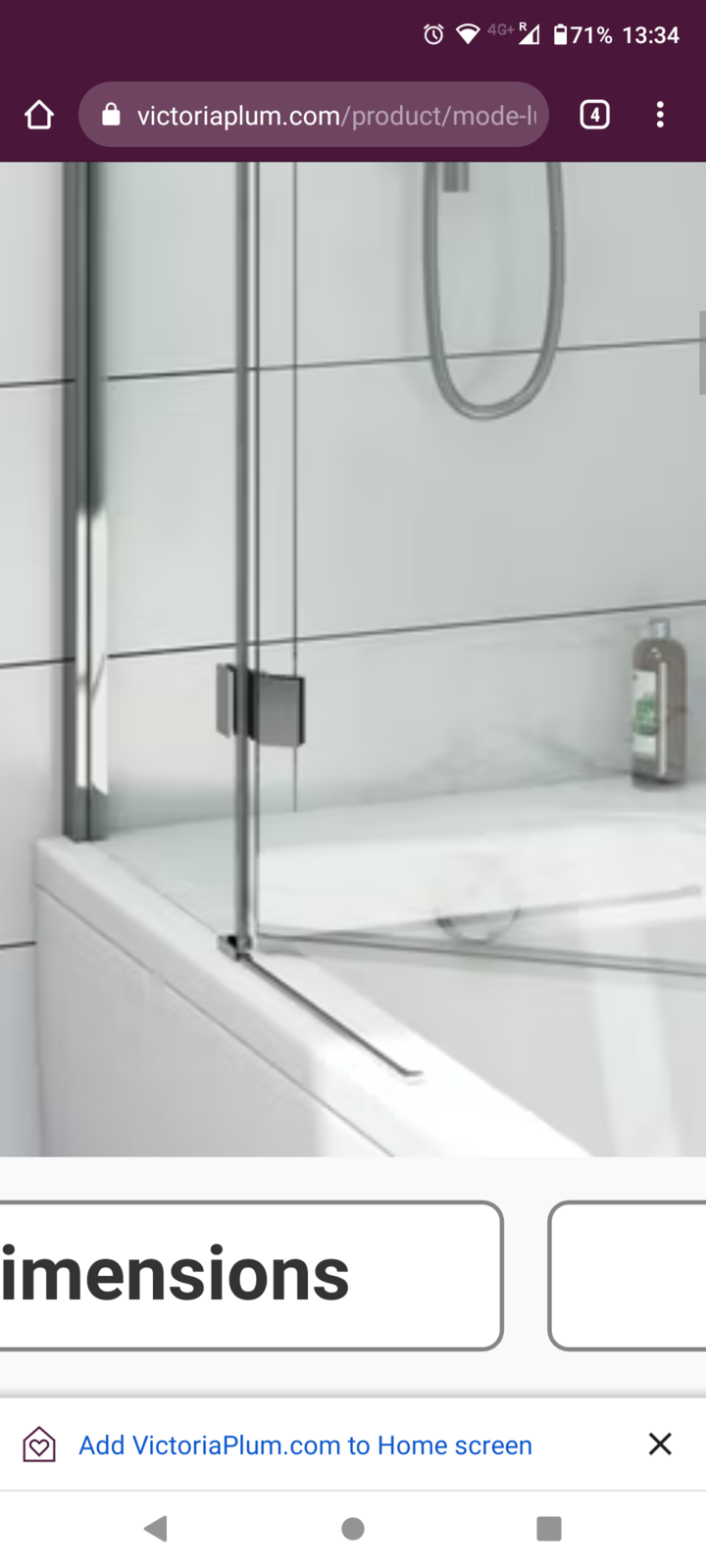

Never used one of these before and the first time using it the screen had swinged opened a bit and managed to splash water on the floor for 20-30secs.
There is an ever so slight gap when the screen is in position but if it's held it place it seems to stop the water, so probably needs a slight adjustment.
However it does seem a bit naff, especially as when you open the shower screen the water that was settling on the edge of the bath will run down the outside of the bath.
I am getting some vinyl fitted very soon and will obviously seal around the bottom of the panel, should I also seal at the top of the panel where there is a small gap? And should I try removing the panel and get the fitter to go underneath with the vinyl? Vinyl is 3mm thick but the panel is quite close to the floor.
Just paranoid about water collecting underneath the bath now!
The top of the panel normally rises up above the lip of the bath so water shouldn't be able to enter there, if you fit a batten on the floor just behind the bath panel you can get the fitter to fit the vinyl so it rises up a little against the batten. There may already be a batten there that the bottom of the panel screws into.
check ebay for deeper or twin lipped seals.
The ones that come with the screens are usually single edge seals that just about contact the bath when the screen is in position. cheap and nasty most of them, unless you pay through the nose.
Thanks for the all the advice, the current seal is a twin, but as said there is a slight gap (screen just a touch too high)
At the moment I have pulled the seal down a bit to close the gap but I will try and find a slightly deeper seal

I have a hinged two panel that isn't too bad. The first panel is fixed with silicone and the second has a small stop that is fixed to the bath edge as a secondary seal.
