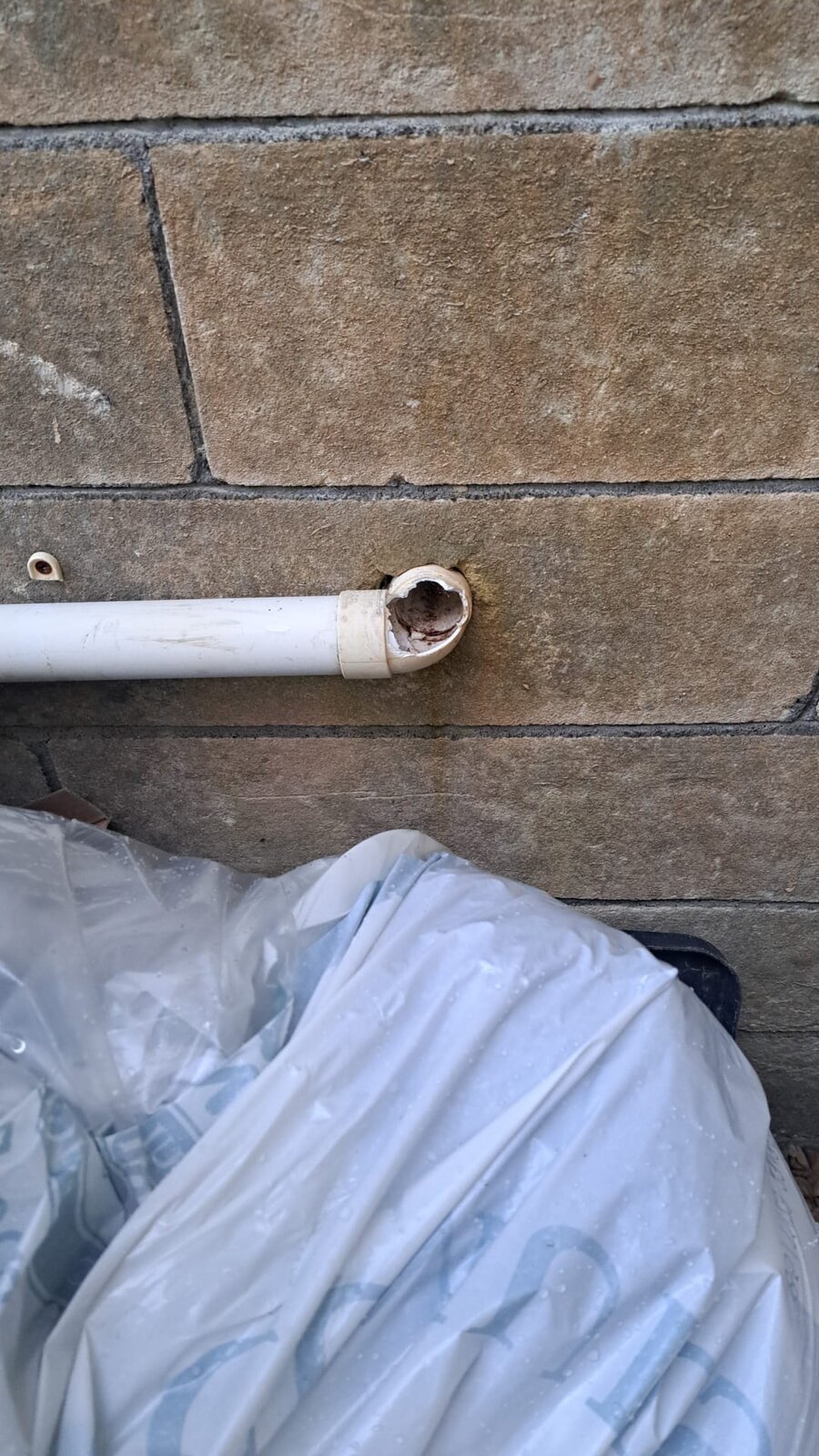

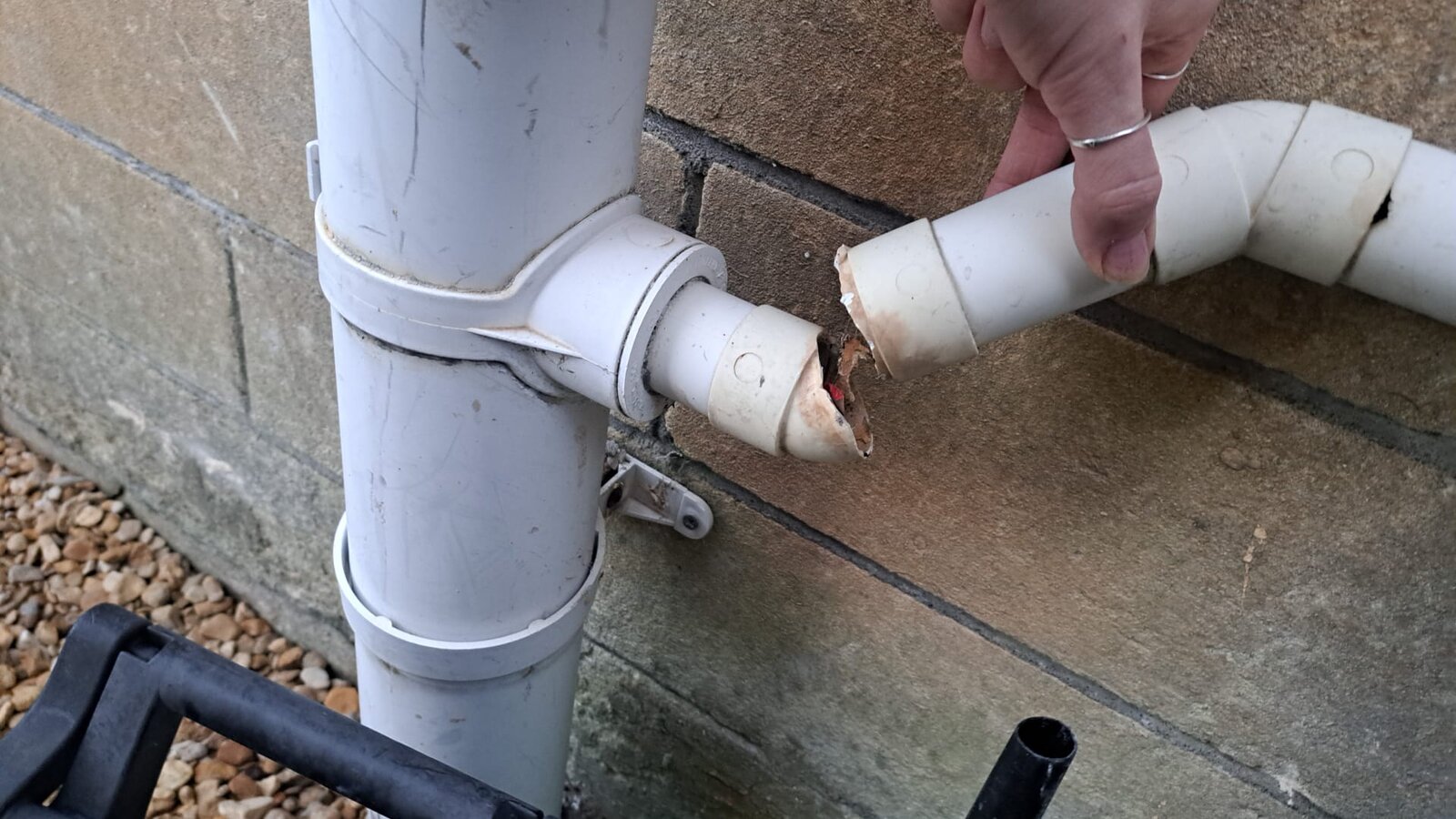

Just seen this pipe to side of house!! Could this be related to the hot water/boiler?! It's been broken by the building materials that were propped here during the build. Thank you
Nope, it just means you have condensate running all over the place, wouldn't affect the boiler really as long as the condensate doesn't back up
Is the boiler on the other side of that wall ,the pipe that's broken may be from a basin ,what is on the inside wall , in the vicinity of the broken pipe ?
