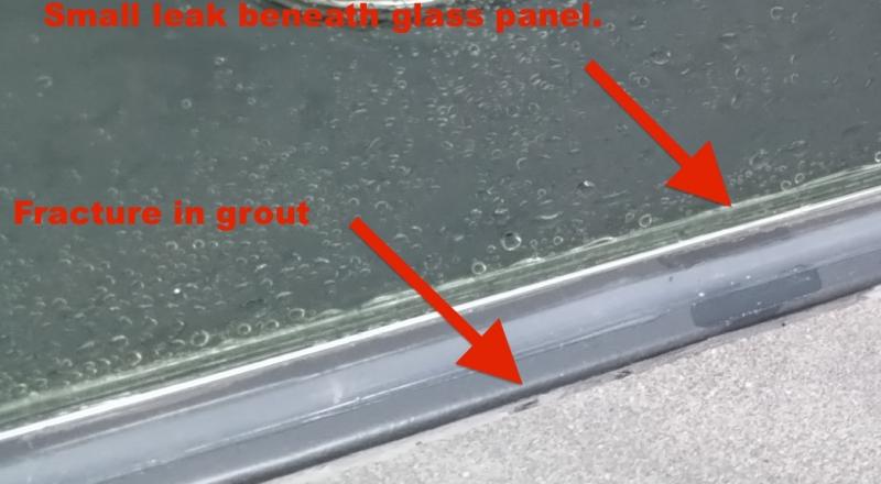

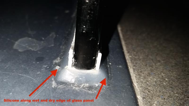

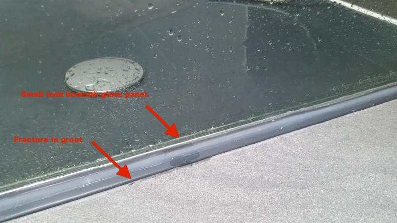

Dear All,
I've had a shower tray and glass panel installed. The panel is siliconed to the shower tray and the floor tiles are grouted up to the tray.
On first use, I've noticed a minor leak beneath the panel. I'm also concerned about whether the grouting is up to the job as the edge of the tray in particular sees a small amount of surface water on each use.
Can anyone advise if a small leak beneath the glass is normal please and if not how I might resolve it? I would also be grateful for an opinion on the grouting.

I think it seeps underneath the horizontal metallic channel which the glass drops into. The glass is a Simpsons TEN by the way and the builder tells me there's gasket tape running along the inside floor of the channel. Given this is a new installation, I'm concerned that it might get worse over time, but I don't really want to 'nit pick'. Although I also don't want to end up removing the panel and re-siliconing myself in 6 months time...
What do you think about the grout? As the job has just finished this week, I could ask for a few areas to be re-grouted, as some areas around the shower tray appear to have crumbled away.
Regards
James.
You may have been better with a flexible (silicone) joint between the tray and tiles. Different materials tend to expand and contract differently & inflexible joints can get cracks.
Why not just run a bead of clear silicone round the glass so that water can't get into the channel?
Thanks for the suggestion Adam. Do you think an epoxy grout between the tray and tiles might offer that flexibility, or should I remove the grout and replace it with silicone? The tile-tray gap is fairly narrow (around 2mm) so it might be tricky.
