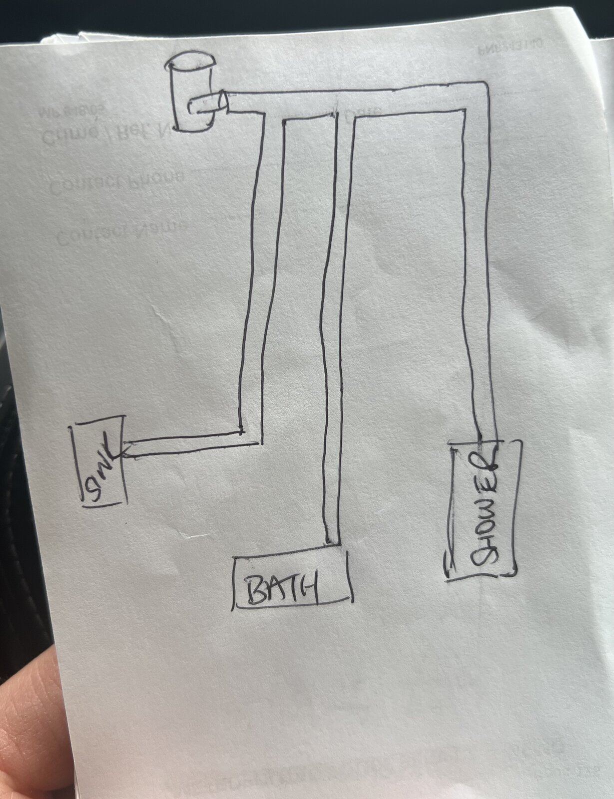

So this is a rough diagram of the setup with my original plan. The red lines are the joists (which can and do have holes in) I will probably have to reimagine it now so that they all run as far on their own pipe as possible. Thought I had all this worked out. But then that's what these forums are for right. For helpful people to share advice so thank you for that.

However I think it would be better to run each pipe further down... one sec... getting my pen out.
So would this be better if I can achieve it? I'm thinking 40mm from the utilities downwards and then the horizontal pipe going into the boss being 50mm. Would that work?
This way the holes in the joists will be further from the edge of the house which I'd prefer.

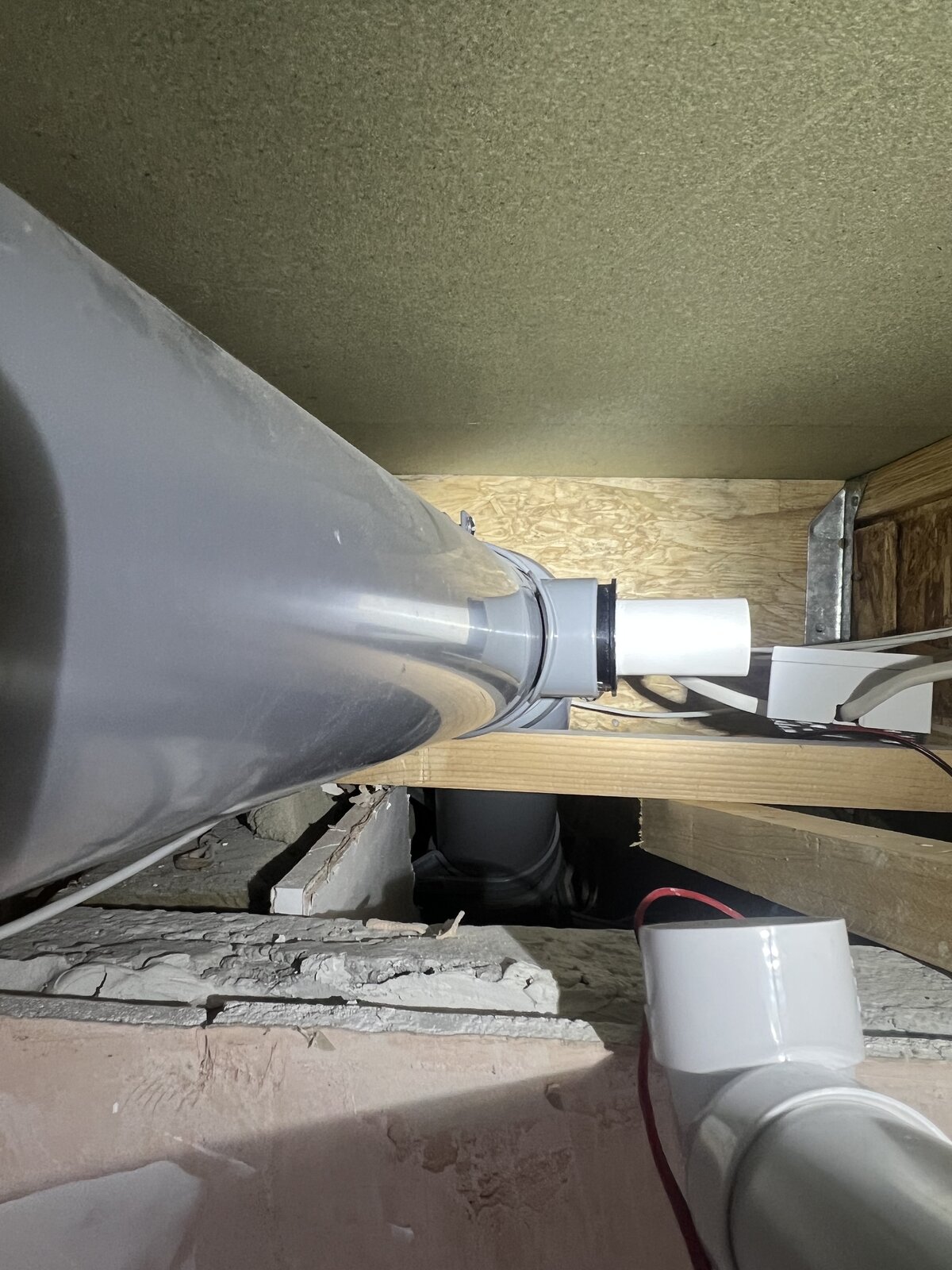

Ok so image 1 is what I put in for the upstairs toilet. I fitted a boss to run the upstairs services too. However it is only in the middle of the joists.

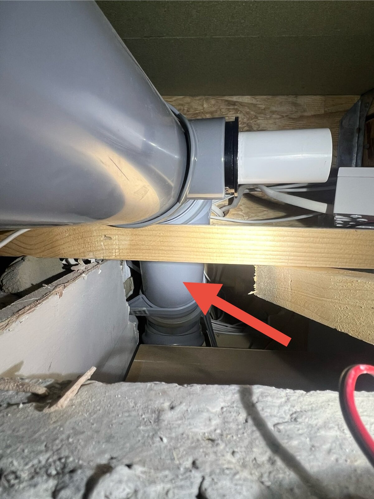

Image 2 is another position further along (2.5cm lower than the first, but also a bit further along so will need extra drop to get to) the strap boss isn't fitted and is only for testing, I have a solder weld boss to go in the final position
Image 3 is another possible position for the new boss and would give a greater fall, but again a bit further of a run.

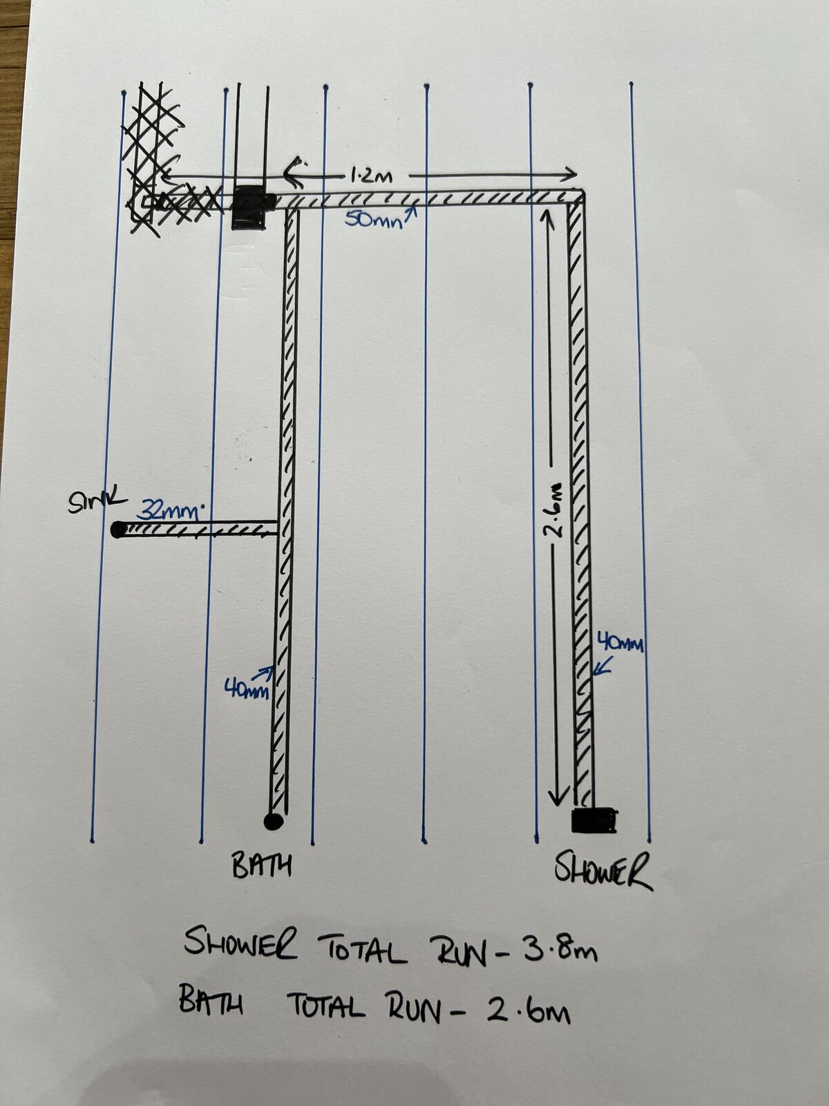

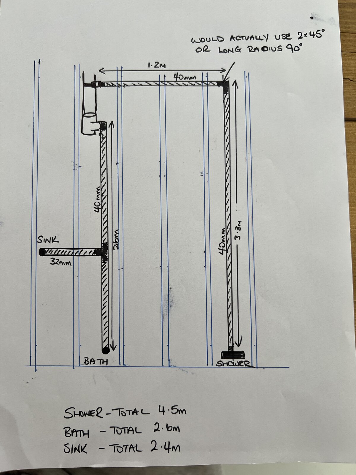

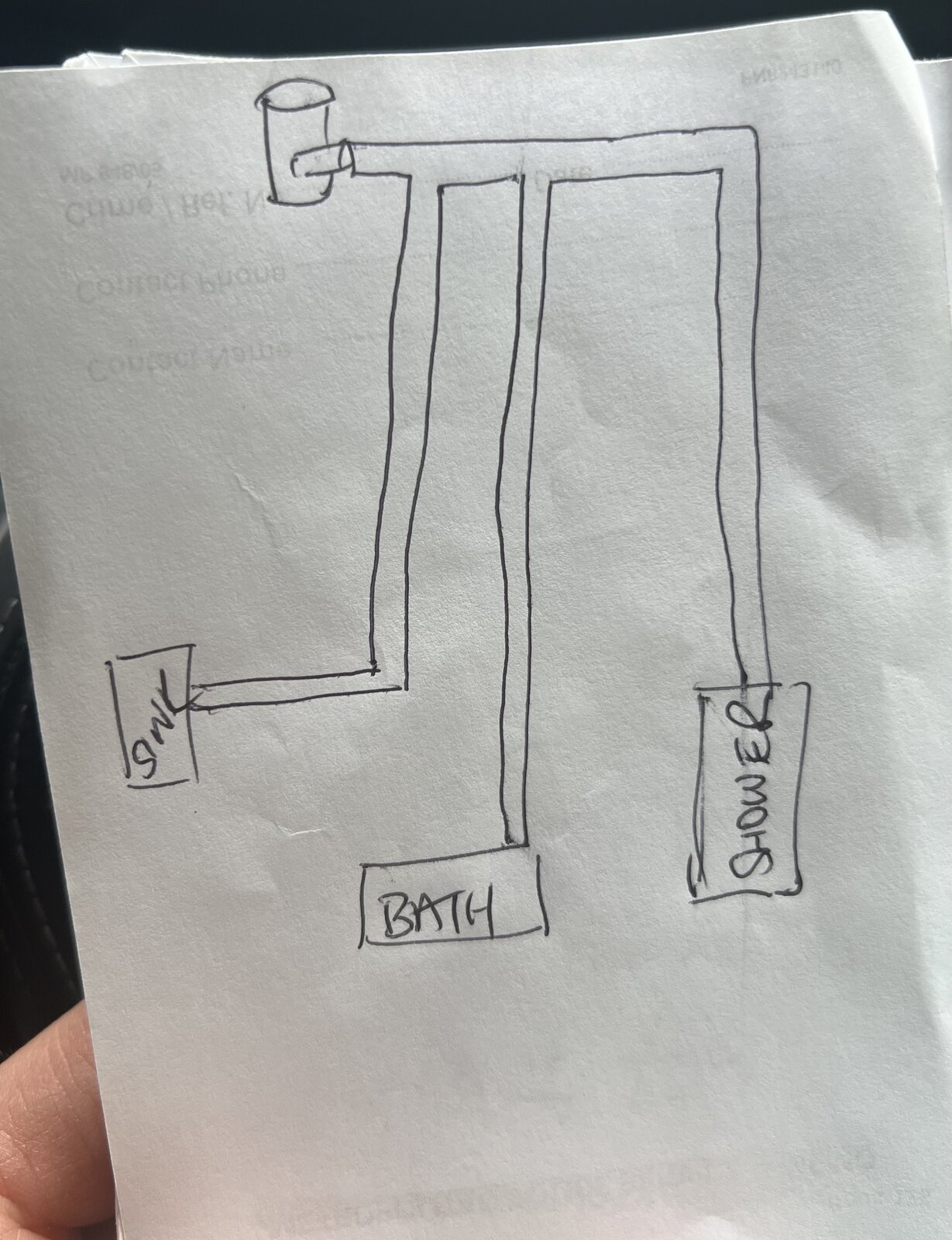

I'm going to draw out some examples of what in my mind might work and hopefully you can see what you think.

So do you think drawing 1 would be better?
yeah +1, as suggested - ideally on their own runs but certainly not shared with the bath, given the volume of water and the height difference.
If we're going by the regs then :-
Diag 1 shower run exceeds the max length by 1500mm. You could get away with it if it's upped to 50mm with a 45mm/m fall but even then, by the regs, it would be 500mm too long but I'm sure there wouldn't be an issue with the proper fall
Diag 2 does fall within the criteria but as suggested you really want to avoid having the shower on the same run as the bath. You could add another boss in just after the 1st one to take the shower on it's own, keeping the runs shorter.
diag 2 does fall within the criteria but as suggested you really want to avoid having the shower on the same run as the bath. You could add another boss in just after the 1st one to take the shower on it's own, keeping the runs shorter.
This is probably what I will do then. I'm off work Wednesday so going to measure and work out how much fall I can get away with.

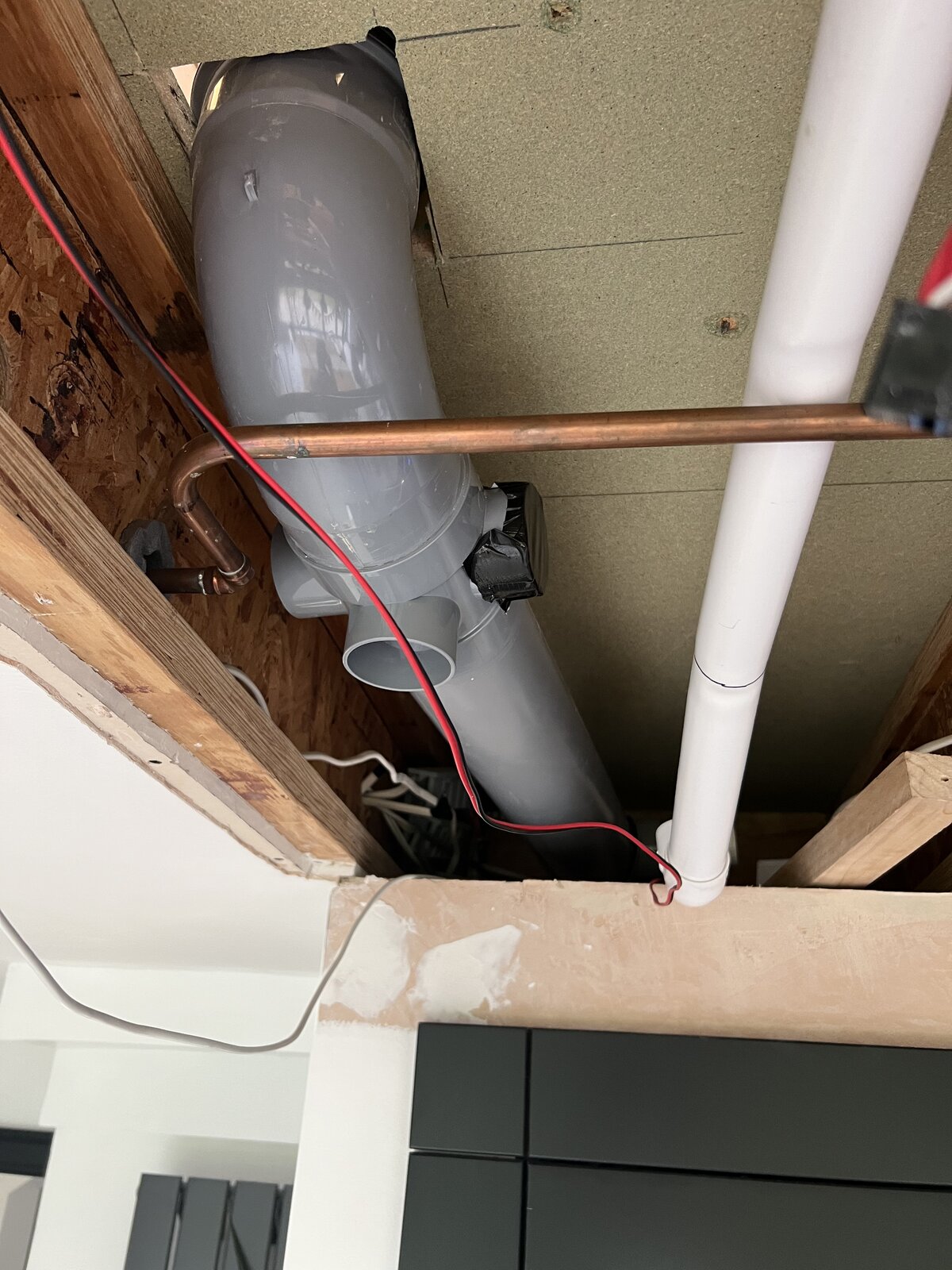

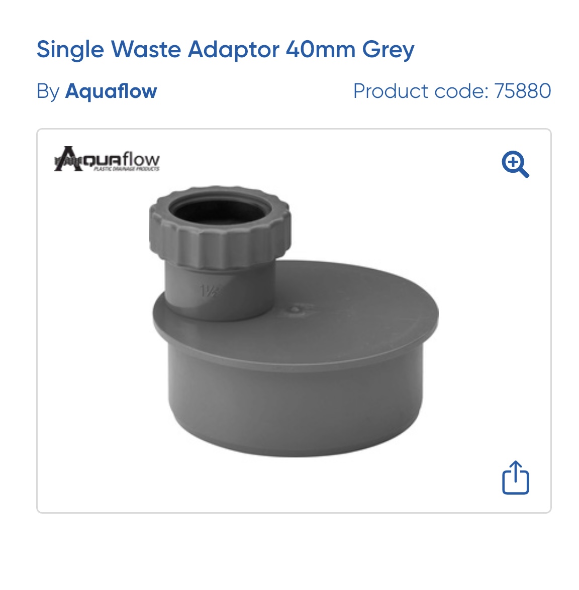

Orrrr... do you think it's worth replacing this upward elbow...
With one of these (obviously the sweep going up ready to connect to the toilet above)
And then one of these in the front end for the bath/sink run?
or I could probably get a double inlet one and run 40 from the sink and 40 from the bath independently.
The shower can then go onto the SW boss that's already on that pipe.
I really do appreciate your time and advice btw. Thank you.
Nope - I can see where you are coming from but that's primarily designed for a vertical stack, especially push fit.
Is the other soil/waste pipe and fittings Aquaflow from TS? I have found their sizes to be a little out for compatibility with the other standard pipe and fittings available especially their waste pipe and fittings.
