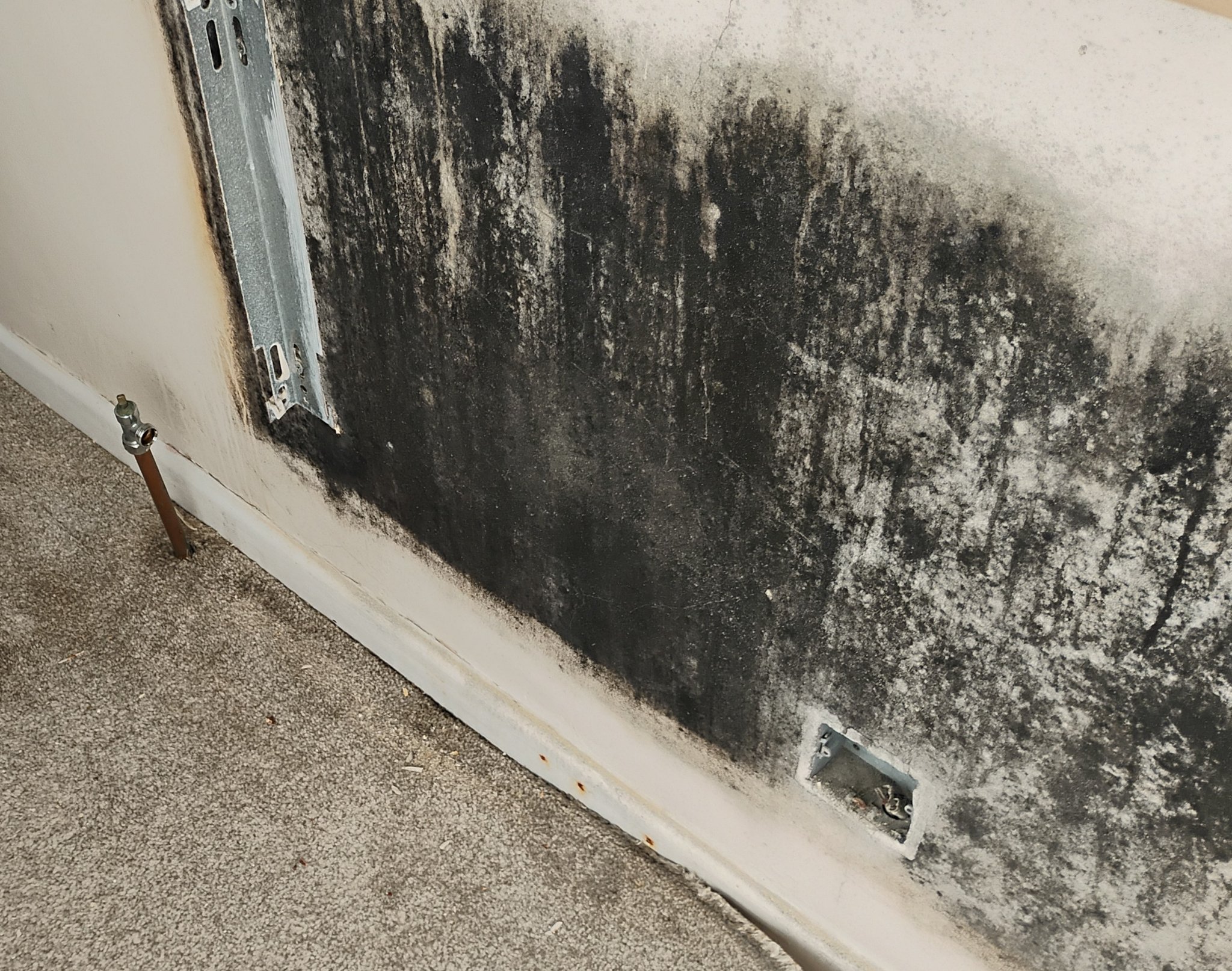

Sick of Mould behind radiator
The wall
So the radiator is a red herring then; it’s just a patch of cold wall.
What is the construction of the wall?
Cavity wall (not insulated)
I'm not so sure it's a red herring bevause the wall temp was measured with the rads off during various points of the days and thd entire wall showed a virtually identical/consisted temp. We do get the odd tiny bit of mould around the window reveals as well.

Have you worked out yet where the water is coming from?
The wall does not create it.
That's a most unusual and least expected place for condensation mould to occur. Lack of air-flow is part of the equation and conditions for a mould-growing environment, and the area behind a radiator is going to get not just a lot of air flow but be a very dry area too which condensation mould just won't grow in.

There isn't a radiator. He has removed it. I think he's talking about a patch of wall where a radiator used to be, though it's not very clear. See posts 10 and 11.
The thread title says "Sick of Mould behind radiator", and the pedantic me can't ignore that, or the poor and incorrect capitalisation.
Incorrect capitalisation is mildly infuriating. But give me grace because the mould is doing my head in.
To clarify. The rad was on the wall. Thick black mould was noted almost exclusively behind the radiator.
So whipped off the rad, removed and treated mould. Then have decorated the area, finishing with matt paint. .
However, I do this about once a year and I'm sick of it.
So i plan to try something new like insulation foil or egg shell (or silk) paint as suggested.
Have you considered insulating it?
I considered IWI but scrapped this idea as the works will be too disruptive. And we only really have the one problem area i.e. Behind the rad.
Not going to lie. This is the most likely culprit.
A damp towel over the rad will obviously stop the airflow. Get a radiator airer.
I'd like to see a picture of this unconventional phenomenon of a single patch of mould behind a radiator and reoccurring even after the radiator has been removed.
It's just not common or natural, and instead of looking for extravagant solutions, you may need to look at what you have done or are doing, or have not done or not done properly to this area to cause it or cause it to return.
It's a cavity wall, so cavity insulation is the obvious choice....
I'll never install this. Seen to many horror stories.
1. Mould was present when the rad was on the wall. As many posters have mentioned the likely cause is living habits/ draping towels on rad.
2. I specifically removed the rad to clean the mould and decorate the wall. The mould is not reappearing after mould removal. I have checked moisture levels and the temperature of the entire wall.
I've attached a pic immediately after removing the rad. Thick mould present on wall.
